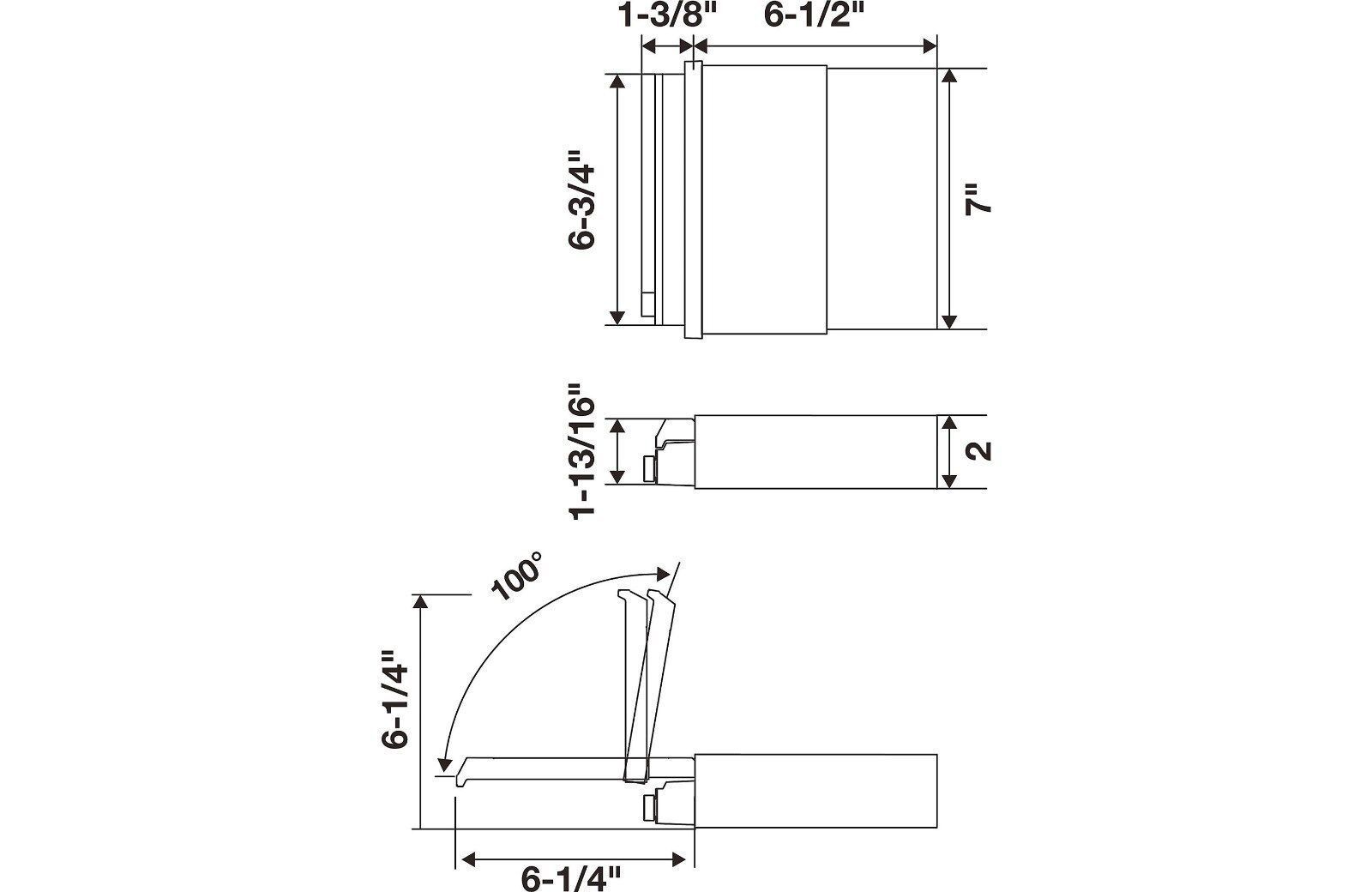

I am looking to replace the original cassette radio with this aftermarket unit,
I do not want to cut the car's radio wiring harness, so it would be easy to put the original radio back if needed. Here are my questions:

Pioneer AVH-3500NEX 1-Din 7-Inch Flip Out AV Receiver

No way that the screen can open/close with the transmission stick in park. There will not be enough clearance. If you need AC control access, good luck. I happen to have a trip computer, and that would be rendered useless by this screen....it is nice though.

A number of fitments by owners seem to show that you can't mount it flush and have to have it sticking out from the standard recess which looks rather messy. In that video of the Pioneer unit, it doesn't seem to be mounted flush? Also concerns about the angle of the screen, unless you mount the unit further forward.. And it will cover the trip computer when in use. Not sure about whether it might have clearance to open when in Park. See these threads:
https://www.jaguarforums.com/forum/x...al-fit-163470/
https://www.jaguarforums.com/forum/x...ndering-91652/
I'd really want to see a nice flush-mounted installation using the standard mounting brackets before I'd consider one.

I totally agree. for this to be considered it has to:
  1. be a flush, clean mount. sticking out like those from the other thread look bad (to me).
  2. be able to open to a vertical, viewable angle and clear the shifter in park.
Once I get my car back I will do some measurements, but I am extremely doubtful. I'll also email the installed from the video and ask if that was flush mounted or if they used some needed spacer that push the unit out enough to function.

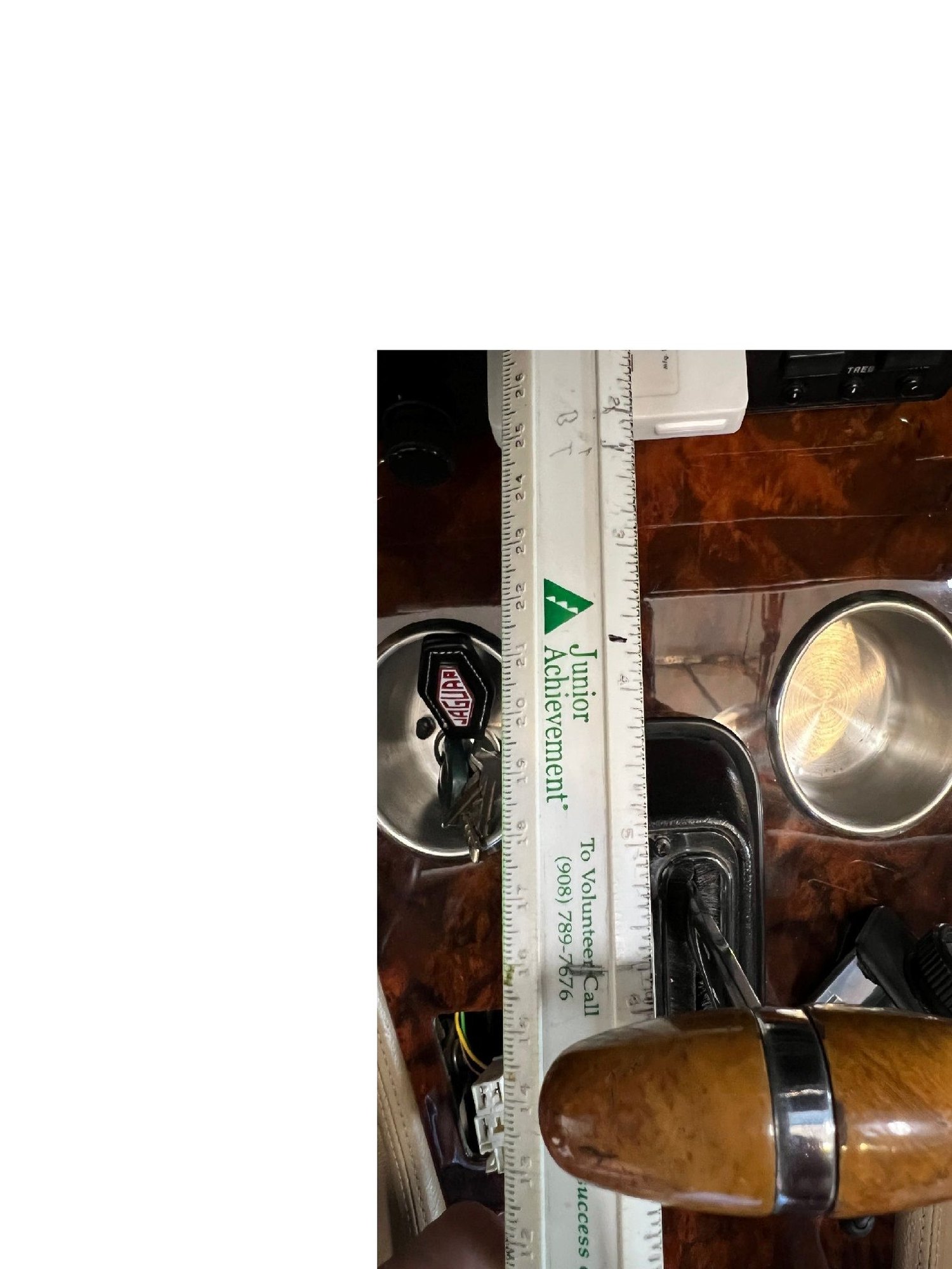

OK, I looked at the car and did some basic measurements. the video scree would not be able to open while that car is in park. It needs 6.25" and from what I see i'd only get about 5.25" a full inch short.
