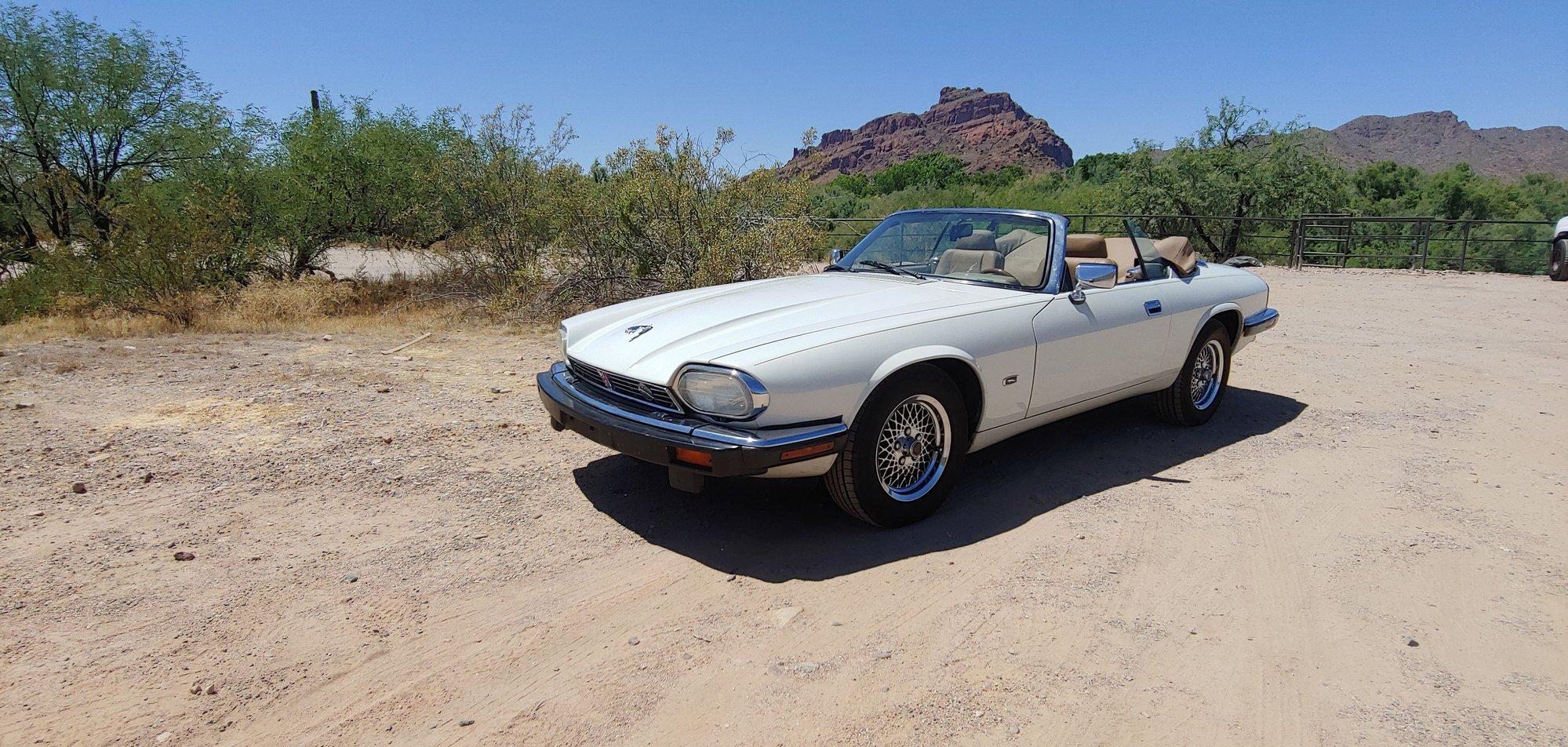

Ths Car is posted online as 1994 6.0 V12, but something doesn't look right? Comments?
Old Feb 13, 2021 | 10:09 PM
Doug's Avatar
Posts: 25,538
Likes: 11,735
From: Pacific Northwest USA
Looks like a 1991-older to my eyes
DD
Old Feb 13, 2021 | 11:13 PM
Jagboi64's Avatar
Joined: Jan 2013
Posts: 5,253
Likes: 3,515
From: Calgary, Canada
A 94 would have the colour keyed wrap around bumpers and body colour mirrors. Canadian /USA 6.0 cars also had a trunk mounted spoiler. As Doug says, this is an older car, likely a 5.3.

It was built before May 1993

The Model Year system can be a bit confusing at first. The vehicle currently on sale on January 1st determines the Model Year, so at some point before that the manufacturer stops production, makes a bunch of changes, and starts production again. Everything made after that point will be the next Model Year, even if its made in the same year. My car, for instance, is a 1987 Model Year. It has an August 1986 build date. They made some changes, probably in July '86, then started churning out '87s through the next summer, when they started making '88s. And so on.
As for the car OP posted, it could be a '94. The sides look right, the wheels look right, the emblem on the fender is right. The headlights and bumper are wrong. Its possible someone changed the headlights and bumper to the older style. Hard saying not knowing. If we could see the rear lights, engine, interior, or VIN, we'll be able to sort it out.

Default side and rear pics. no VIN available at this time

It's a 2-seater not a 2+2. Strangely doesn't SEEM to have 4-spoke steering wheel, although has 5-spoke wheels? Everything points to it being a pre-May 93 car, rather than a later car with retro-fit earlier bumpers.

Was it smacked in the front? Hood (bonnet) seems a different colour from the rest in the first photo...maybe rebuilt with the older hood and grill? That IS a V12 hood--no bulge. So a 6.0.

A lot of sun damage to the clearcoat on the bonnet/hood plus 2 sets of holes for a growler and leaper. I would say bumpers are original fitting and the car was manufactured earlier than '94.
Good spot Greg. That bonnet has been changed.
So it SEEMS to be a 2-seater V12 5.3 built between March 91 and April 93, with a pre-91 bonnet, and post May 93 wheels!
Unless anyone knows differently!

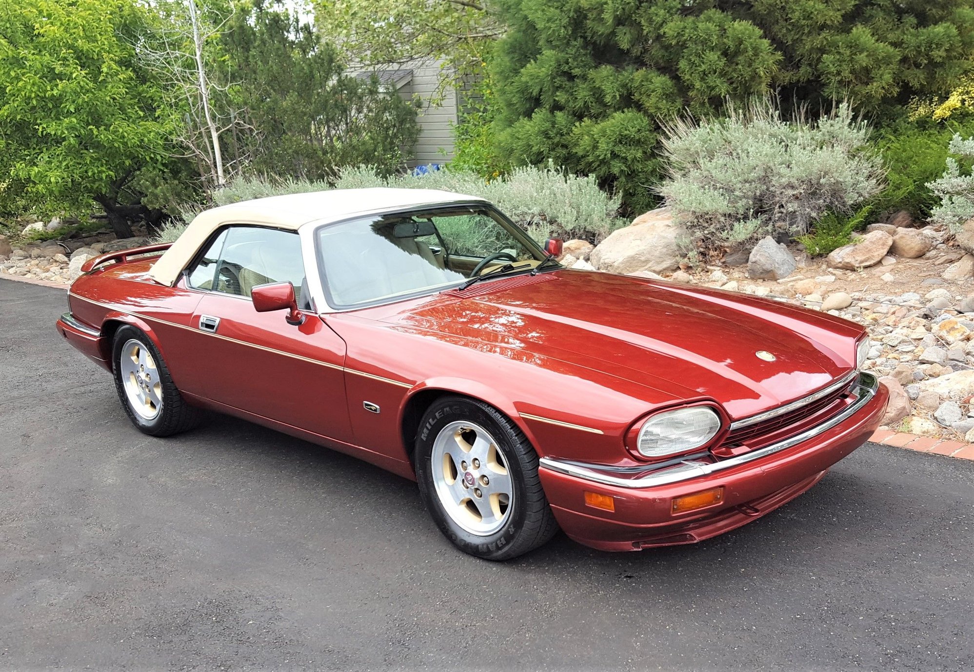

Default My late 92 with inboard brakes registered as a '93
As t h
Old Feb 15, 2021 | 07:38 PM
Some Day, Some Day's Avatar
Joined: Apr 2016
Posts: 2,047
Likes: 1,049
From: Japan
Also, the door handles are a dead giveaway. Only the early facelifts had the old-style ones. Compare to OP's late '92 with the flush handles.
Old Feb 15, 2021 | 07:51 PM
ralphwg's Avatar
Posts: 4,960
Likes: 1,241
From: Los Angeles CA
My 94 6.0L vert was built in Sep 93 and the last 6 numbers of the VIN are 190256. The bumpers and outside rear view mirrors are body colored. See picture.
