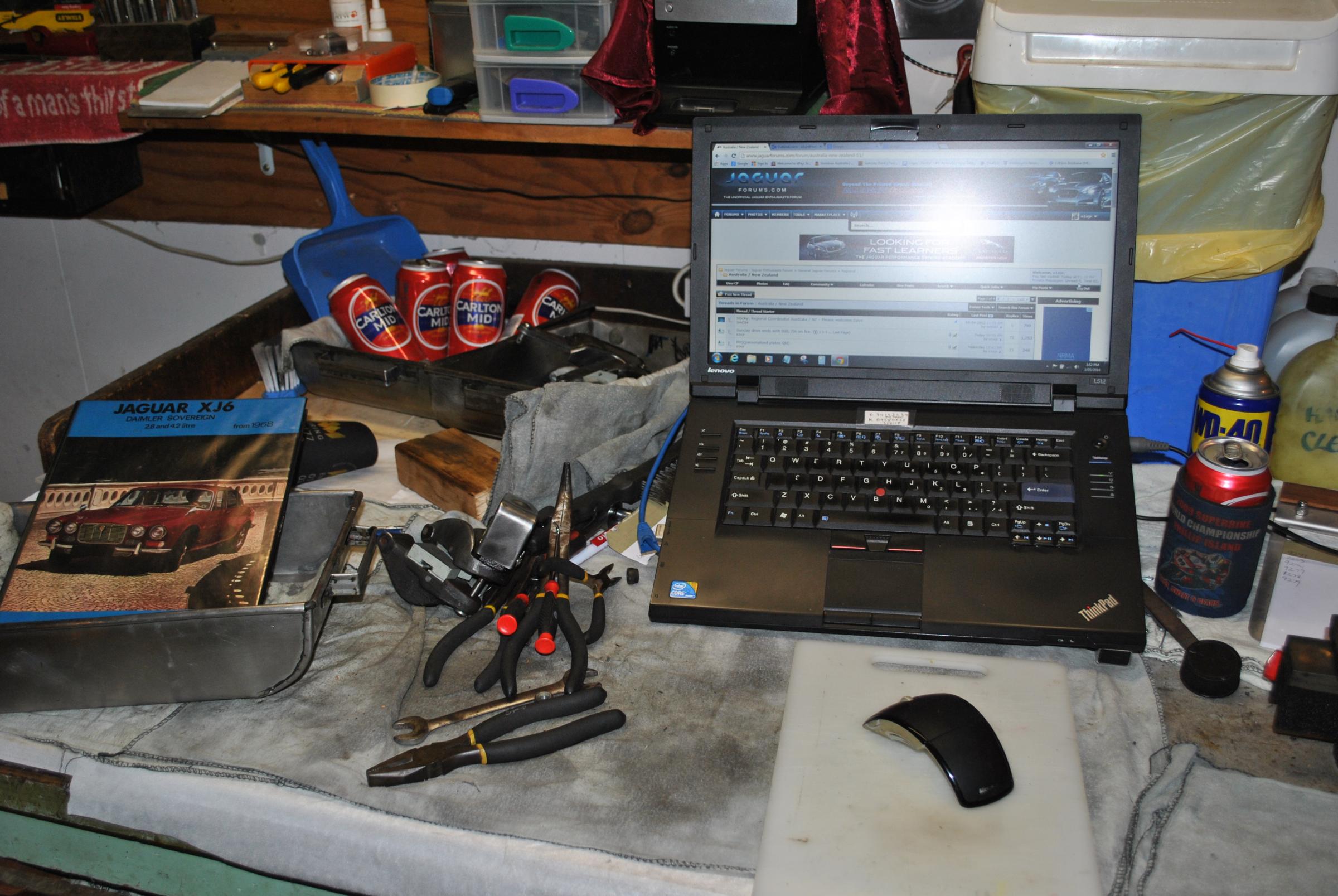

Cradle out was about 1.5 hours on my own(suggest moral support and an extra set of hands to pass said beer). Front on ramps, rear on stands.
Hardest part was over axle pipes rusted in place.
Then replace everything you can while it's out. And you need 3 hands to put it back, I managed with two but it's hard yakka.
Make sure you have, beer, book and JF open on your workbench if it is your first attempt. I reckon I could do it from memory second time around(with beer of course)
I now think the IRS cradle is the best invention as you take it out and fix everything the first time. No way you want to take it out just to fix a seal.
rear brakes??-dsc_9271.jpgrear brakes??-dsc_9274.jpgrear brakes??-dsc_9284.jpg
