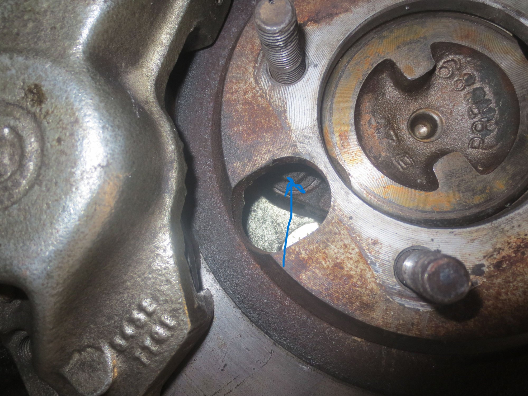

I needed to use the car on Monday, and I could not face a cage removal, so I though I would give it a go, axle cage in car. On a DANA diff car the caliper is undone from the outer side of the disc through a hole provided for the purpose. The hole provided by the manufacturers, including Jaguar OEM discs, is in the wrong place and not big enough. I had my mate "Louis, Roi Des Tours" (Louis the Lathe King) enlarge them for me some time ago when I did my diff and axle work (see thread "DANA differential Demystified).

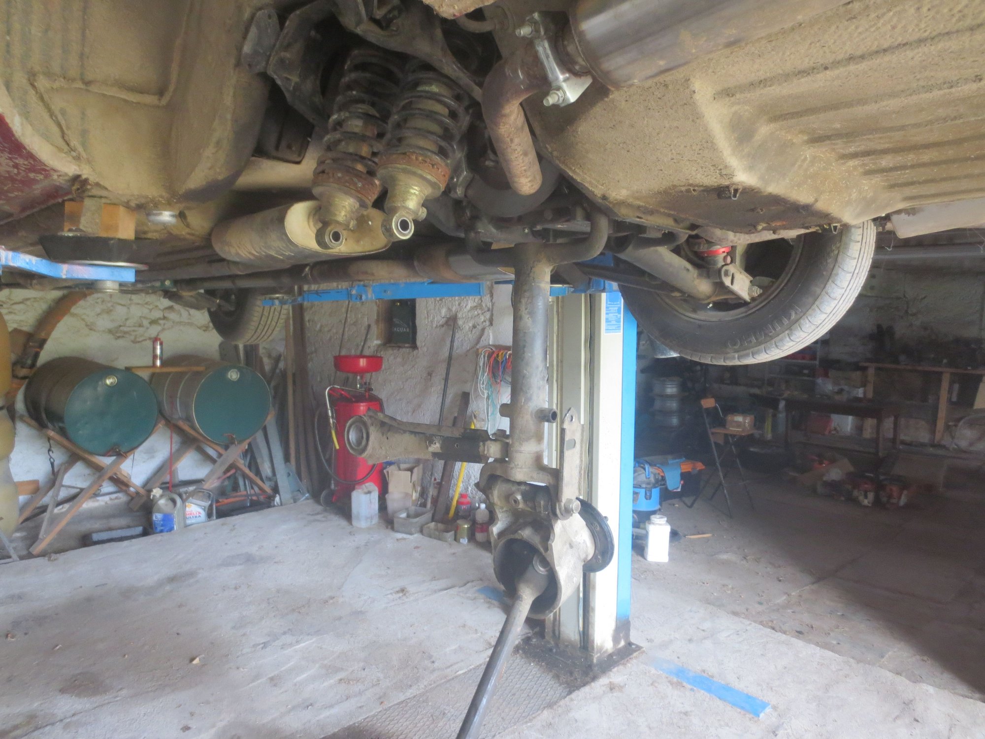

  4. shock absorber lower fixing pin undone and removed; this allowed the lower wishbone and driveshaft to hang downwards, allowing access to the disc. BUT see point 11 below

At this point the entire caliper and handbrake assembly is loose and the entire thing, disc and all, can be wriggled free. The caliper naturally drops down a bit and it was heavy on my ancient arms, but otherwise not hard to do. WHHOOPPEE.
Wishbone and driveshaft released
Caliper bolt visible through access hole in disc. Once the hole is aligned with the bolt it can be undone 5/8th A/F

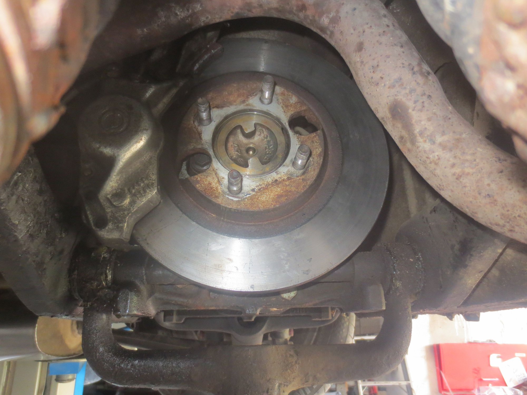

caliper exhaust and disc back on, ready for driveshaft

Disc on, caliper on, ready for driveshaft to be fitted
