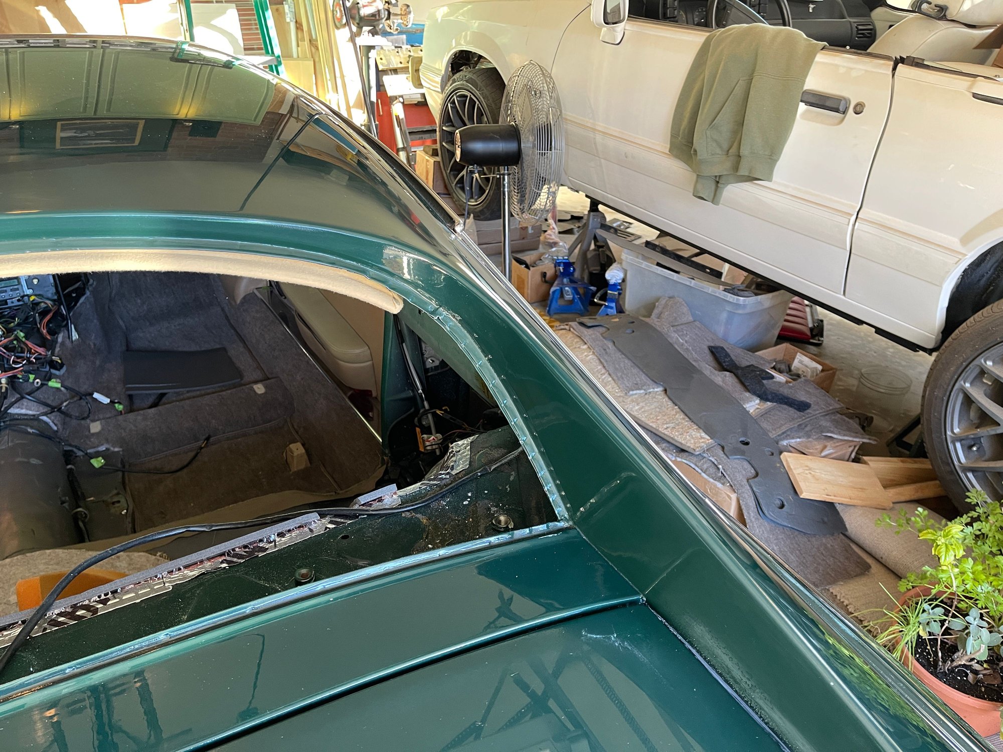

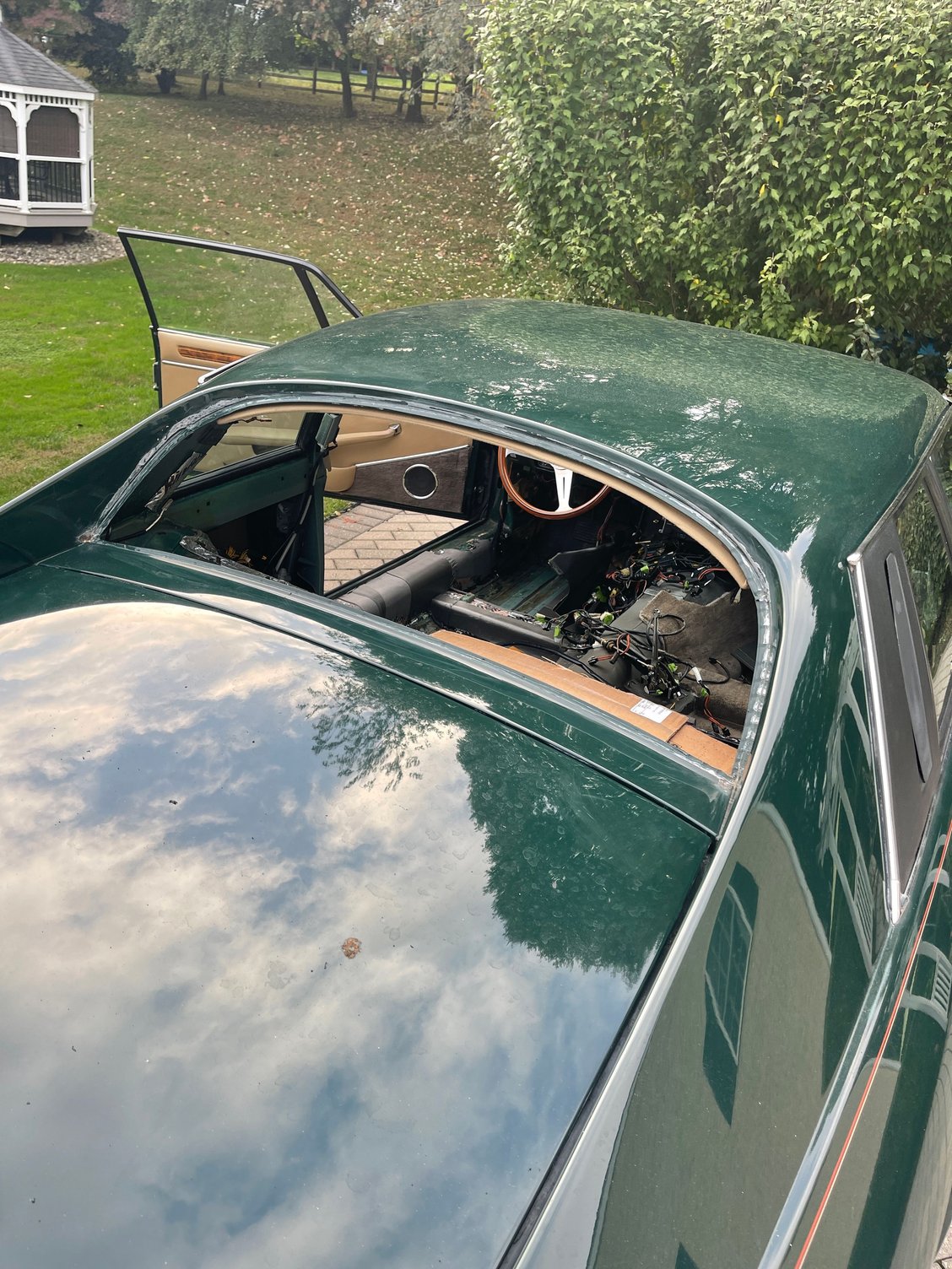

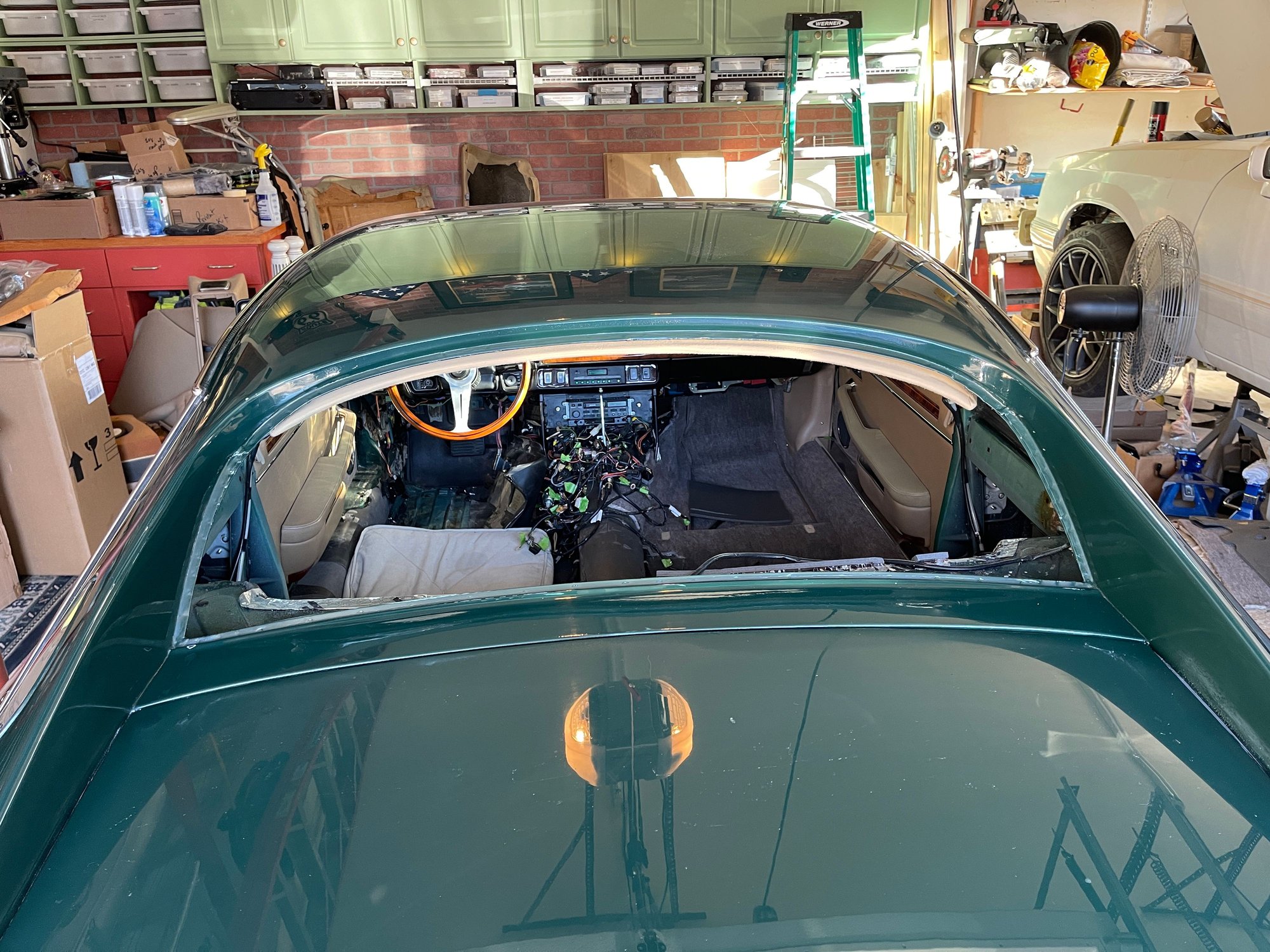

This was one of the first things I did o my XJS. I wanted to restore the interior but had to locate the source of a water leak before that. Not a real difficult job. Just time consuming. But then again, what part of working on a Jag isn’t time consuming?
*Sorry for the duplicate photo.
