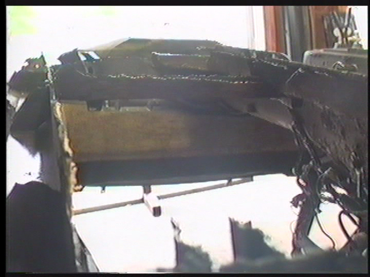

pic of my XJS cabrio modded from coupe to cabrio, by Aston Martin around 1980/82, ended up in USA and auction off to me!
then i start to find rust , BEYOND ANYTHING i ever seen,, NO floors or any metal from 6 inches up all the way around the car!
NON running , deliver backing down the flatbed truck ,used the hand brake , ripped the complete rear subframe loose from the body, twisted sidewise , locked wheels up against the body!
pic of Rotessori rig, nothing no metal!
SADD.

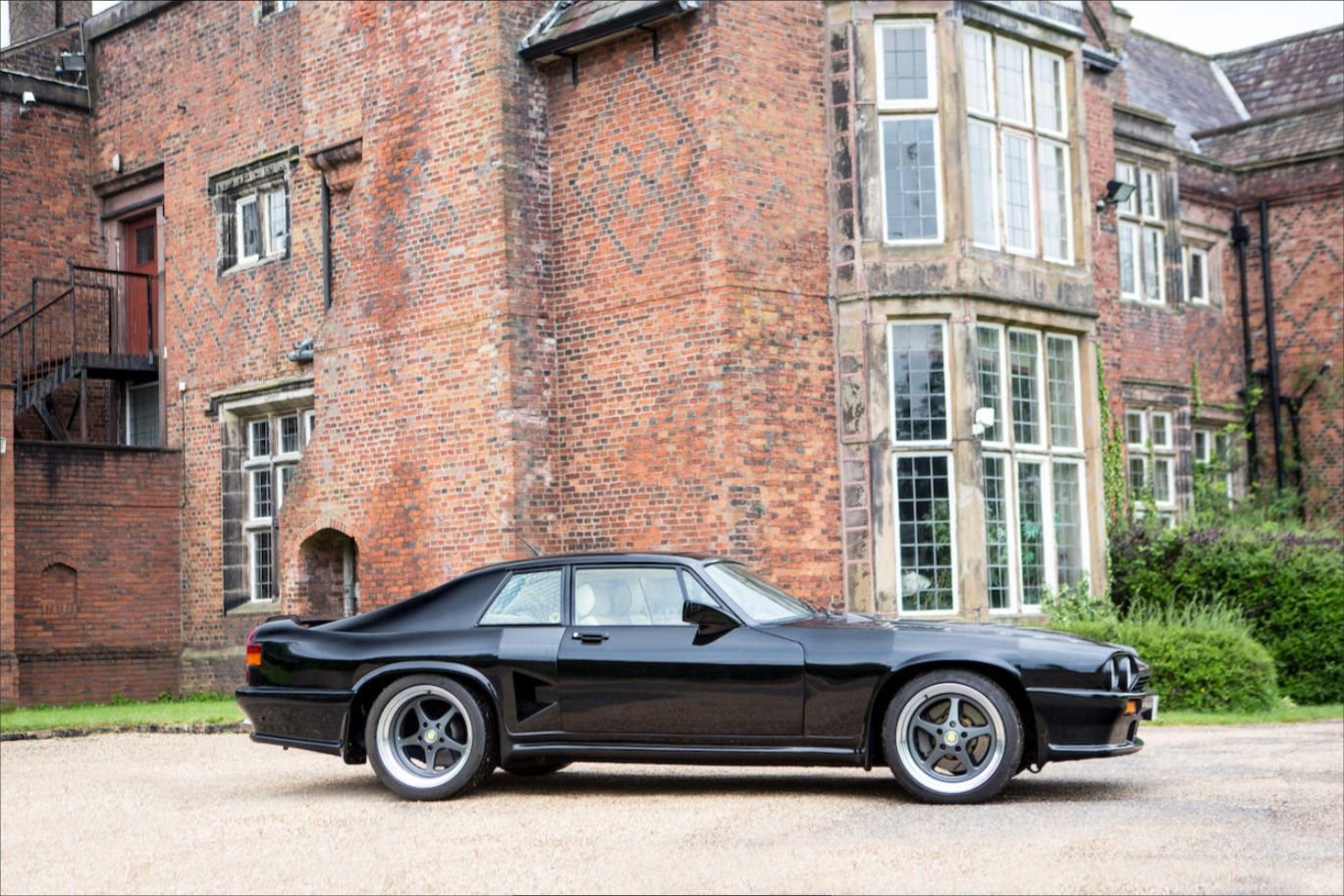

Also, that house in the first pic looks amazing.
Actually, the first house in the photos mine.............................................. .................................................. .................................................. .................................................. .................................................. .................................................. .................................................. .................................................. .................................................. .................................................. .................................................. .................................................. .................................................. .................................................. .................................................. .................................................. .................................................. .................................................. .................................................. .................................................. .................................................. .................................................. .................................................. .................................................. .................................................. .................................................. .................................................. .................................................. .................................................. .................................................. .................................................. .😂😂😂😂😂😂😂😂😂 yeh right.

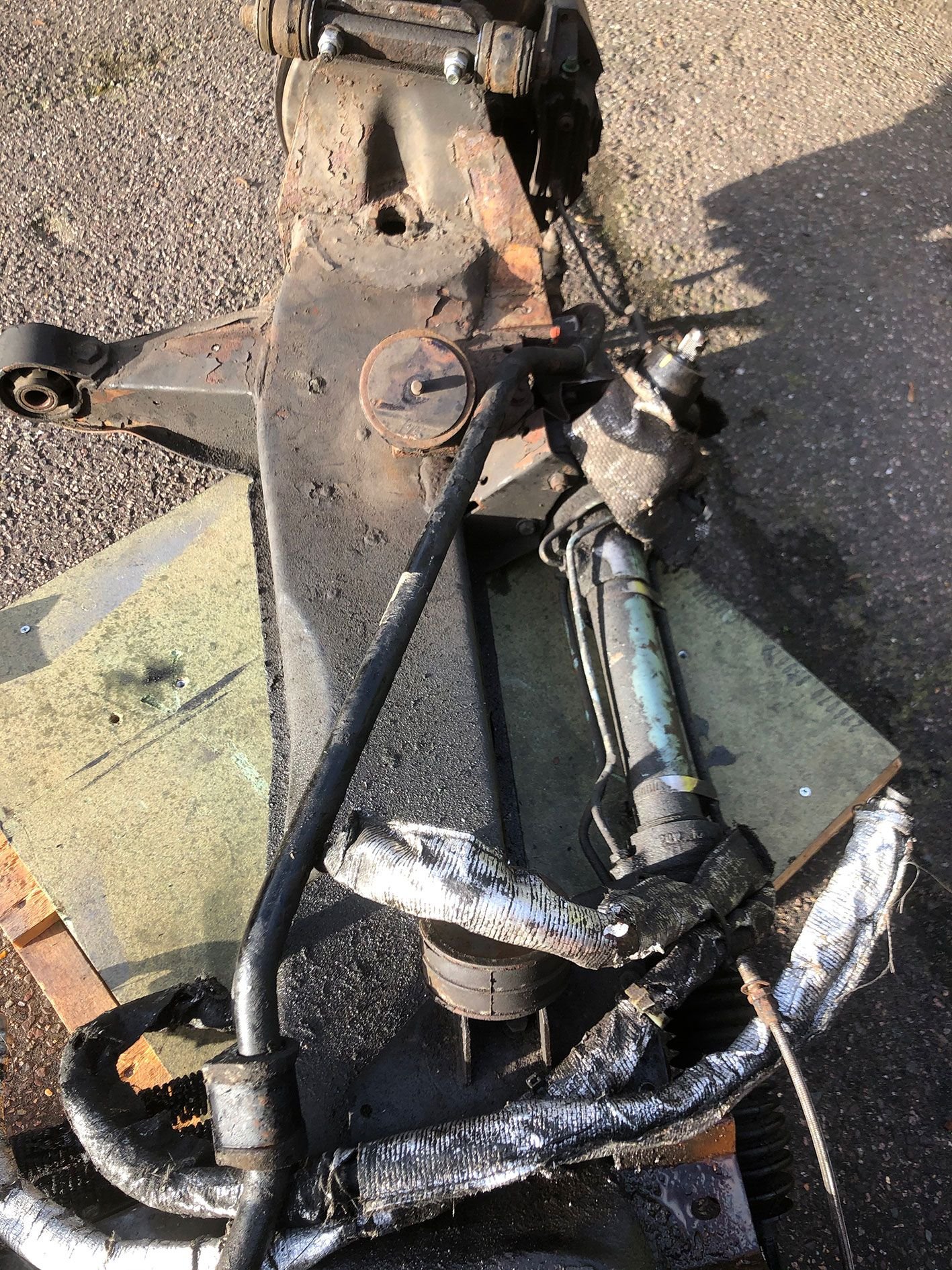

Engine already out and now bed on floor - complete with mostly shot to pieces suspension, one missing anti roll bar bush, one upper wishbone bush hanging out, two nearly departed ball joints and only one of four bump stops still there - ready for a rebuild and a good sort out.
Time to don the rubber gloves, get out the Swarfega cleaner and fill the bath!
Engine bed
Bizarrely the architecture of that house seems to be of exactly the same period as Wappenbury Hall, the home of Sir William Lyons, the founder of Jaguar!
Paul
That's just a coincidence. What you can't see is just to left of this picture there's a block of flats and a disused refuse dump. 🙄
