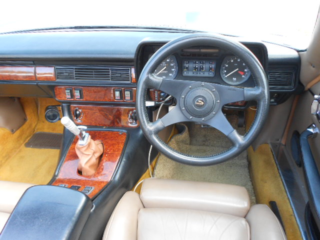

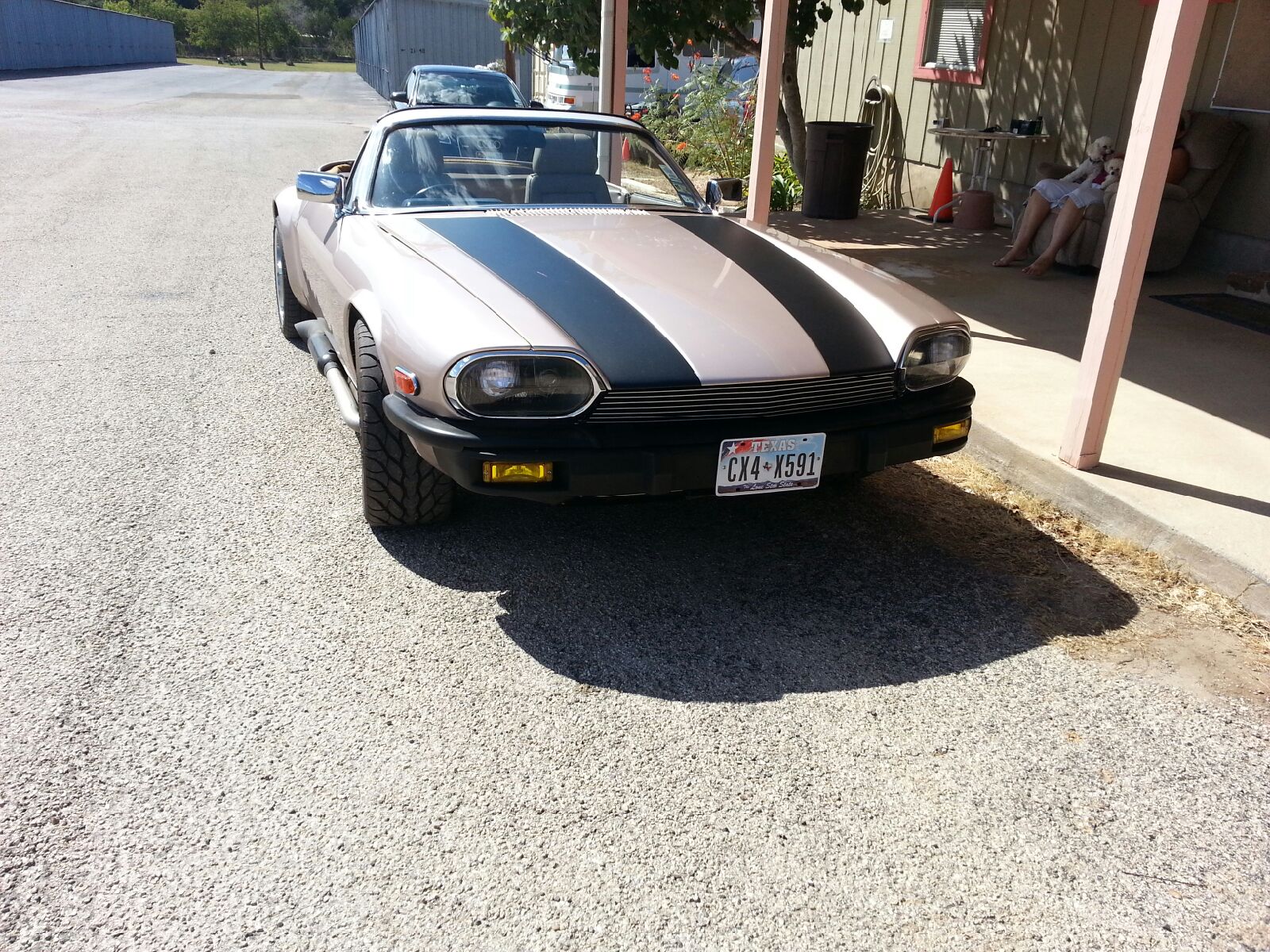

not really a restomod but far from stock !
gets alot of admirers when at shows or anyplace i park it!
has many mods mostly GM stuff, Corvette 4 speed trans. aluminum drivshaft ,GM HD joints GM/Jeep rear gears, and suspension mods
BMW seats , ENKIE alloy wheels ,295-18 KDWs. wide body flares steel, no fiber stuff, Wilwood brakes,.
most under hood electrics GM, alt.& starter, relays, custom fuel system(no rust).
notice RHD.

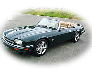

Actually, I'm the one who started this thread, yet after reading so many great posts with mods and improvements already achieved, plus many quite interesting ideas and suggestions, I haven’t shared what I’ve done to my own XJS. So, yeah, my XJS is far from stock, but I prefer better performance, plus the conveniences of later cars and the enhanced looks as opposed to having to be 100% stock. After all, those who have only updated the radio are not 100% stock either. No changes have been done that would alter this car's great XJS presence and stance. This, below, is my contribution to this “resto-mod” thread. They’re not just “ideas” but actually incorporated mods and I’ve divided them into three categories:
1. Convenience
2. Performance
3. Cosmetics/Appearance
=30 pictures follow below=

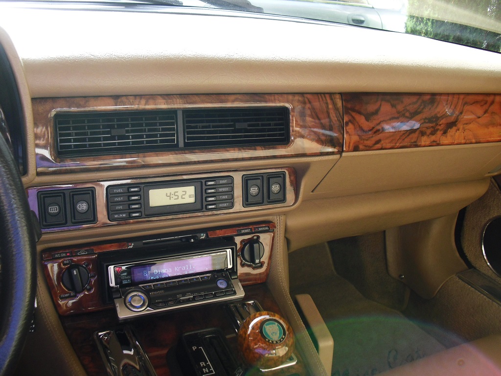

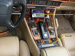

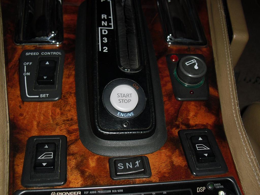

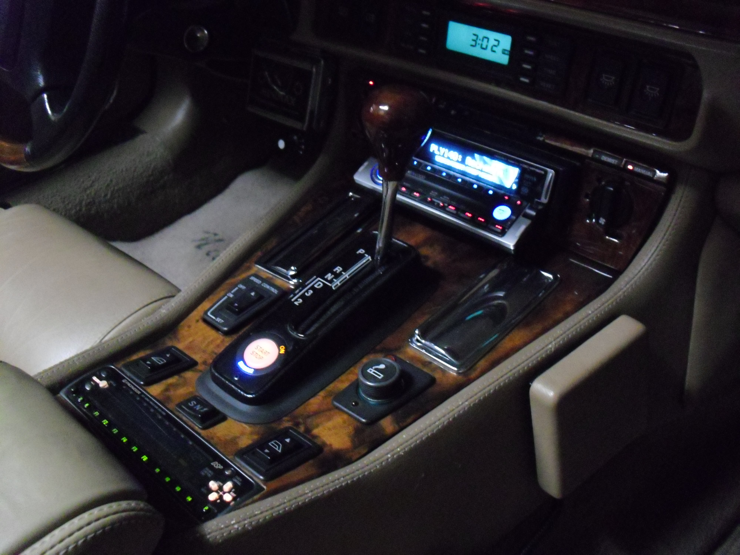

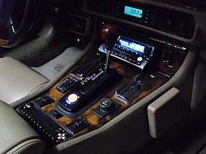

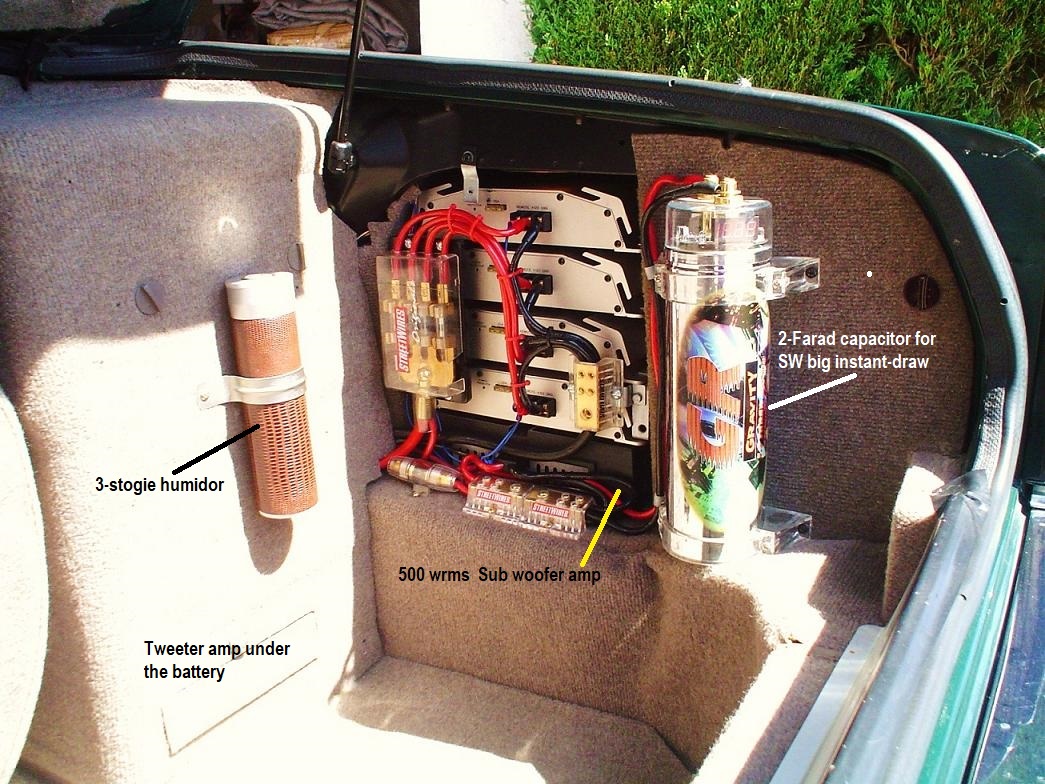

Engine start/stop button that interfaces with the car’s security features. Totally self contained; can still use OEM key.

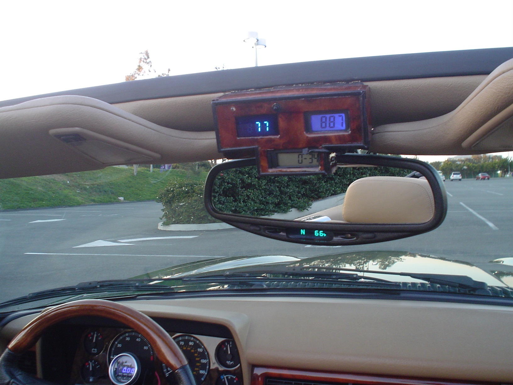

Electrochromic rearview mirror, similar to, but better than my XJR’s, as it adds digital outside temp/compass displays.

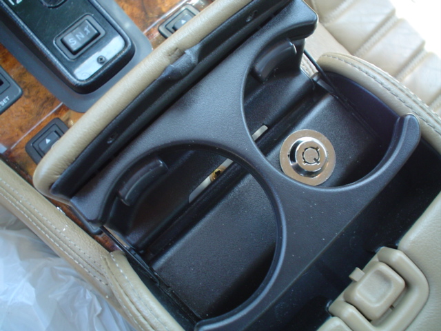

Cup holders and high security lock in the center console with enlarged storage capacity and two cup holders.

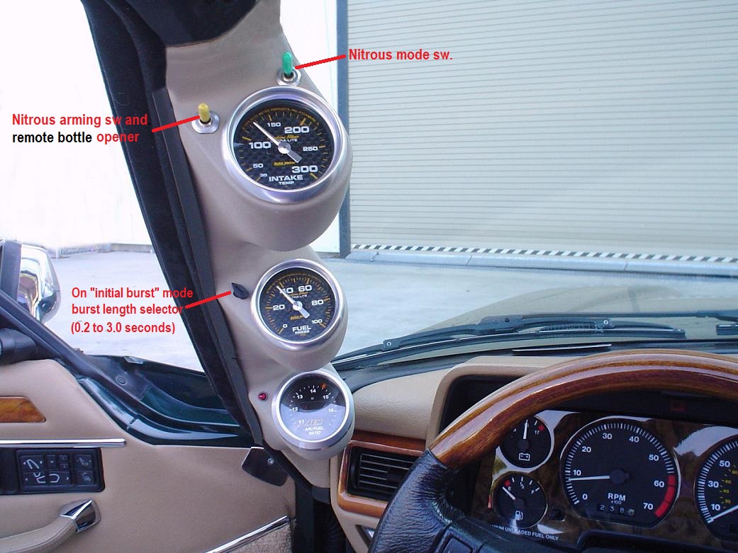

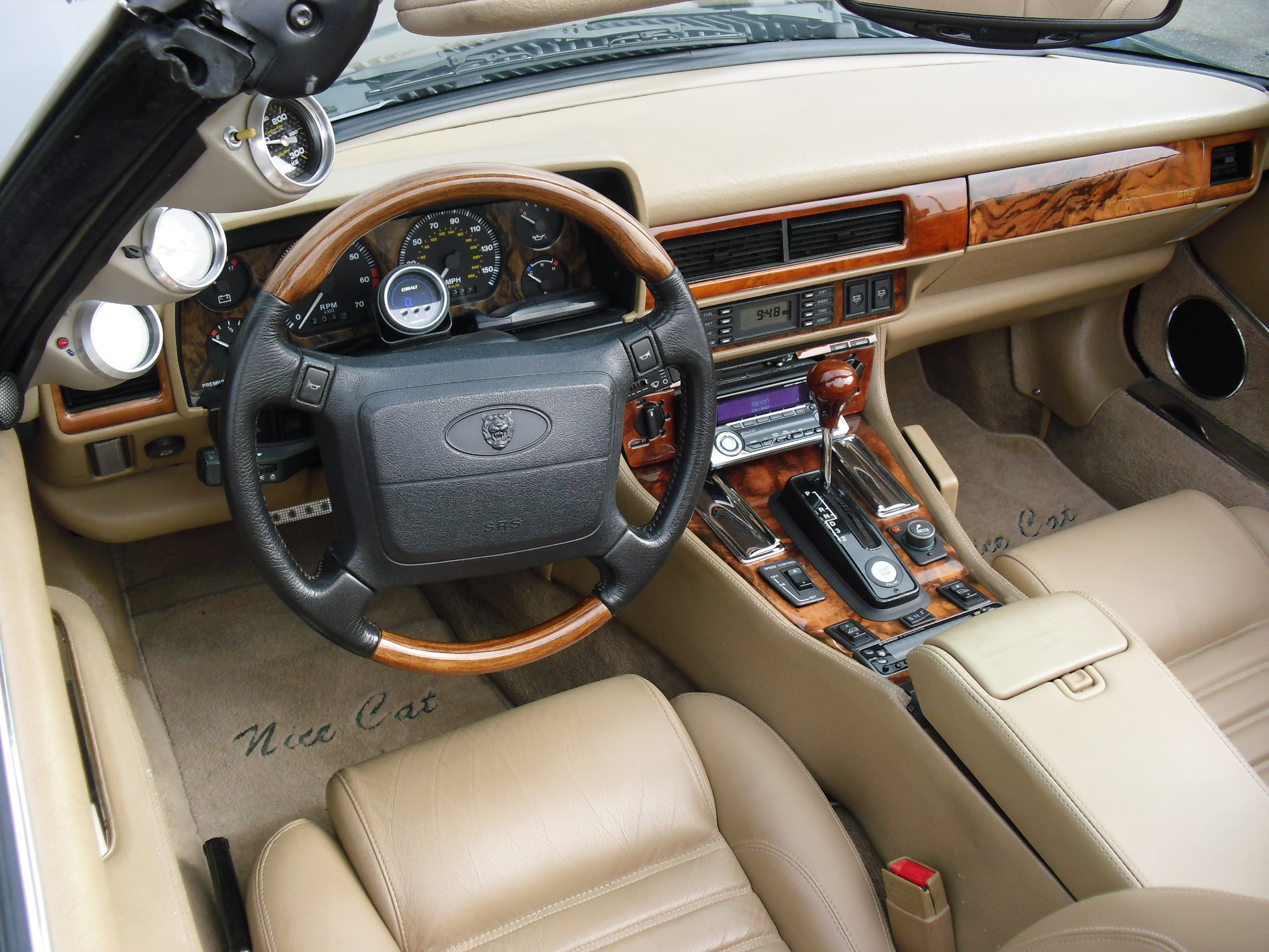

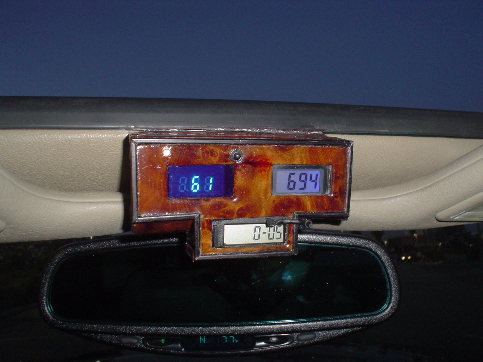

A-pillar pod with fuel pressure gauge, wide band air/fuel ratio gauge, incoming air tem ind, plus N2O controls & LED’s.
Special Hella fog lights. They look blue when OFF, but will turn ON amber.

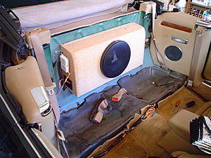

All new ICE system with Kenwood Excelon HU and a 40GB Kenwood Excelon “Phat Noise” MP3 Digital Music Storage hard drive (DMS). A Pioneer digital sound processor (DSP) integrated to the ski slope - Four 100wrms Sony amps feeding four 100wrms Infiniti mid-range drivers behind the stock grilles. A 500wrms Rockford Fosgate amp feeding a JL Audio subwoofer located inside the rear seat back cushion. A 50wrms amp feeding the 50wrms dedicated and perfectly aimed tweeters located at the door triangles.

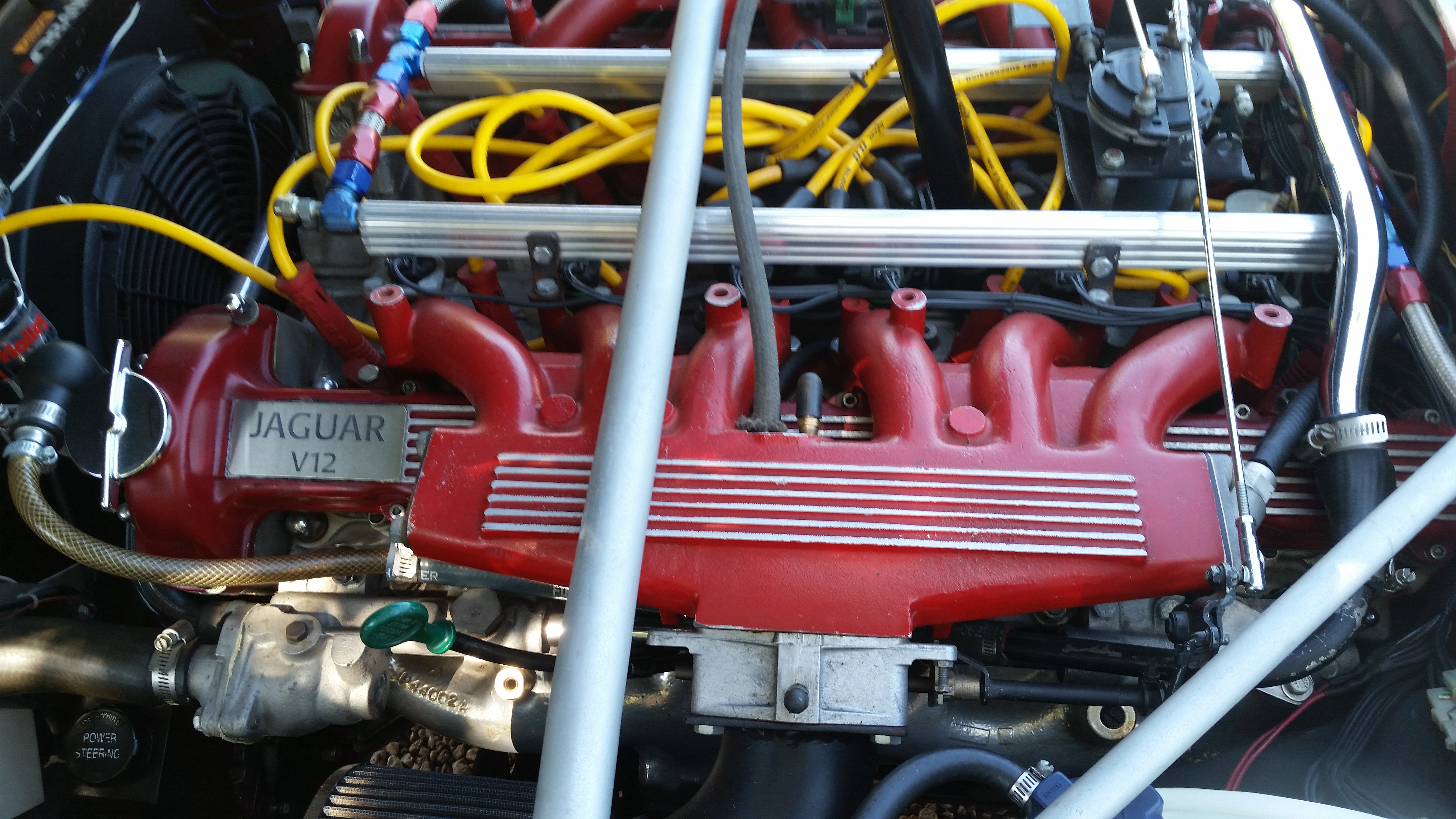

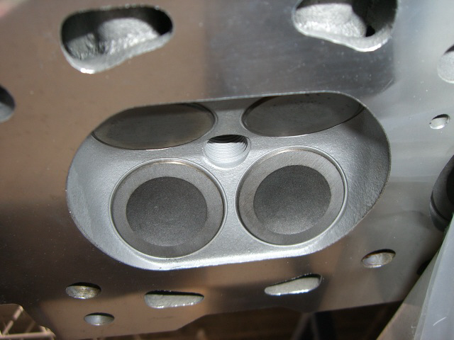

The head has been ported and polished and fully refurbished by a race shop at Las Vegas Speedway.

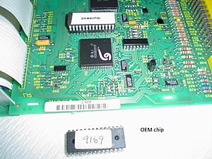

Performance Power Chip with re-programmed timing and fuel.

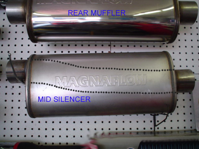

Optimized Magnaflow exhaust components: no-baffling mid-silencers and no baffling rear mufflers; 3” rear exhaust pipes end in Borla tips.

Special Auto Meter Performance monitor (accelerometer / timer).

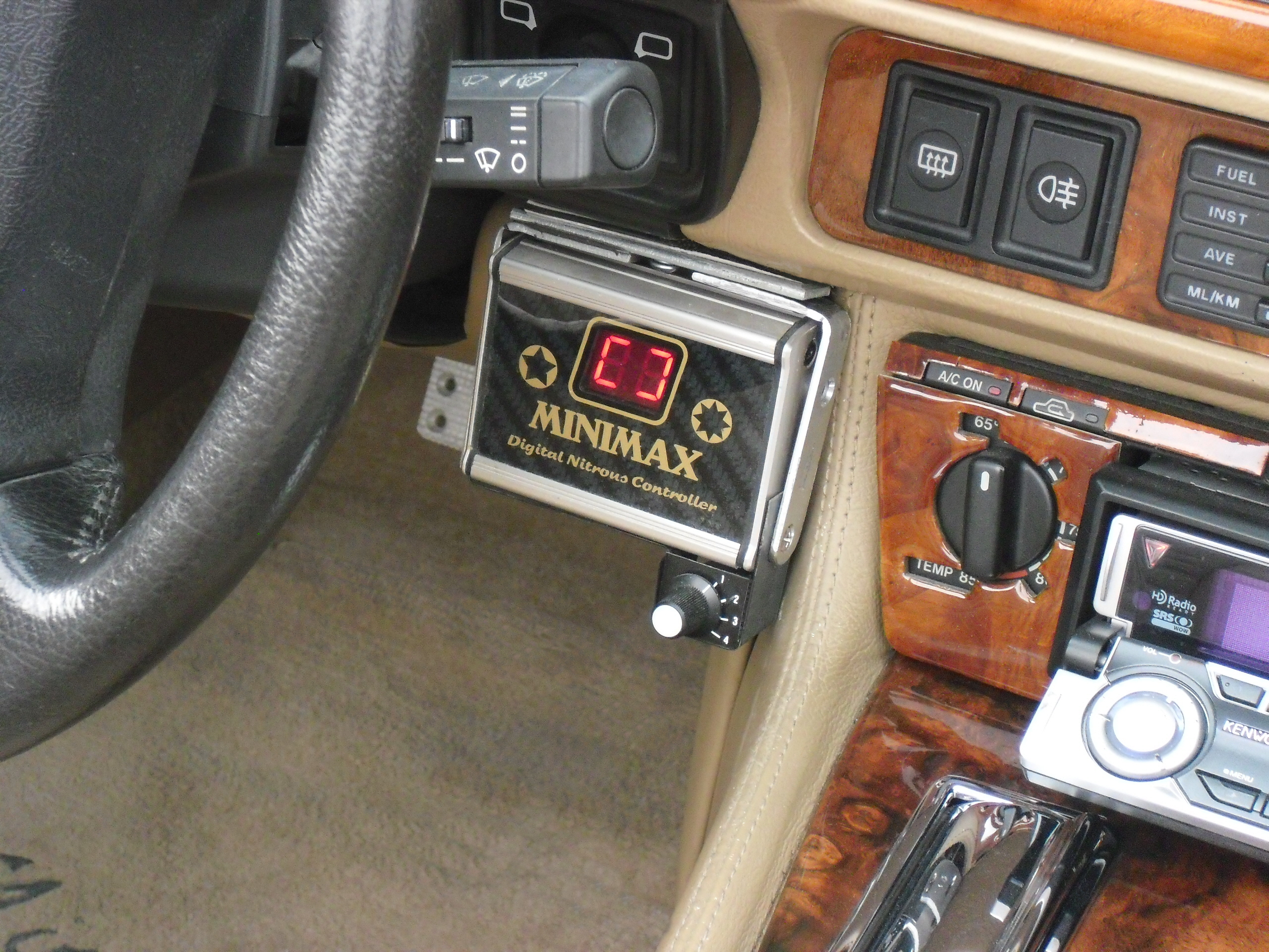

Nitrous injection system from the Wizards of Nos (UK) producing 130 HP over and above the stock 219 HP.
• "Minimax" Digital Nitrous Controller to shape the level and timing of injections and also to prevent skidding the tires while not going anywhere...

• Nitrous mini-overhead panel with digital indicators for N2O press, N2O temp and N2O-use/timer.

Convenience

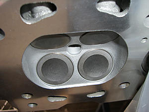

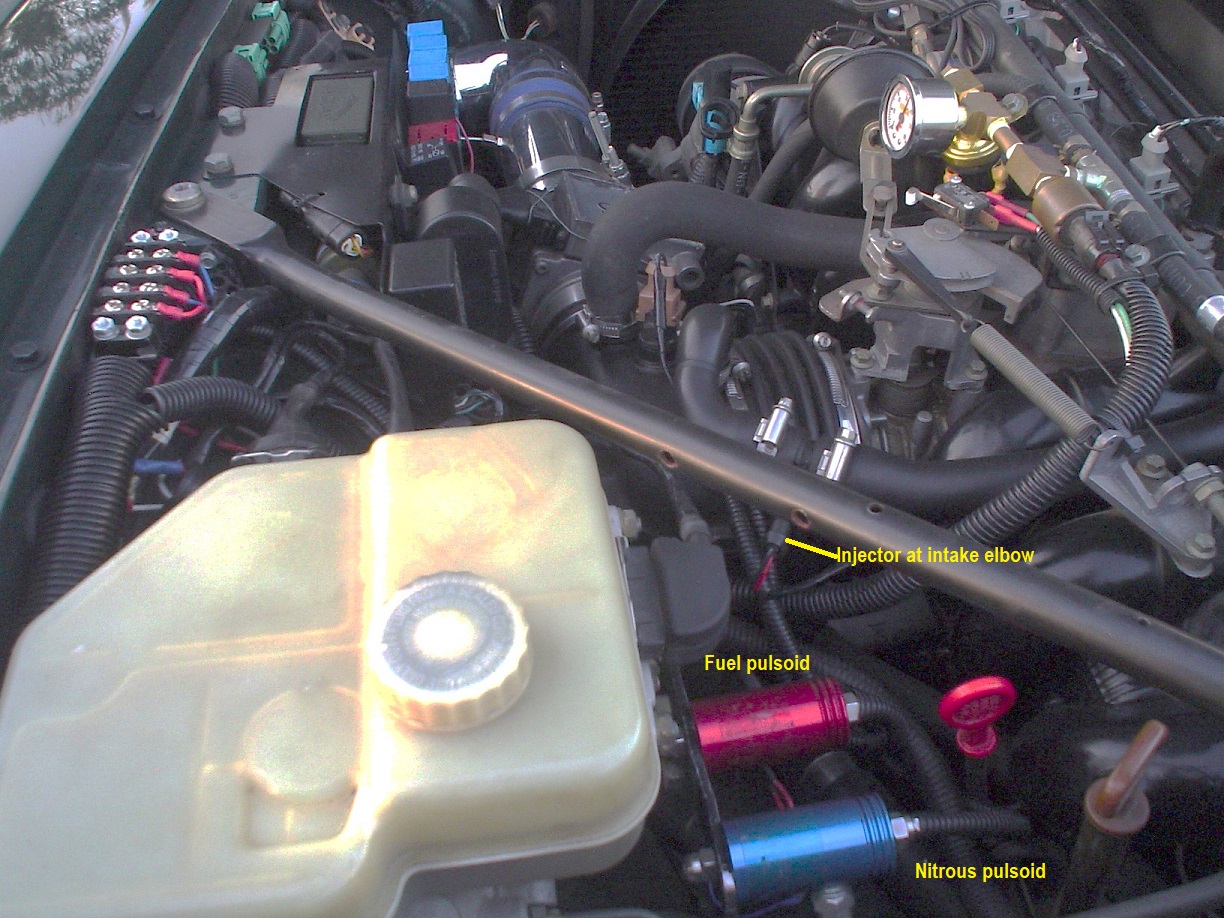

Lower profile Continental ExtremeContact tires on 17” Revolver chromed wheels, amazingly fixed these long time Pirelli tires unresolved problems (tough steering and awful ride).

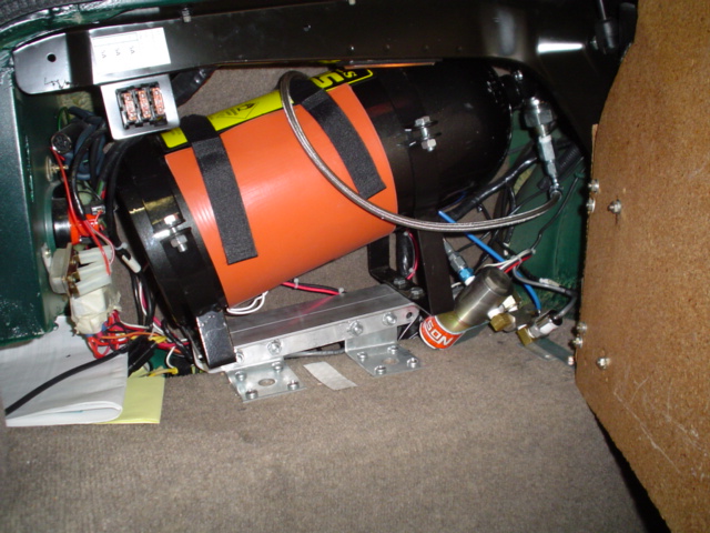

• Unique alternate nitrous use with “initial ½ second micro pulse” injection for quicker take off during normal driving, if so desired.
• Bottle, sensors and electronics are located inside the enclosed and locked left trunk cavity
• Pulsoids, injector and trigger generators for N2O injection.
