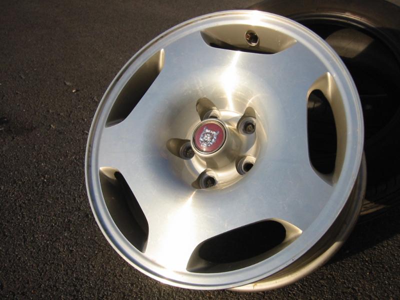

I have a set of 5 of these from a mid-90s XJR. I originally bought them for JagZilla, but, my plans for her now call for something more aggressive in appearance. I'm not sure if I'll sell these or, put them on SpeedDemon, when the 15" Michelin Pilots finally wear out. All 5 need to have the clearcoat stripped & refinished, and a couple of them have curb rash.

Those gold spoked ones are exactly what I'd like to put on mine. Right now I have 15" BBS RSII in gold, which are kind of similar. I'd love to put the ones you show here on in 17". Let me know how your search and fit goes and I may follow.

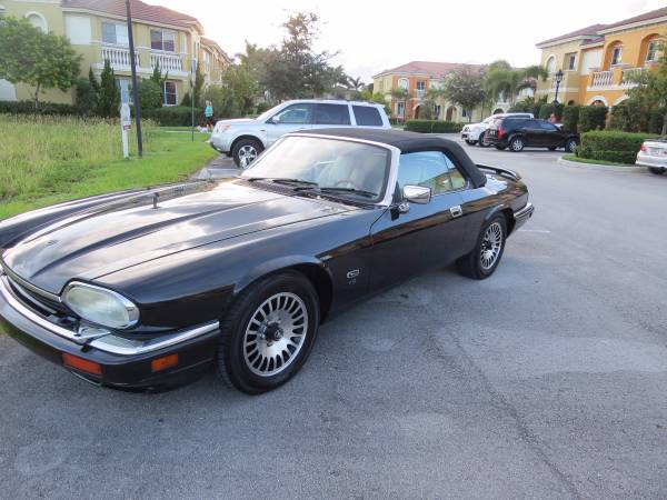

86 XJS with 95 XJR wheels. These wheels where equipped on the XJS in England.
