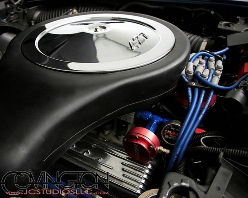

I see pics like this, of beautiful V12 motor:
And then I have this mess:
Has anyone ever gone retro with a 1988 style motor? Do earlier parts fit, or is a lot of custom work involved?
I have no smog issues to worry about.
