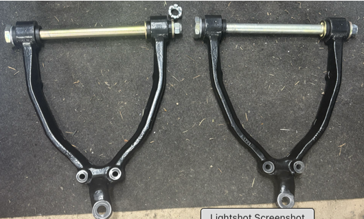

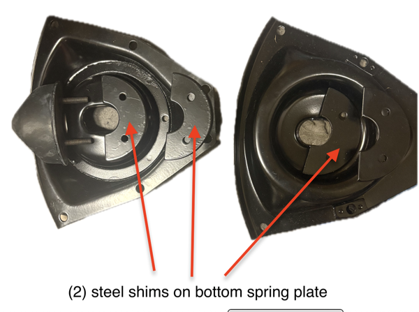

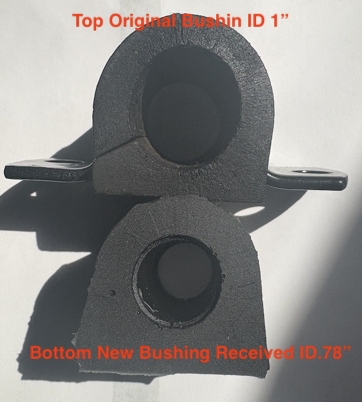

Thank you for the ideas. I think I will go with Greg's procedure due to the wight. I am having an issue in getting some of the correct parts, I have a 1989.5 year non-sports pac. XJS convertible Vin (157055). I have the standard front anti roll-bar that measures approximately 7/8" OD and the original rubber bushing ID diameter of 1". I do not see any colored markings on the bushings. The bushings I received have a ID diameter.78". The outside diameter is the same as the original except my original bushing has raised ends to avoid the bushing from sliding from one side to the other side of the strap. There are several bushings to choose from but most of the parts in the catalog do not include detailed information including dimensions. Does anyone know the correct part number for the bushings? I also received (2) lower rack arms that do not have a hole in the end of the bolt and the split nut for tie wire to lock the nut into place. The rod comes without a hole and comes with a nylock nut. I this the new installation that is being used and is it safe? I also received (4) steel shims for the two lower front spring cup and (2) nylon shims for the upper spring cups. My original installation had (2) nylon shims for each of the top cup for the springs and no steel plates in the lower spring cup holder.that I remember or have.It is my understanding that the two steel shimes in the bottom pad are to give mor camber into the car. How many steel shims and nylon shims should be installed? Are the springs to be rotated in a specific placement?

Did you by chance buy a kit for all the suspension bushings? I did, and the antiroll bar bushings were incorrect in the same manner as yours. The 3/4" ones are for an XJ6. I think everything else is interchangeable between the cars, aside from that one part. I got the kit from SNG Barratt, but when I ordered the individual bushings from them they were the correct size.
