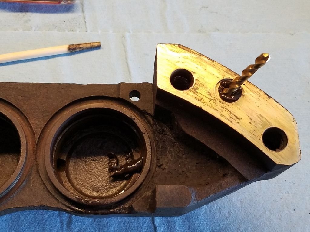

I haven't done this. However, if the '95 calipers are the same design as '91, you will likely retain the old fluid in the front calipers. I just repaired a friend's XJ-S front brakes. The fluid entry to the caliper is halfway up. The bleed screw is at the top. The lower two cylinders and bridge drilling ports will retain the old fluid, because the path of least resistance while bleeding will bypass the lower parts of the caliper.
Regular fluid flush with DOT 4 will expose that old "trapped fluid" to drier fluid and maybe it wicks out the moisture if there is any? If the new fluid is SBF it can't pull any moisture out. Maybe the same principle applies to the ABS system cavities? Maybe I'm over-thinking it, I usually do! If I couldn't be 100% sure of 100% replacement - I wouldn't do it.
The caliper fluid would concern me the most, since that's at the hot end of the system, where boiling is most likely to occur.
Solid crud in lower ports
Cleaned out OK
Rebuilt with new pistons and seals
If the caliper isn't solid like these, its easy to clean the calipers without separating the halves: Remove the pistons and flush through the ports with an air hose. Replace the rubber hoses as well. Flush the system out with the brake calipers off the car. That still leaves the original question of getting the fluid out of the ABS cavities...
I think I added more questions, but hope this is helpful and maybe others could comment on the concern of trapped old fluid in the caliper?
HTH, Dave
