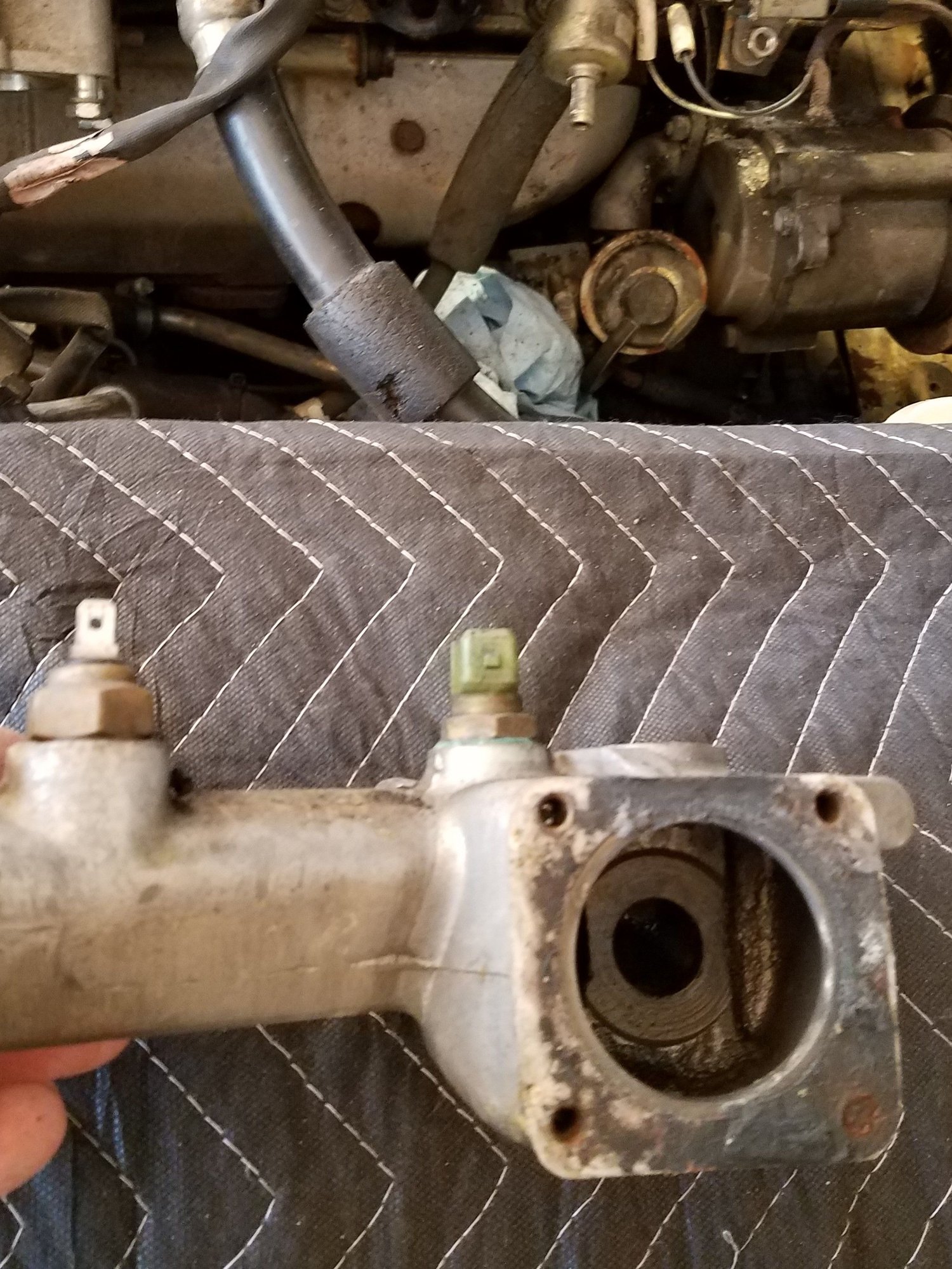

Now this:
You are seeing it as I found it. "A" side thermostat housing with a broken bolt, with the bolt head glued back in with red gasket maker, and no thermostat.
What I understand from reading around here, no thermostat is a bad thing.
So I am not sure how this wound up like this, I hesitate to blame the mechanic this car was taken to, but I am pretty sure the fellow that owned it didn't do any of his own work beyond keeping the fluids topped off.
Near as I can tell, somebody spent what appears to be a fair amount of money chasing a problem that would have been fixed by simply cleaning the leaves out from in front of the radiator. The electric fan was in the wrong place for the lack of thermostat (it cooled the top third of the radiator, the "b" side), the switch to turn on the fan was in the wrong place to sense the increased temp from lack of thermostat, if the cabin heat control was anything other than "off" the coolant from the head ran directly to the intake of the pump, bypassing the radiator. I dunno that this thing had any choice but to overheat.
My prayer now is that it didn't get hot enough to drop a valve seat.
and since I'm in it this far, change the water pump?
So there you go. Sometimes things really are that simple.

At this juncture I'd replace the water pump if it was noisy or leaking. Look at the underside of the pump for coolant stains. Otherwise, no.
IMO the effort and money is best allocated for removing the radiator for professional cleaning at a radiator shop. It's common for them to be clogged up internally. Sometimes a new core is needed.
If you DO decide to replace the water pump then the time to do it is when the radiator is out.
If the heater is bypassed then I suspect the heater core is leaking. Fortunately, your car has the later system and replacement is not particularly gruesome.

yeah, no stat is usually pretty bad. It works in some cars, but not in most. The slot at wide open for the Tstat is much smaller than the housing itself. Not to mention it disrupts flow as well. If the coolant moves too fast, it can't really absorb heat, likewise there isn't much time for the radiator to take heat away.
Like mark said the mechanical fan does a lot of work and usually isn't worth replacing with electric for the money. Sounds like it would be easiest to go back to stock with the housing, fan, and anything else because baseline from the factory clearly is not an overheating condition.
