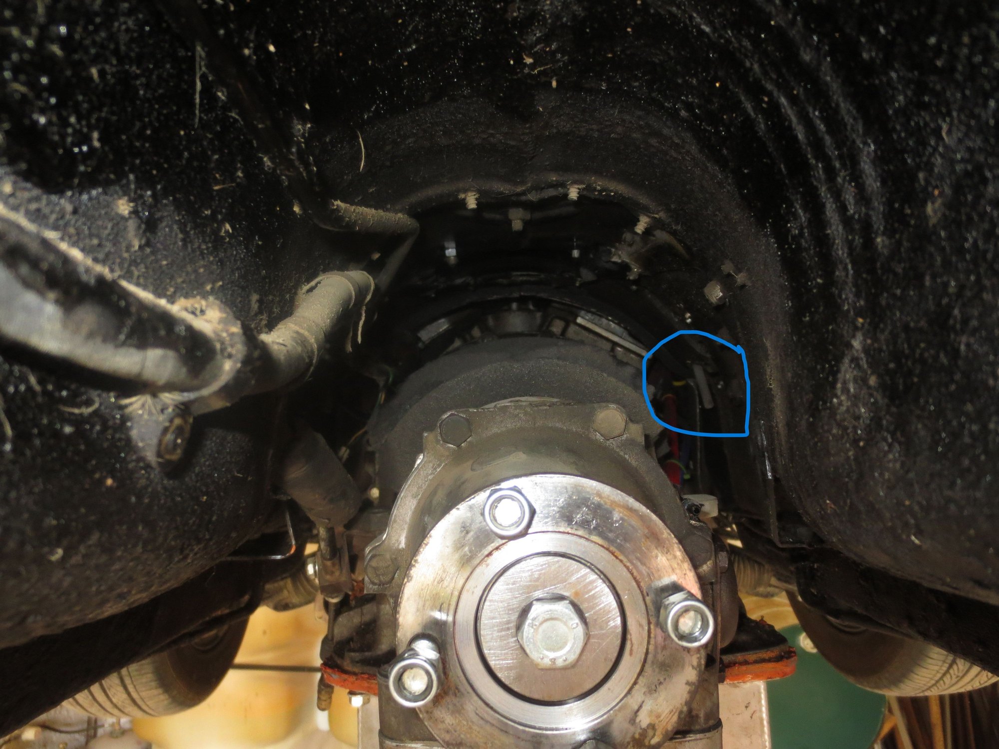

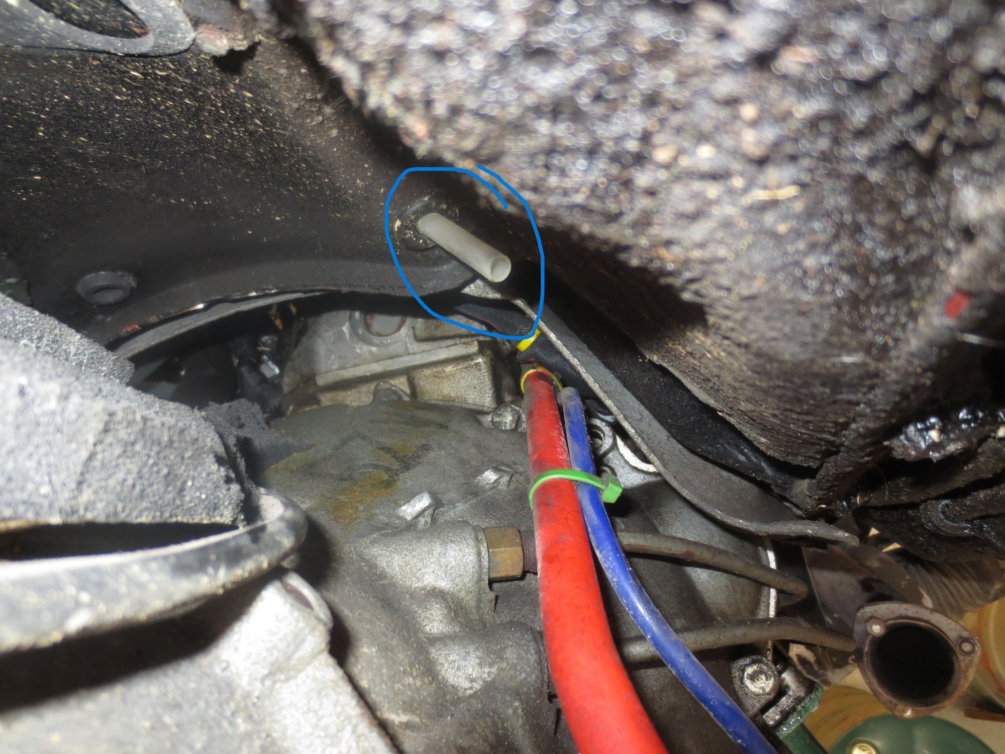

You may be thinking of the drains for the consenste from the aircon? There is a shallow tray under the aircon unit which has two small drain tubes from it that run down each side of the transmission. These can only be accessed from under the car and poking them ckear with a bit of stiff wire is a good idea. They are not easy to see, but here are some pics showing the RHS aircon drain tubes:
