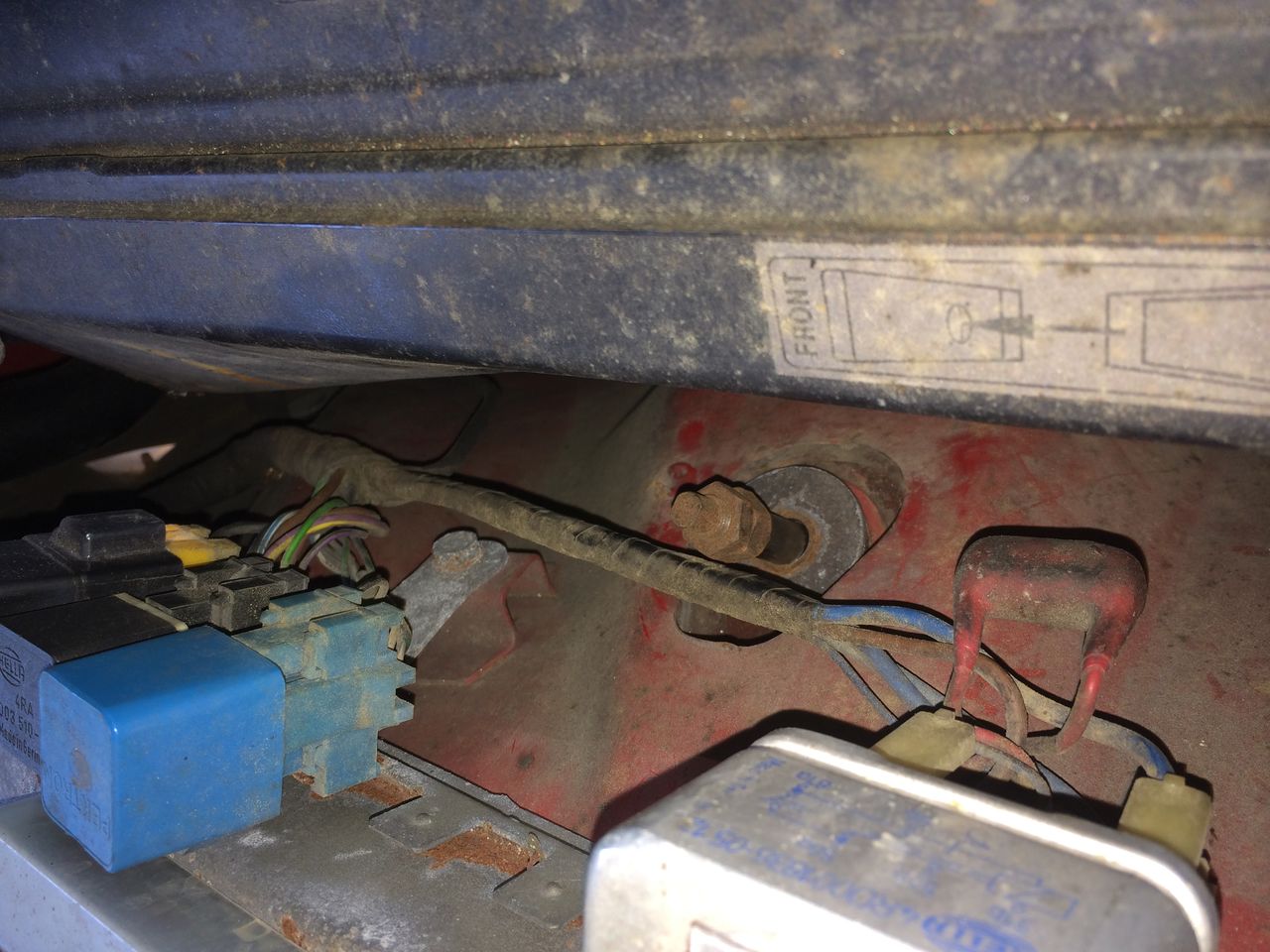

I'm going to revive a little bit older thread because I have a question about this.
I have the exact same issue. Upon further inspection, the front shock bushings are completely SHOT!!! I have a question though. It looks like there should be a bushing under the fender and another bushing or mount in the engine bay on top of the fender.
One side of the car has nothing but the bolt from the shock sticking up and its the side that makes the worse racket.
Here is a pic (it turned sideways)
I've been looking online and I found THIS part for the upper shock bushing:
I'm just confused because it looks like i need 2 bushings. One underneath the fender and one above in the engine bay.
Any advice for parts?
Old May 8, 2014 | 04:55 PM
sainmatt's Avatar
Joined: May 2014
Posts: 31
From: Greenville , SC
Sorry here is a link to image:
View image: Photo May 08, 5 42 22 PM
Old May 8, 2014 | 04:57 PM
sainmatt's Avatar
Joined: May 2014
Posts: 31

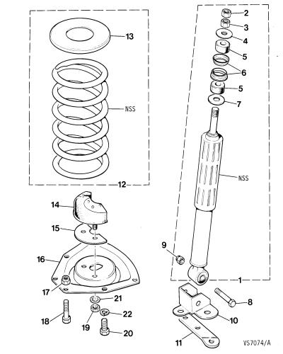

Yes, you need two bushes, one above one below the inner wing metal. You also need TWO special washers to hold the bushes and locate the assembly in the wing hole, and TWO flat round washers to go the non-wing metal side of the bush. Here is the diagram from JCP, you need parts 4, 5, 6 7:
Shock Absorber and Spring-Front-5.3 Litre - Parts For XJS from (V)139052 to (V)179736 | Jaguar Classic Parts UK
