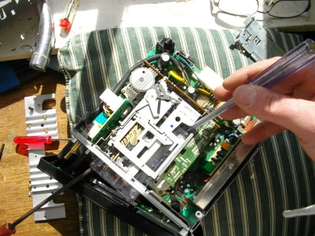

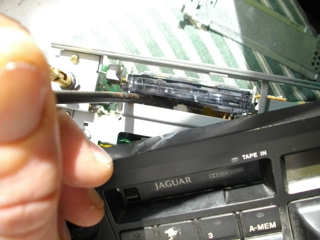

You can remove Billy Bob Buttbuddy it just requires patience and a little surgery.
Tools req'd 2 screw drivers, something suitable, and a teaspoon.
Open the cassette flap and jam it open with something suitable on the right side.
Looking into the left side at the top left corner you will see a lever, with 1 of the screwdrivers move and hold this in the up position.
Now at the same time look at the bottom left corner of the cassette slider tray, and with the other screwdriver move the small lever upwards to release the carrier tray.
You can remove whatever was holding the flap open because you now have 2 screwdrivers in there.
This will allow you to use your "pinky" to gently raise the front of the carrier so that the front cassette driver cog can clear the pinnion.
Leave your pinky in place so that it doesn't drop back down and now slide the spoon under the cassette tray and pivot the spoon in such a way as to raise the rear of the carrier, thus clearing the rear pinnion.
Maintain the spoon in position and with whichever of the screwdrivers is still in reach, you can gently prise Billy Bob forwards.
When enough has appeared you can then take a hold and remove him all together.
Pics attached are of a dismantled unit that was handily in bits in the cupboard. The cassette was inserted and then removed as above.
If you can't get the cassette out using the above in situ in the car, then quickly remove the unit, by dismantling the center console, ski-slope, radio surround and then try again on the bench, before pulling it to bits. Requiring the removal of all visible screws!
There are a couple of wiring connectors to the front control plate that are easy to remove when you have removed the screws but are a nightmare to reconnect.
That's it.
Simple!!!!
Sorry if the first pic isn't quite at the correct angle, had to hold the clear screwdriver in my teeth in order to take the shot with my oher hand. (the things we have to do!)
Cheers,

AMAZING Translator!!! Printed it out and all set to go.
Now, if I can just find a Jaguar toolbox that has the right spoon, pinky and left-handed screwdriver.
