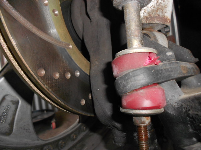

pic of anti roll bar Poly bushes, after couple years, i would not recommend them, factory rubber will last till maybe the end of your life(depending on your age).
i ended up with MOOG bushing kit, synthetic rubber, been fine so far, $30. dollars!

anti roll bar bushes,pics
