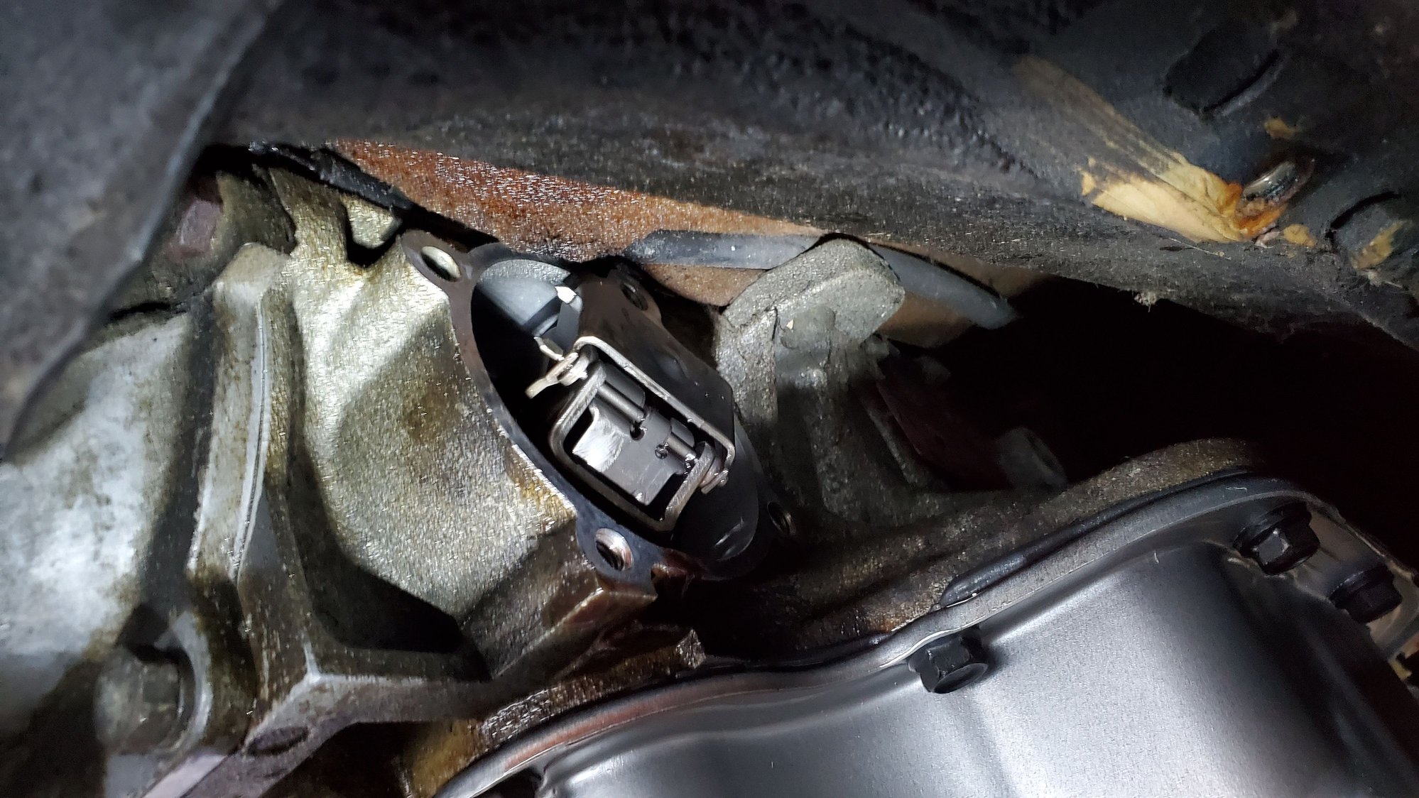

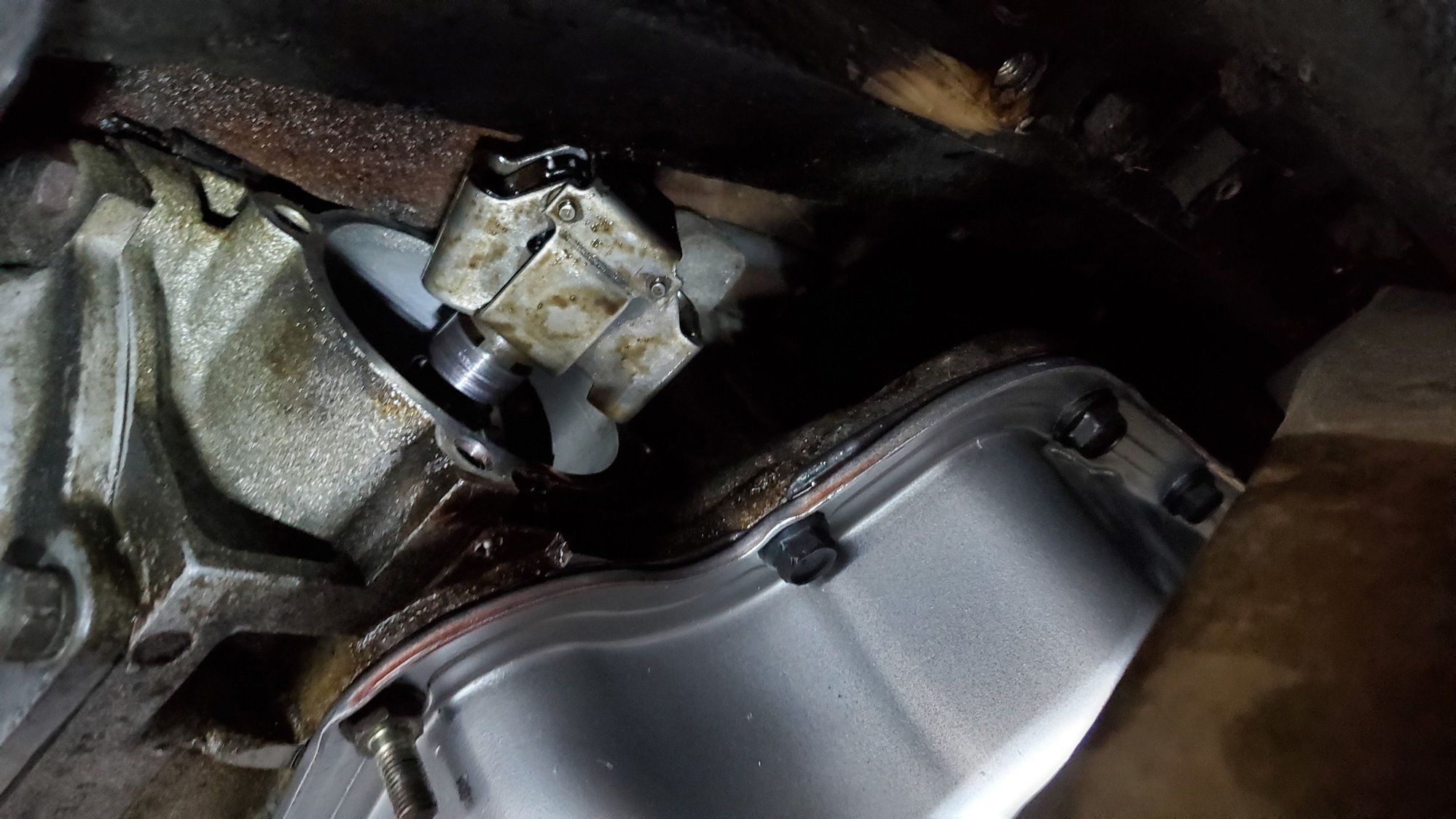

Well i attempted to get the governor out. No access panel fyi in my 88. After removing the tranny mount, heat shield, and another little bracket i got the cover off. About a litre of fluid came out, and then I tried turning it as per Kirbys book, didn't move. Thats a good thing i guess. So I wanted to pull it out to inspect it for wear. Well I guess jaguar decided that let's remove the acces panel and force the owner to drop the transmission in order to get it out at some point to make more money.
As far as i could gct it out before it hits the tunnel wall.
How it sits
As far as i could get it out. Fml.
