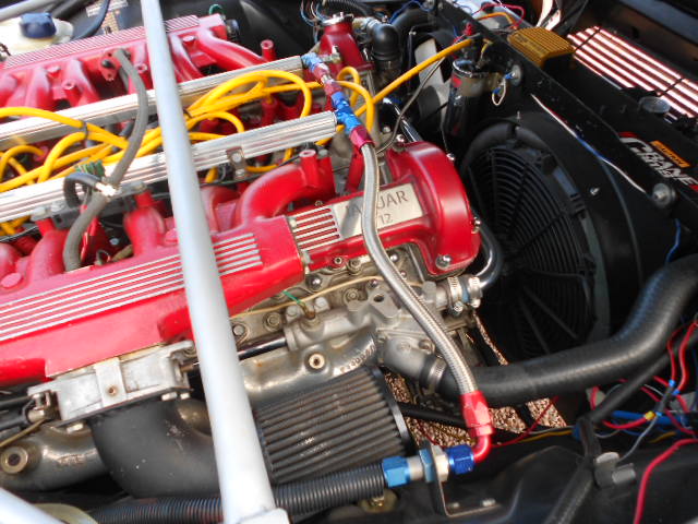

heres mine 22years and counting. covers and manifolds.
glass bead blast to bare metal(not sand always dirty), glass ***** closes the pores!
good old fashioned marine grade oil base rustoleum paint(no primer), sprayed on let dry for many days , before putting on engine !
seems to be satisfactory , for the time, have been off couple times for minor work!
i have washed engine couple times, but no harsh detergents, just mild car wash soap!
exhaust mani's ceramic coated still look good!
again its your car do what you like
i have painted all my engines RED since 1949, no sense in changing now!, Red Hot and fast!! LOL
