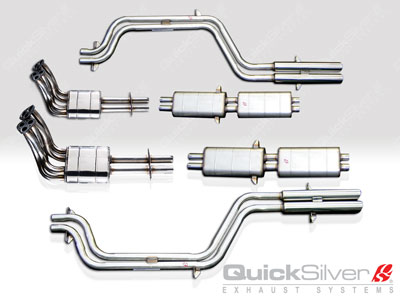

If you look at a typical V12, front engine Ferrari, the exhaust on each side is a set of duals.
Not a great picture, but this is a 275 GTB. The front three cylinders and the rear three cylinders on each bank feed their own branch. The mufflers are just perforated resonators. The pipes are relatively small, but that maintains velocity and increases the pitch and timbre of the exhaust note.

On a 4.0 XJS, I would try to duplicate the layout of an XKE or early Aston Martin inline six. Basically, the front three cylinders and the rear three would each feed separate pipes, 2" in diameter. Two perforated glass packs on each of the branches, no crossover or x-pipe needed.
Early XKE's sound amazing, esp at higher rpm.
