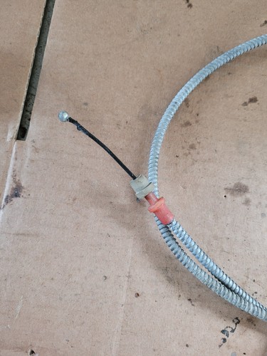

  • Cars of my age and earlier: there is a bracket inside the car above the pedal to which the OUTER is fixed by means of a threaded endpiece and two nuts, just like that at the capstan end. This cable has the kickdown mechanism as shown in the photo above, and is illustrated in this photo:
  • At some point after my model was built, but before the facelift cars, this was changed to a "rubber-grommet-and-pressed-in-inner-piece" which anchored the pedal-end of the outer to a hole in the firewall (bulkhead). This cable also has the kickdown mechanism as shown in the photo above. The pedal-end outer bulkhead fixing is shown in this photo:

So, as I did not need the pre-facelift kickdown throttle-cable mechanism, and as I saw a brand new facelift cable for sale for only 11 UKP, I bought it, assuming it would fit. Which it did not! Because it was too short overall and even if it had not been, when the outer at the pedal end was anchored to the bulkhead and attached to the pedal, there was no inner left to connect to the capstan!
So point 1: facelift RHD throttle cables will not fit pre-facelift cars, even if you do not need the kickdown mechanism.

Then it dawned on me that as I did not need the kickdown mechanism, all I needed was a bespoke cable from a specialist. I ordered one up from Wicks and Martin, Bromyard, Worcester, UK, https://www.wicksandmartin.co.uk/ and after a brief phone call the spec was sent to them and 50UKP and 10 days later I had my cable!
Inner length overall 120cm. Outer LOA 106cm. Therefore the INNER must have 14cm showing outside the outer.
Pedal end: ball fitting and threaded outer.
Capstan end: Barrel fitting and threaded outer. No cable-based kickdown mechanism needed, see link above.
