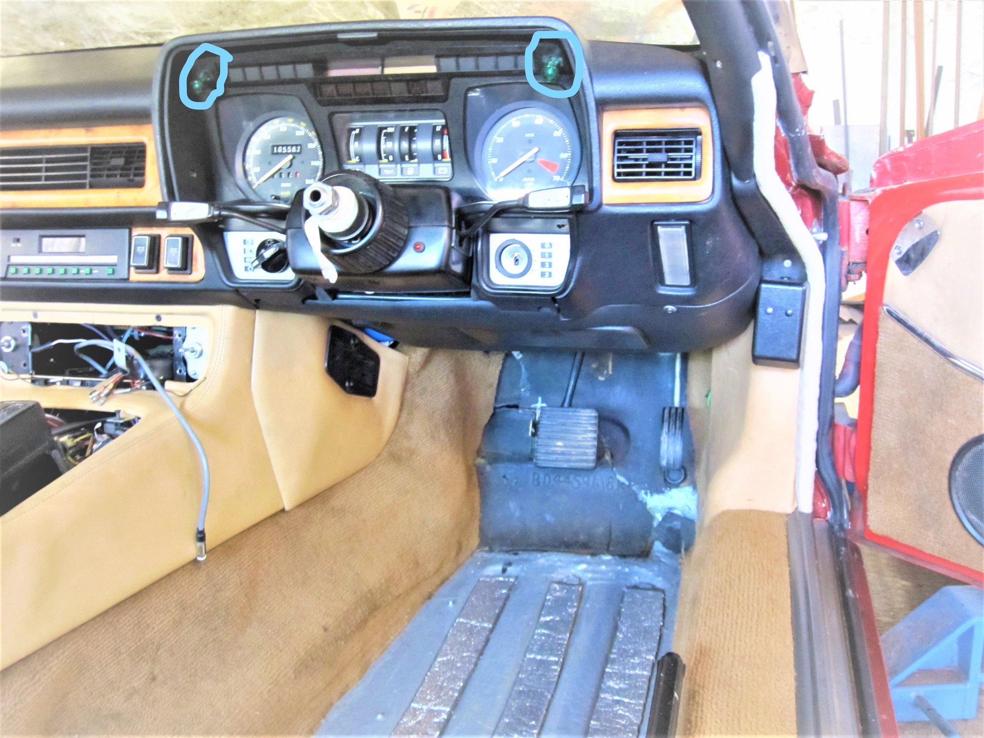

Greg... you always come up with "gems". 1 side-thought is where the indicator lights appear on the dash. Nice planning to put them where the steering wheel blocks clear view. Only at night can I see them blinking. Whadda gonna do?

I placed extra repeaters as per this pic; but the reason for the sounder is that in bright sunshine I still do't notice them enough. The extra repeaters are fixed to the plastic blanks under which the screws to remove the binnacle are. They are wired up to the OEM lights in parallel by careful soldering to the fitting that holds the OEM push fit bulb. The extra lights are green plastic and about 3/4 inch long. If you want a close-up let me know.
