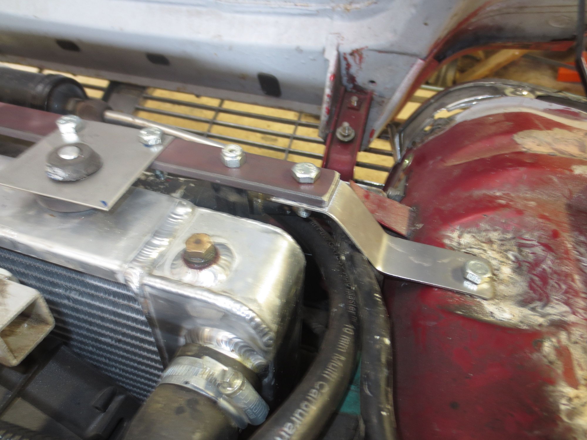

As the cooling system has been mentioned, and apologies for the change of subject, but I thought it worth mentioning that it can be made to function like a 'normal one', if you have a non ABS car. However, since Ben said in Post 50 above "The cooling system is an absolute abomination and is one aspect to my V12 that I have 're-designed' I won't go into crazy detail here." But i will about what I did Ben!
I agree the OEM cooling circuit in the XJS V12 is an abomination. In a pre facelift, non-ABS V12 XJS it can be sorted to be much better. The problem, fundamentally, is the extraction of air from the cooling system, and this is a problem because the header tank is below the level of the engine and the radiator: hence the desperate air bleed/banjo/central filler spout/force-fed venturi/radtop pipe/question mark pipe "system" to overcome this fundamental flaw.
The fixing design (explained to me by Grant Francis who did it first, and which I developed and installed in my car) is as follows:
  1. Move windscreen washer bottle to the space behind the wing stone baffle. The problem for an ABS car this original washer bottle space is not available as it is full of ABS stuff, which is why Jaguar moved the washer reservoir to the wing on ABS cars)
  2. Have a header tank made up with three outlets: i) 1/2 inch diameter at the bottom to tap into the heater return pipe, ii) 5mm into the pressured part near the top for the radiator bleed, iii) overflow to atmosperic tank in the cap space as normal
  3. Iemove the banjo, radtop crosspipe, question mark pipe, OEM header tank, venturi high pressure source pipe, and the spouted crosspipe and all associated smalllbore flexibles, (blank off as required
  4. Install the saloon spoutless crosspipe to the engine
  5. The thread size on the radiator bleed bungs is 1/8 inch BSPP. take the bung normally on the LHS and install it into the RHS (old banjo) radiatot position.
  6. Buy a SHORT 1/8 BSPP 90° bend and a 6mm hosetail to fit. Install this in the LHS of the radiator
  7. Run a hose/hose and stainless 4mm ID (6mm OD) from this hosetail to the header tank you have installed in place of the washer bottle
  8. T into the heater return pipe from the 1/2 inch outlet on your header tank
  9. Run the overflow to a atmo tank installed where the OEM header tank used to be.
  10. Fill system from ABOVE the level of the engine/radiator! Kiss goodbye to all your fill and bleed problems!

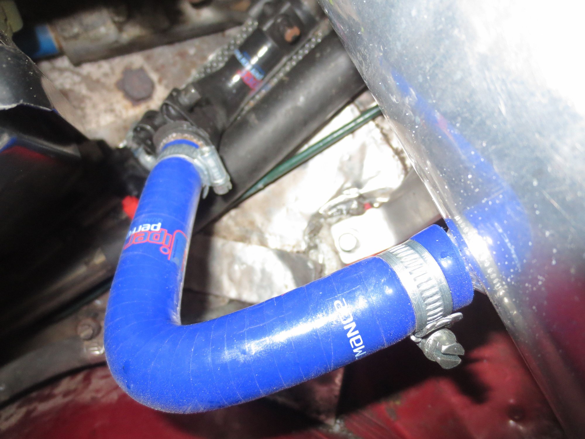

Custom header tank: blue hose goes to the heater return (this is the main connection to the systyem to fill it). Small hardline to red flexible is the bleed line from the radiator. Longer red flexible is to the atmospheric overflow

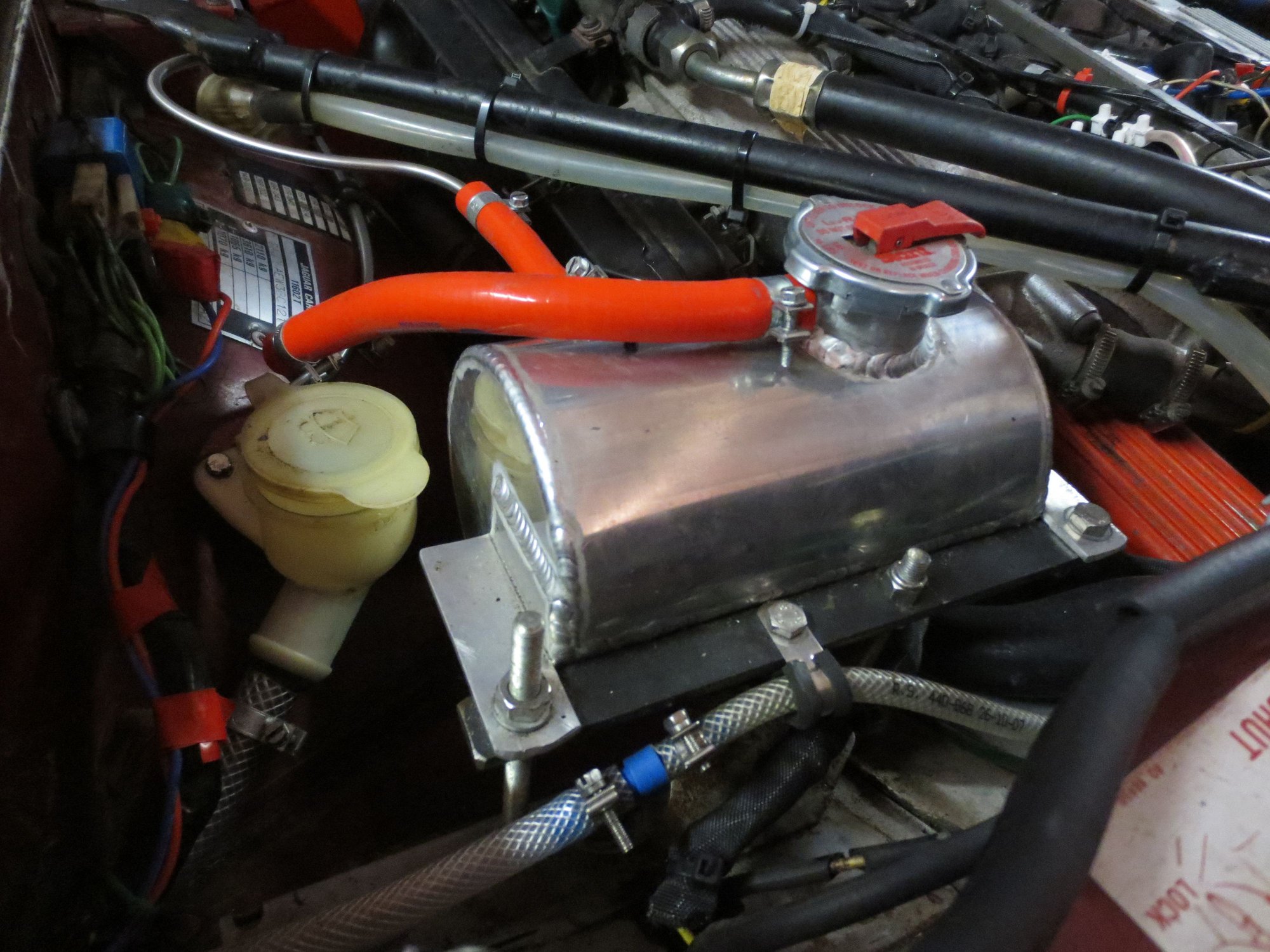

View from the rear looking forward. Filler for ming mounted washer bottle by the tank.
View from the rear looking forward. Filler for wing mounted washer bottle by the tank.

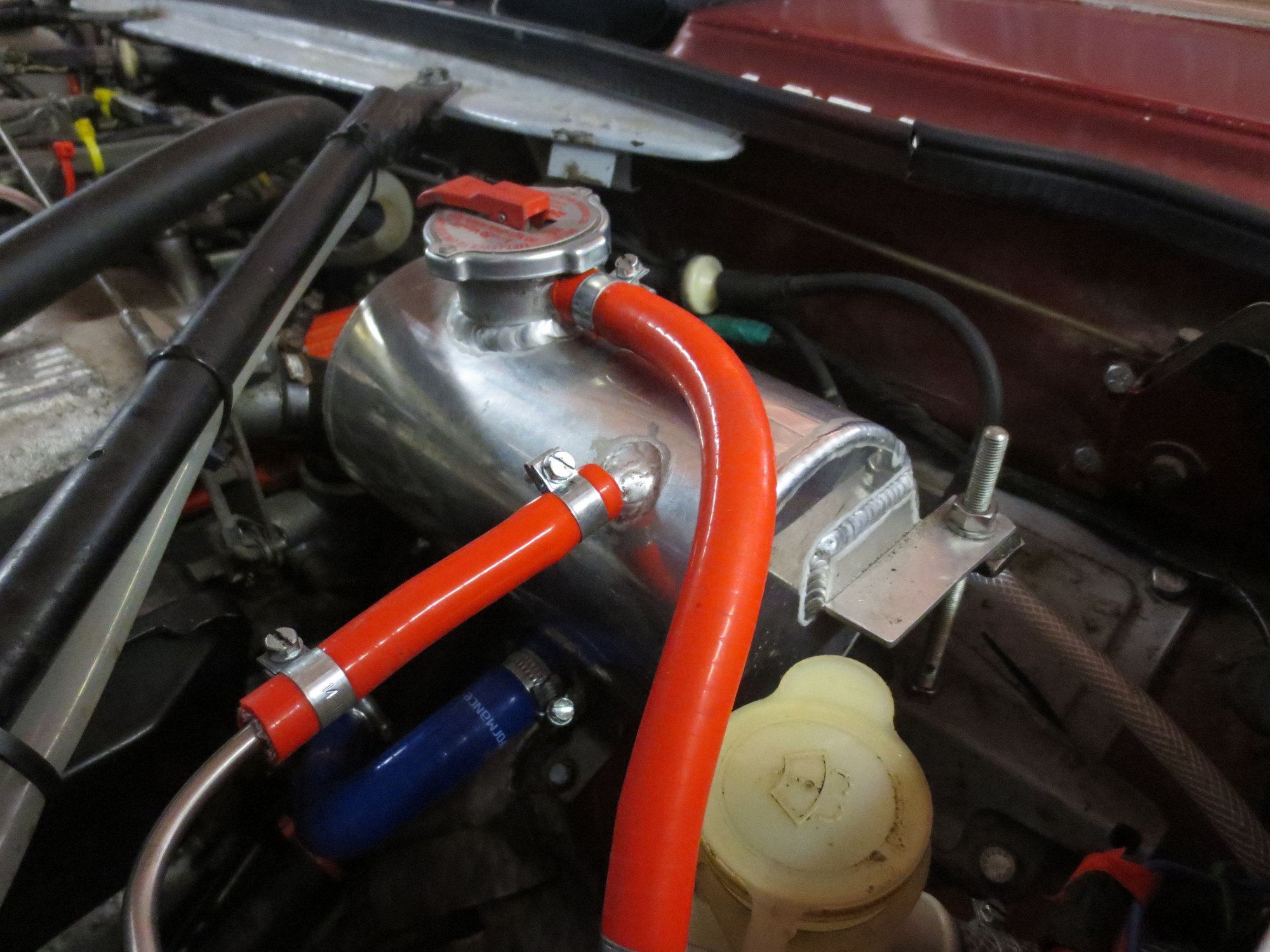

Close up of connection to the heater return. I used very high spec hose for this connection and double T clamps.

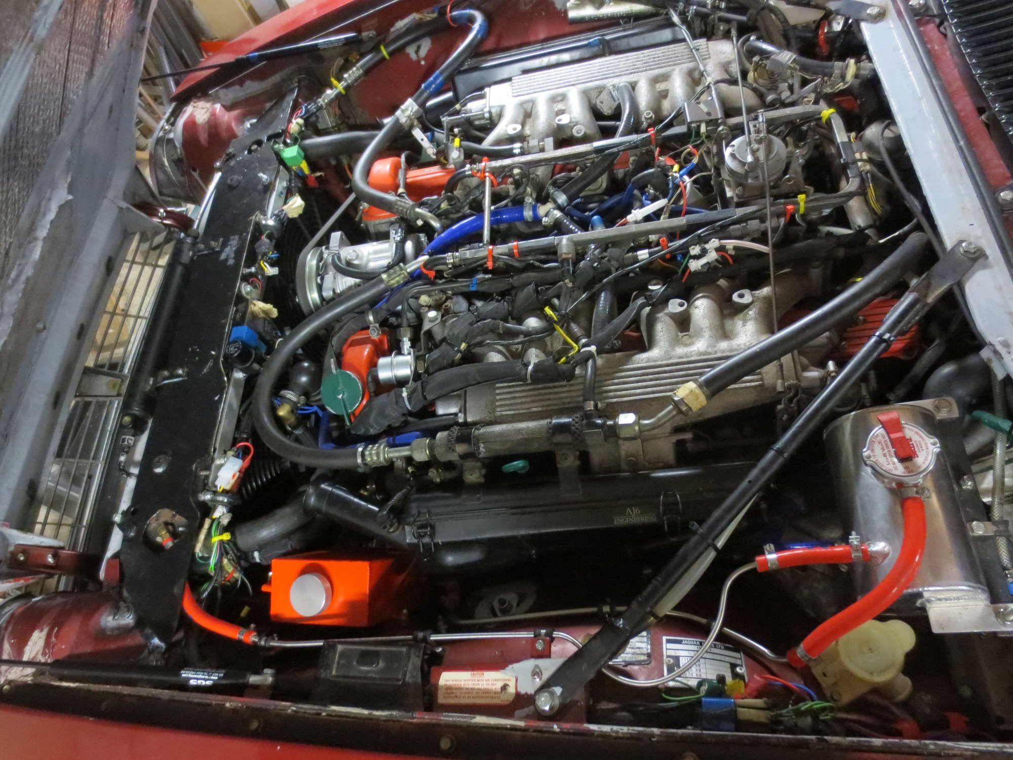

Overall shot of the system. You can see the stainless 4mm ID hr=ardline going slightly uphill from the radiator to the tank. The red  tank is the atmospheric overflow
Overall shot of the system. You can see the stainless 4mm ID hardline going slightly uphill from the radiator to the tank. The red tank is the atmospheric overflow. NOTICE: no central filler spout
Solid bung on RHS where the banjo used to be
90° 1/8 BSPP fitting to bleed the air to the header tank

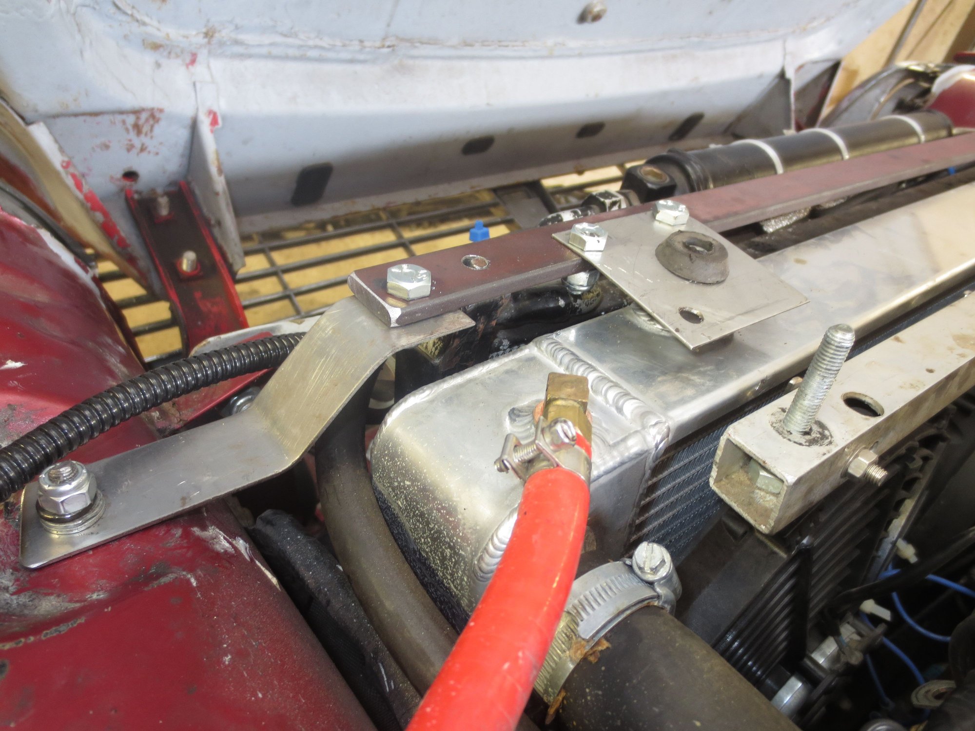

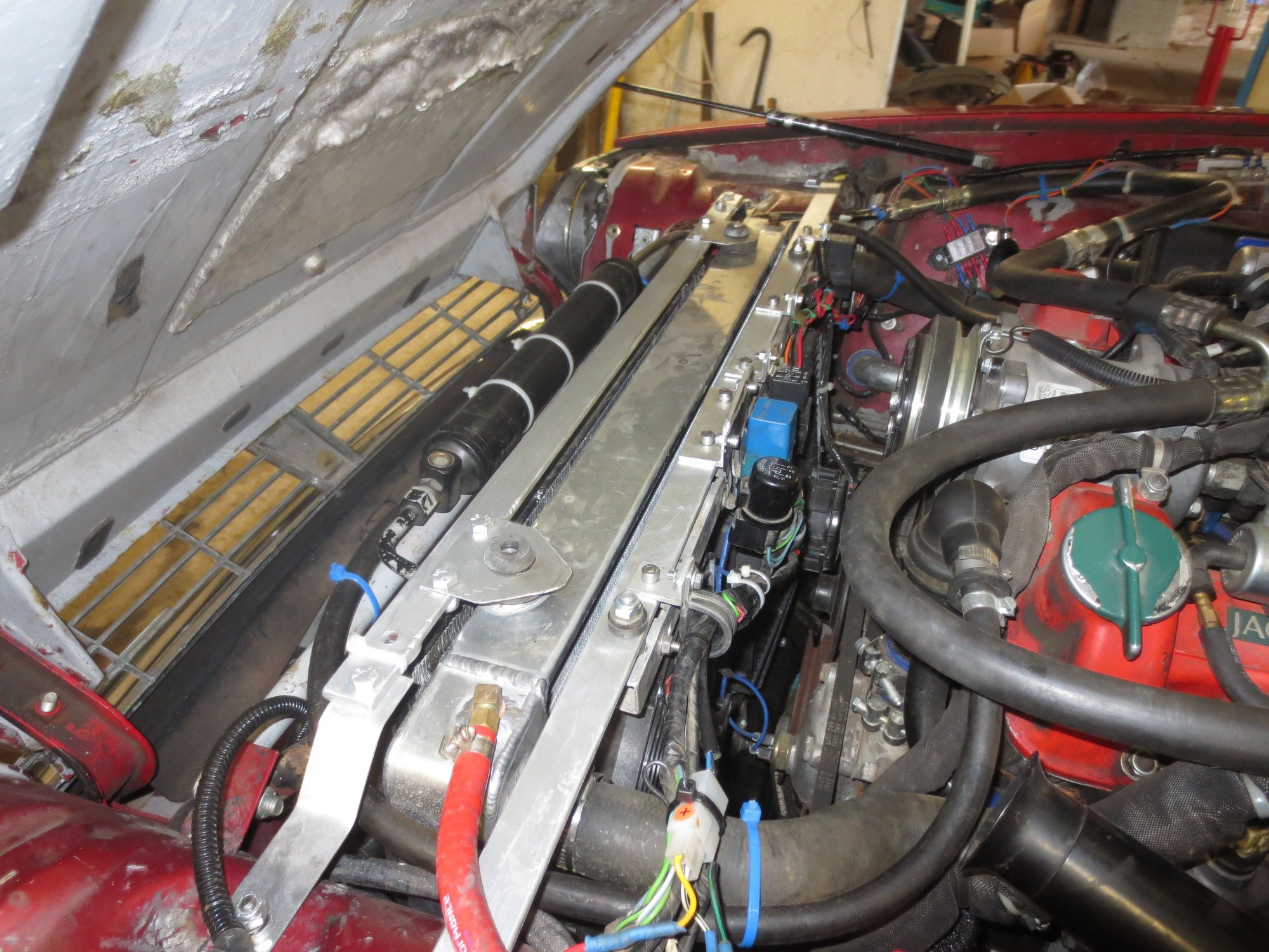

My radiator top fixings. The rearmost holds the electric fans and the front one secures the radiator, the aircon dryer and condenser top fixings. Loads more airflow through the engine bay.
My radiator top fixings. The rearmost holds the electric fans and the front one secures the radiator, the aircon dryer and condenser top fixings. Loads more airflow through the engine bay. No foams round the radiator either.

I dumped the atmospheric and had a larger 'shaped' expansion tank made, my original was round but I determined the capacity was too small to manage the expansion, retained the bleed circuit, my washer bottle is behind the right headlight and the vacuum reservoir behind the left (retained only because of the Delanair but I plan to work on that too - eventually - eliminating any dependence on vacuum for anything but brake servo). I have a 4 row radiator, larger fans and three temperature measuring locations - but this is way off topic -
I'd love to find a solution for the oil cooler but locating one given the design of the circuit is more of a challenge than I am interested in right now the fact that you cannot drain the thing or the pipes under the engine is a real annoyance.
