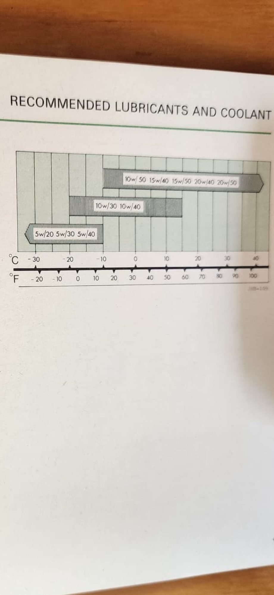

Take a look at the temperature ranges. According to the chart, 5W-40 is only suitable up to an ambient of -10°C. However, a 15W-40 is suitable to temperatures of over 40°C. That makes no sense at all, as the 40 is the grade when hot in the engine. Why is one 40 weight oil only suitable to -10, yet another 40 wt is suitable to over 40°C?
It's impossible to satisfy both temperature conditions at the same time for a 40 oil, which is why I said whoever wrote that chart didn't understand oil. No tribologist would have signed off on that.
