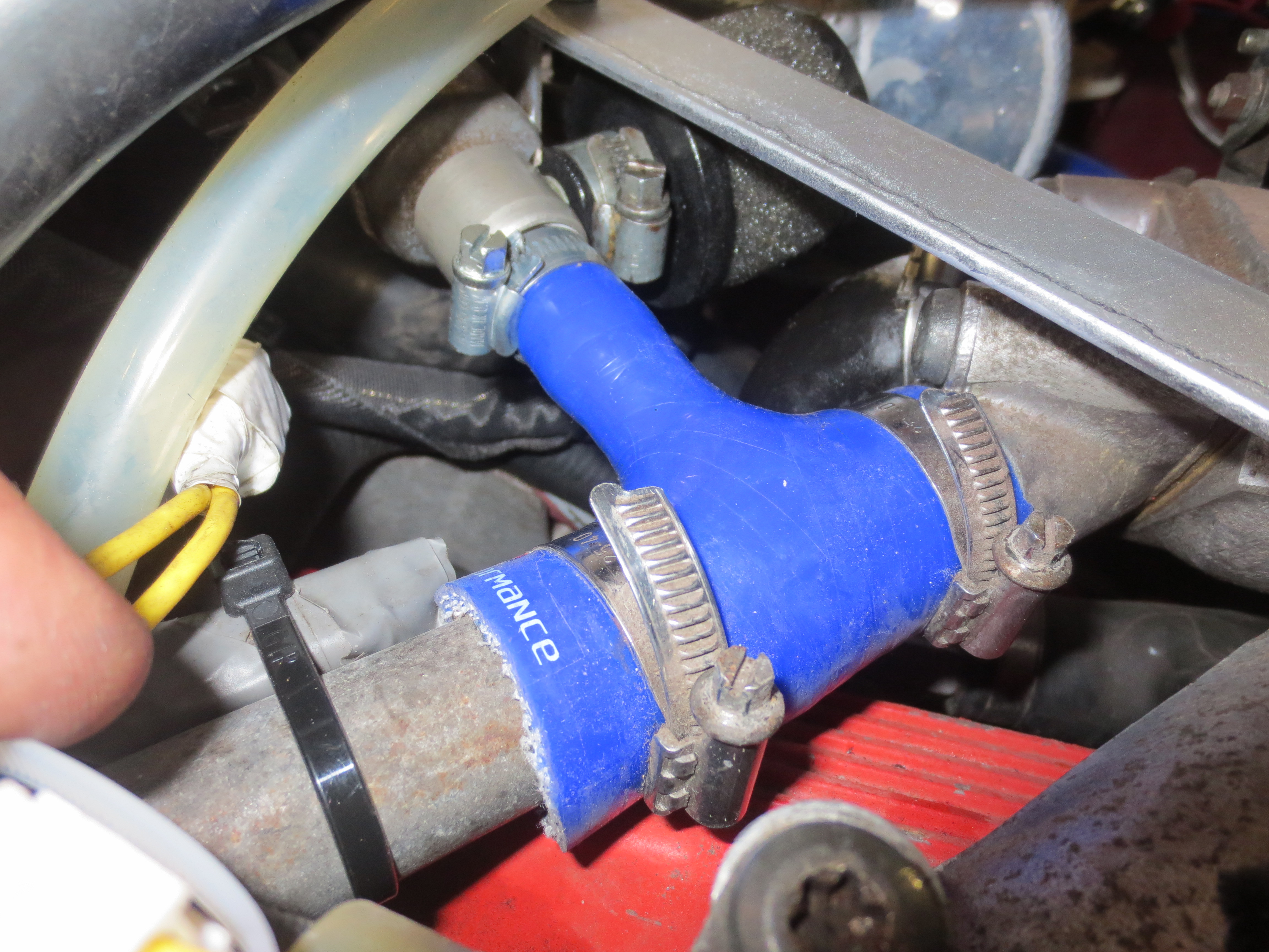

That is true, Doug. I got fed upwith the AAV sticking every so often, so retained the part that is the idle speed adjuster, and blocked off the extra air passage. Then I fitted a T shaped hose (from the guys at Viper Performancein the UK) to replace the normal B bank crosspipe rubber hose. Into the leg of the T is fitted a genuine Jaguar solenoid air valve as was fitted to the 3.6 litre cars for cold start purposes. See 8 in the diagram link here: https://www.jaguarclassicparts.com/u...alve-3-6-litre
Cabin switch for the solenoid. Works wonderfully well in cold weather; I switch it off after about 800 yards. A few diagrams and snaps attached.
Greg
Attached Thumbnails V12 AAV hose size-img_5587.jpg   V12 AAV hose size-img_4007.jpg
