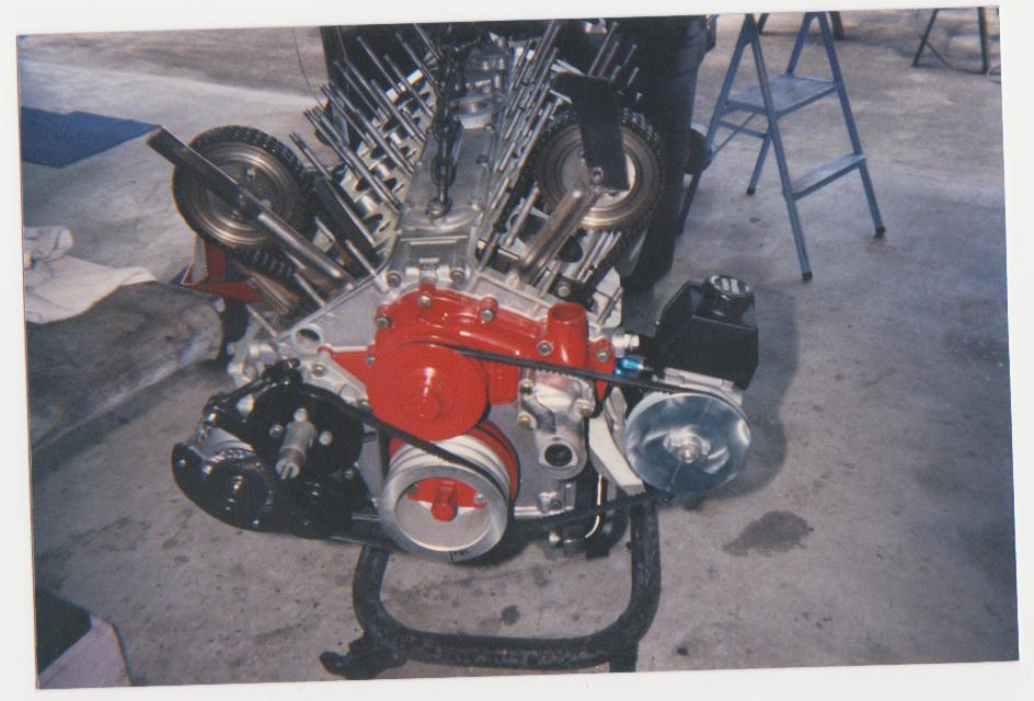

back 1995 i bought from Lanky a complete set of oversized valves for my engine build, they measured 3MM larger than stock , made of forged single piece stainless steel, he said it was what they used in there engines at that time mid 80s!
my heads are ported and smoothed , nowhere near as large as those race ports in your heads, valves are fitted and blended to bowl area (3 angle seats). inlet/plenums are Extrude Honed and port matched
it will be interesting to see the results of such large ports, hoping to still make usable torque in mid range, as some one mentioned TWR engines did not make good power till after 5000 revs!

1995 ,,engine in build process!
Attached Thumbnails V12 group44 heads project-jaguar-engine-build-process-001.jpg   V12 group44 heads project-004.jpg
