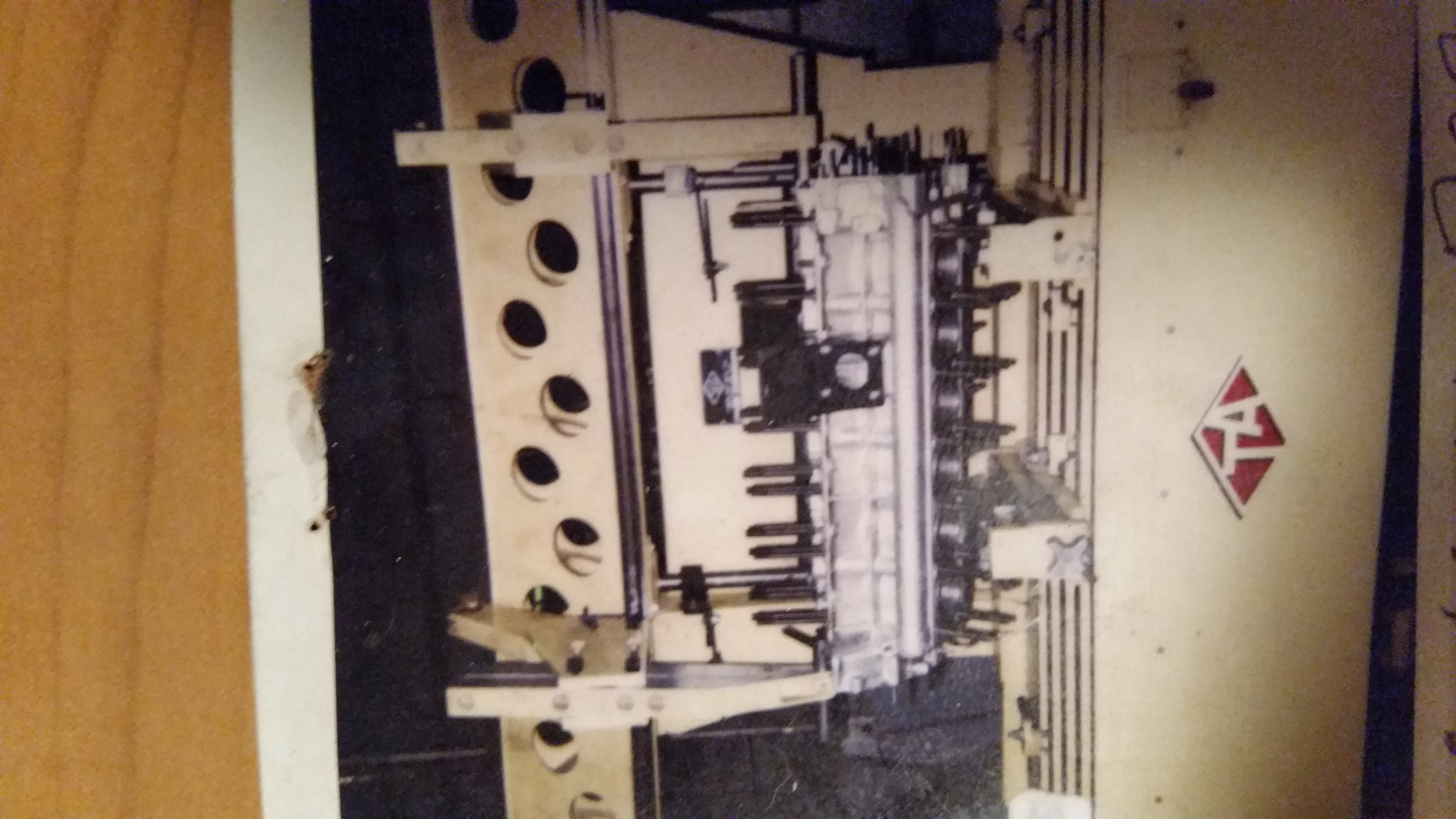

HEY i like your new Lathe, and mill, next comes a good surfacing machine, so you could build a closed deck block?
then you need a main brg align bore machine, the list is endless!
pic of my Align bore , with a LAMBO V12 block on it.
