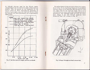

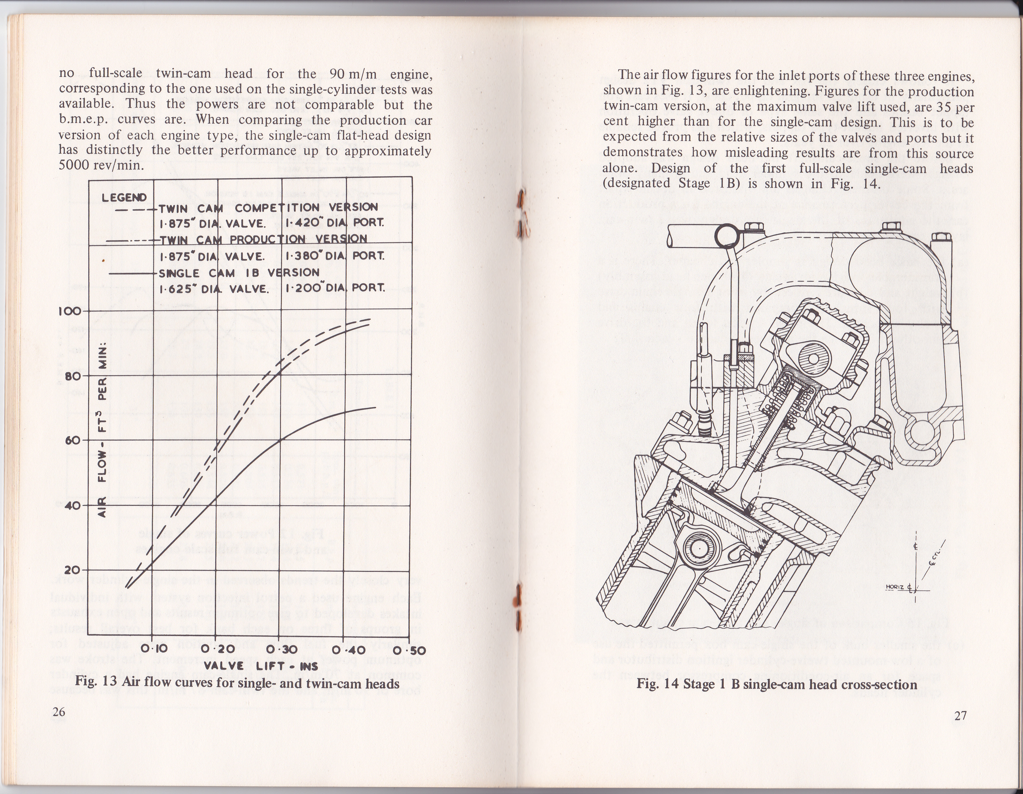

came up with this factory exhaust port drawing , showing a 90* angle ,preHE,!
anyone got a profile pic of the HE, seems it maybe even tighter angle?
the pic that 5006 shows of the Cali. Grp44 exhaust shows a much better angle! altho thin wall at the short turn seat angle.
i think that port is what we in states refer as a raised port(higher up on the exhaust side, common on BBC & SBC, both inlet & exhaust, it became a must do thing in later years).
