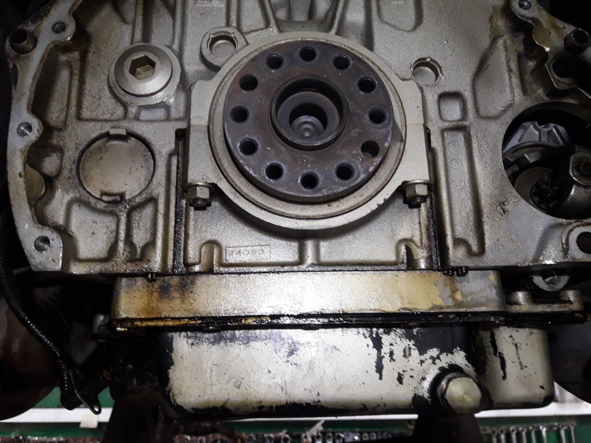

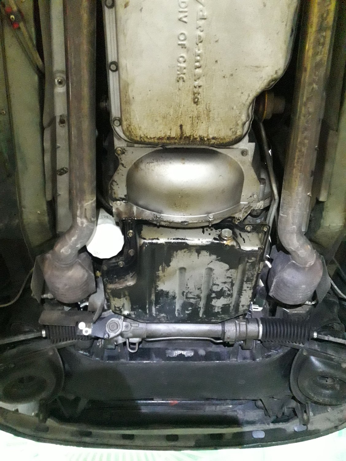

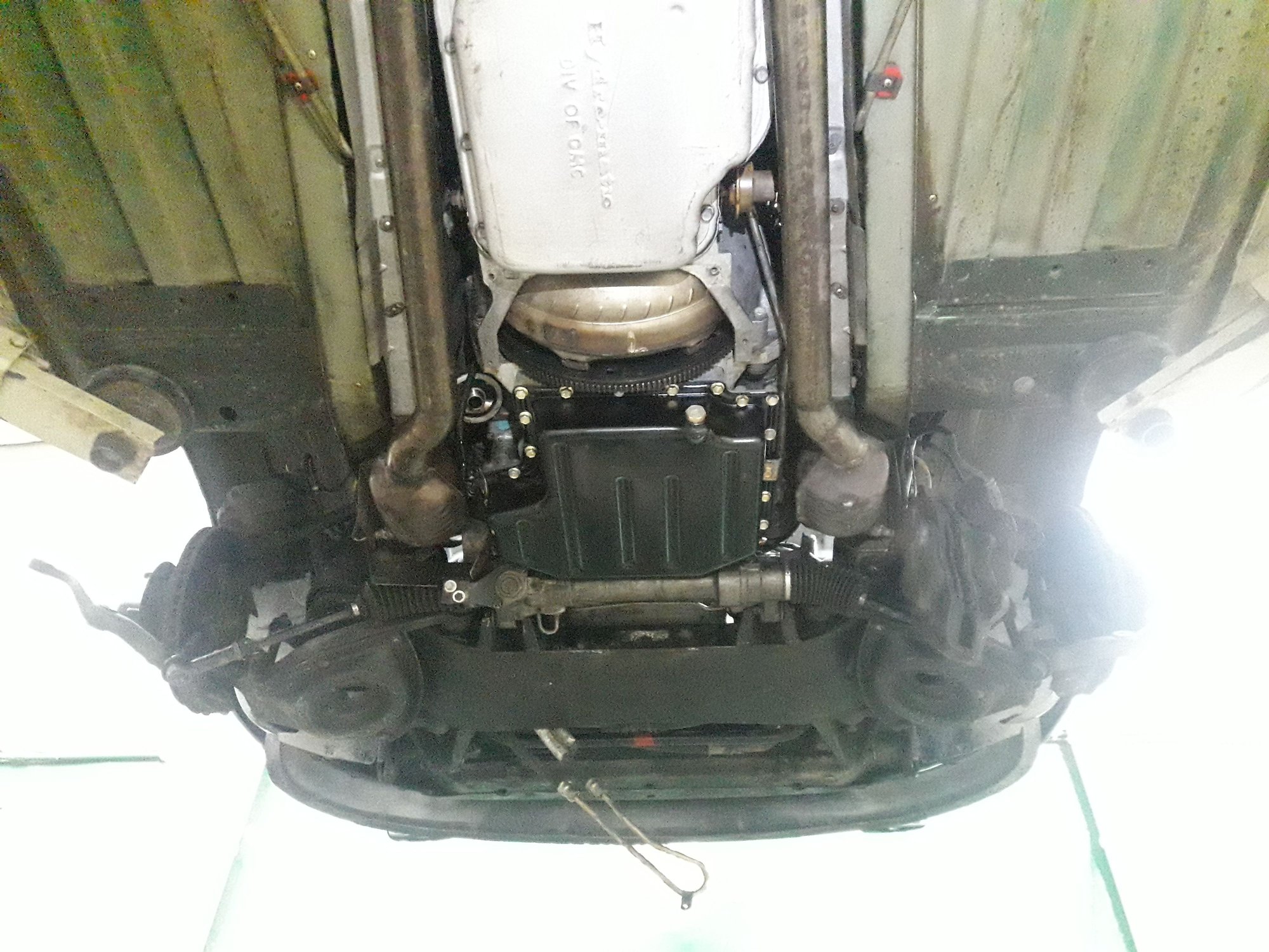

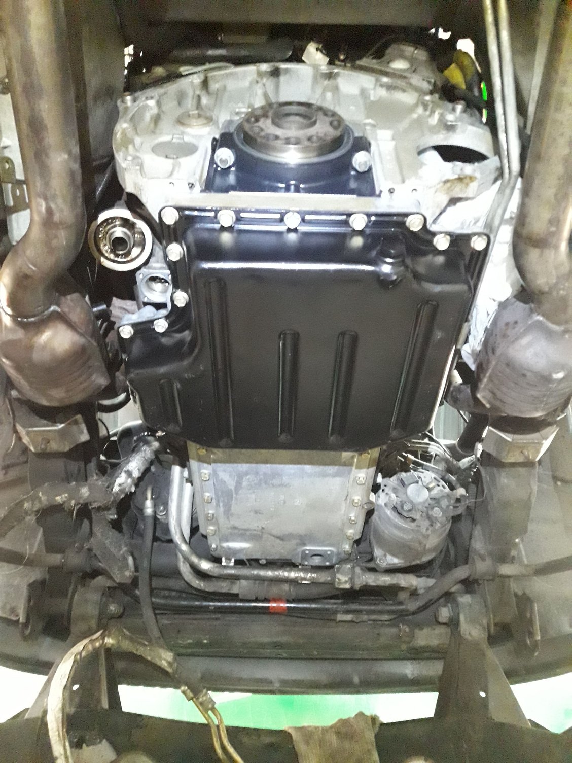

My friend started replacing gaskets oil pans and rear oil seal today.
I shooted some photos.

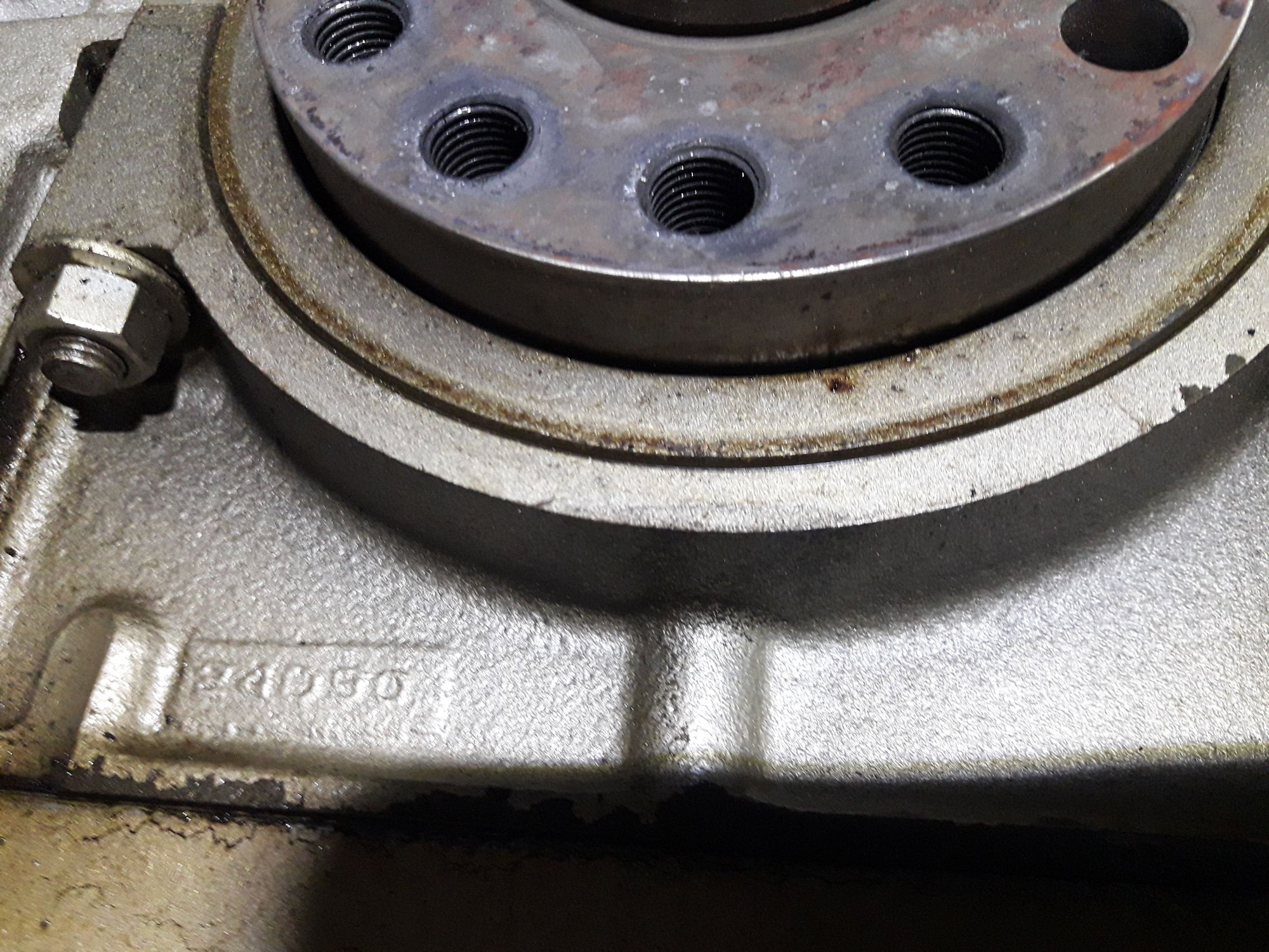

Oil is clean and licking not visible. But bolts have drops of oil.
When we removed the transmission and driveplate all become clear.
Rear main cap sealant is leaking.
Not so visible but leaking.
We are so tired. See you tomorrow!

Those snaps look like the later engine, as in 1989 onwards. That looks like the full circle rear main seal, which replaced the rope style.
I doubt the rope seal can be replaced, mainly in the block, with the crankshaft in place. The "sizing" required of a new rope seal, with the specified tool, has the crankshaft elsewhere.
Oil leaks from the side of the main cap and the block are becoming common. Removing the rope style, and resealing that cap, EASY, but DONT touch the seal. Honestly, rope seals themselves rarely leak, its the cap to block that leaks.
I have doubts about that full circle seal with the trans in place, as that seal is knocked into a ledge created in the block and cap. OK, the cap can be removed, and sealant applied to teh face and sides, but holding that seal in place on refit, dunno. This situation in the snaps would be simple, as the trans and flex plate are missing. Standard situation for seal replacement if it were leaking.

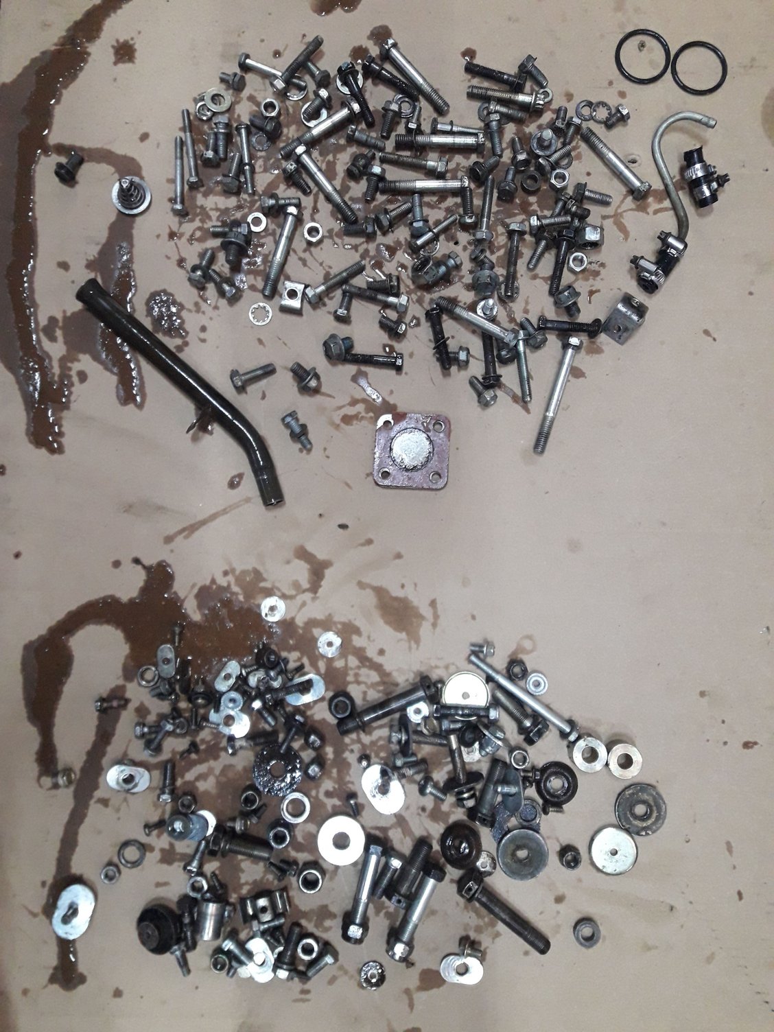

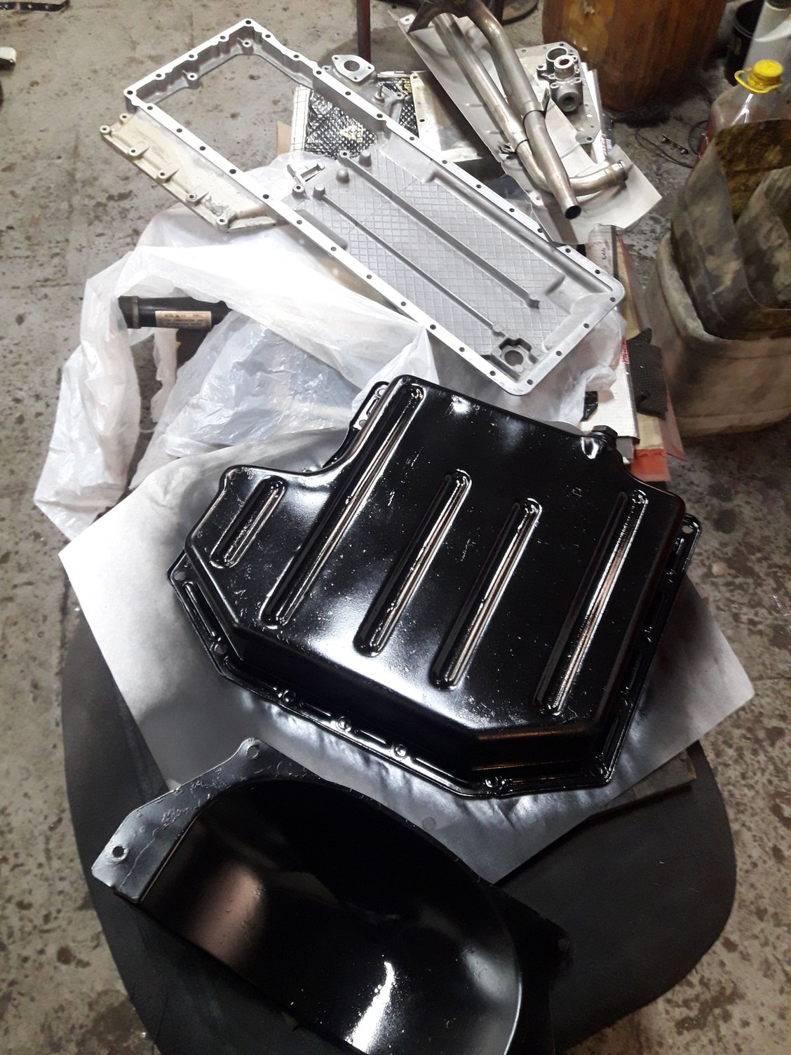

The whole day was spent washing parts.
And painted.
Heap of bolts and nuts are ready for cadmium plating.
Just washed
See you tomorrow!

Third day!

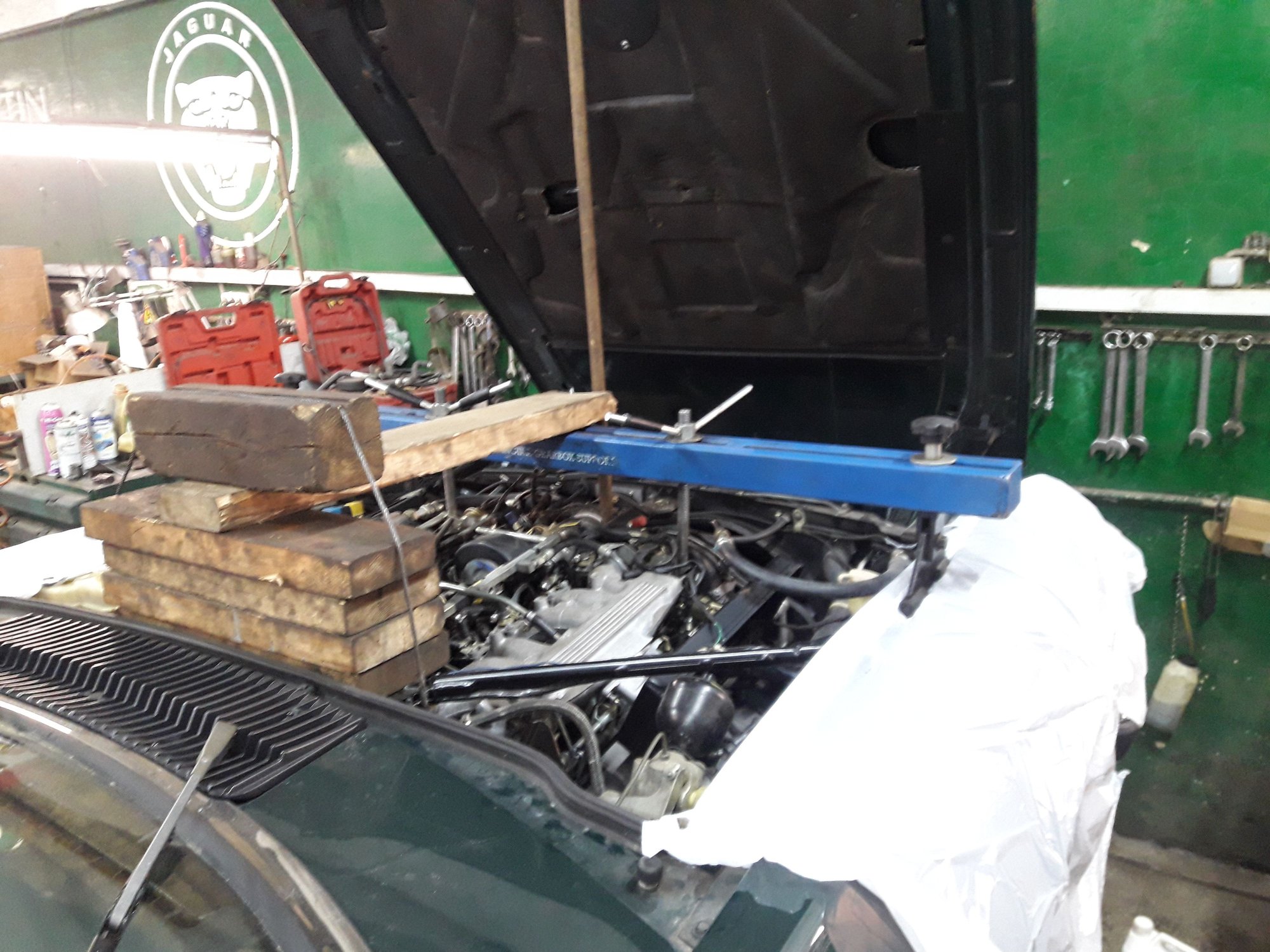

That's how I hung up the engine.
My chemical man worked all night.

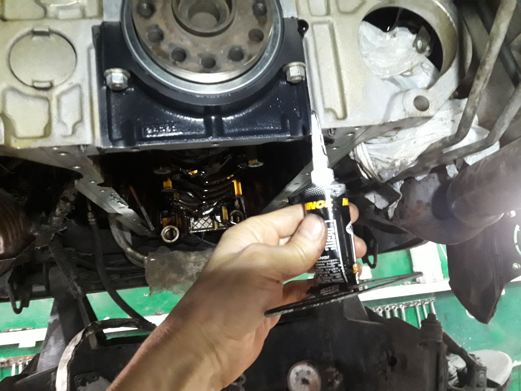

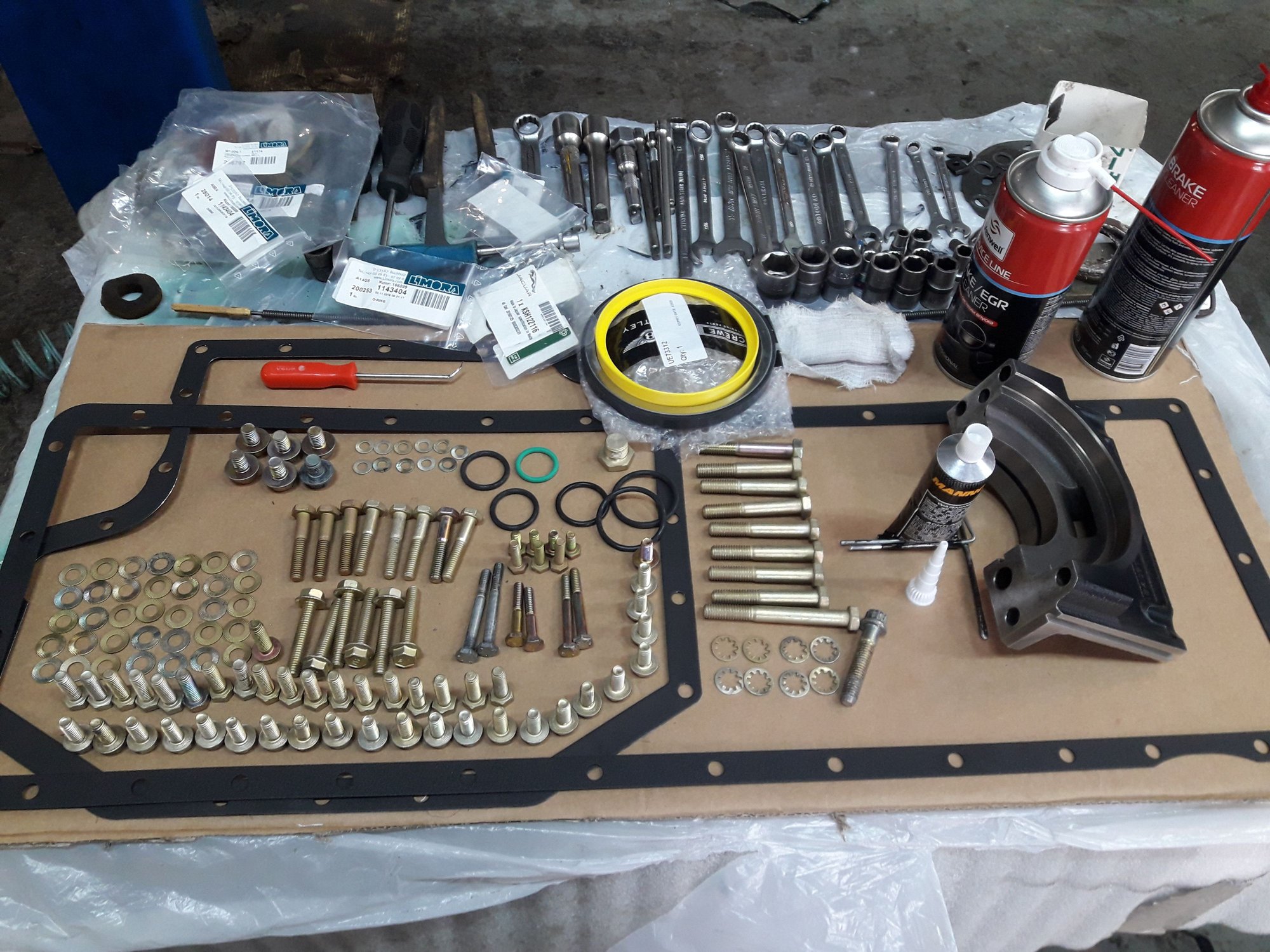

Original gaskets, "0"rings, Bentley rear seal. This is the only thing that never leaks on a Bentley!

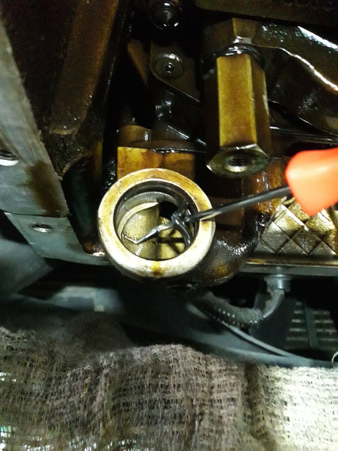

Pumped under pressure sealer

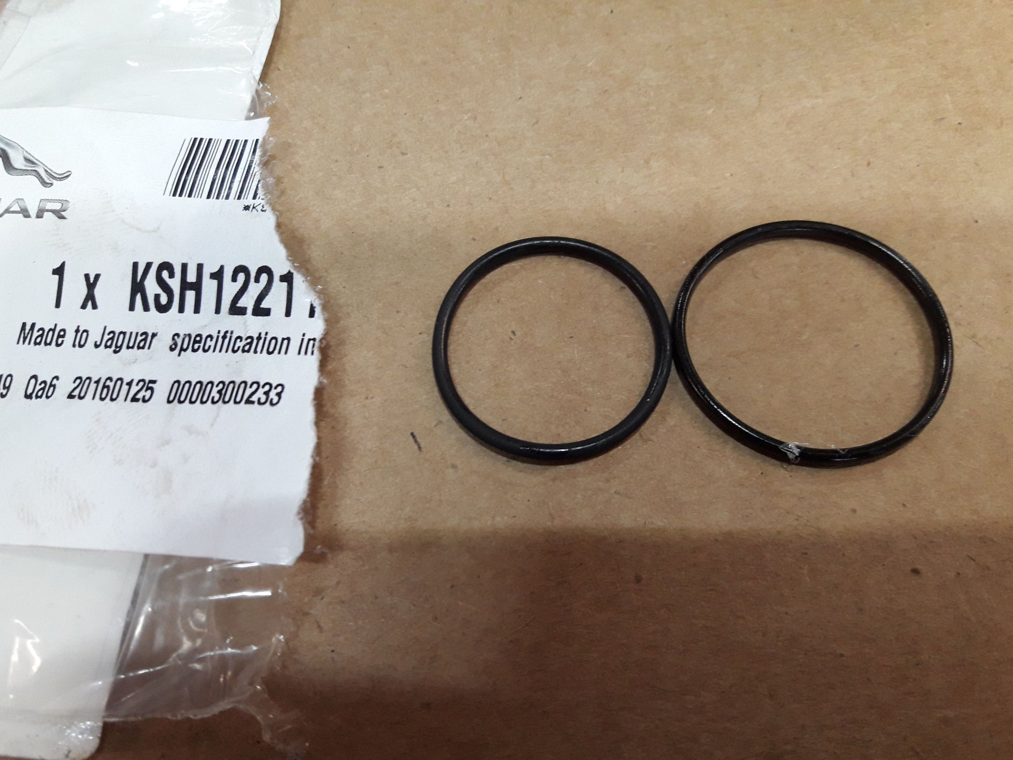

New "0"rings to prevent internal leaks
One ring on the pressure pipe was like plastic.
Problem was with ring on the sunction side .
Right is old, left is new
I found a new one the right size.
Thank you to our friend how to check the lower pan. All is on the right place.
That's the end of the day. And then we need spare parts. Anti roll bar bush And engine mounts. That'll be tomorrow.

I simply went to the local bearing/seal supplier, and got the Viton spec in the size needed, NOTHING special at all, its just an o/ring.
Well found on those o/rings, sadly, they are the weak link in an awesome system.

Originally Posted by VancouverXJ6
So a bentley part is s crossover for that big rear seal? Whats the part number?
UE73312
Bentley's rear oil seal

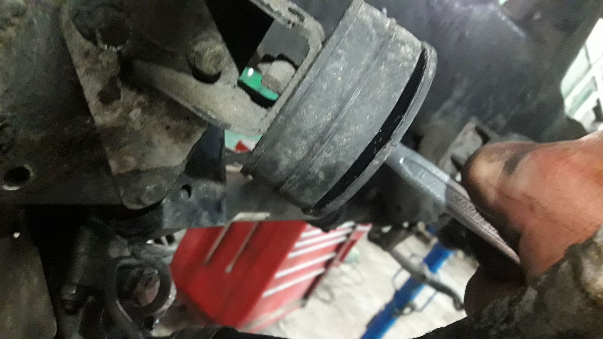

Today I received the engine mounts and antiroll bushings.
I was able to put gearbox and secure front suspension.
Is tired!
