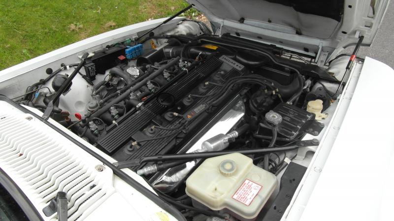

You can get a lot done with job patience and elbos grease. Here's a pic of mine from back in the day

That is Beautifuuuuuuuuuul.

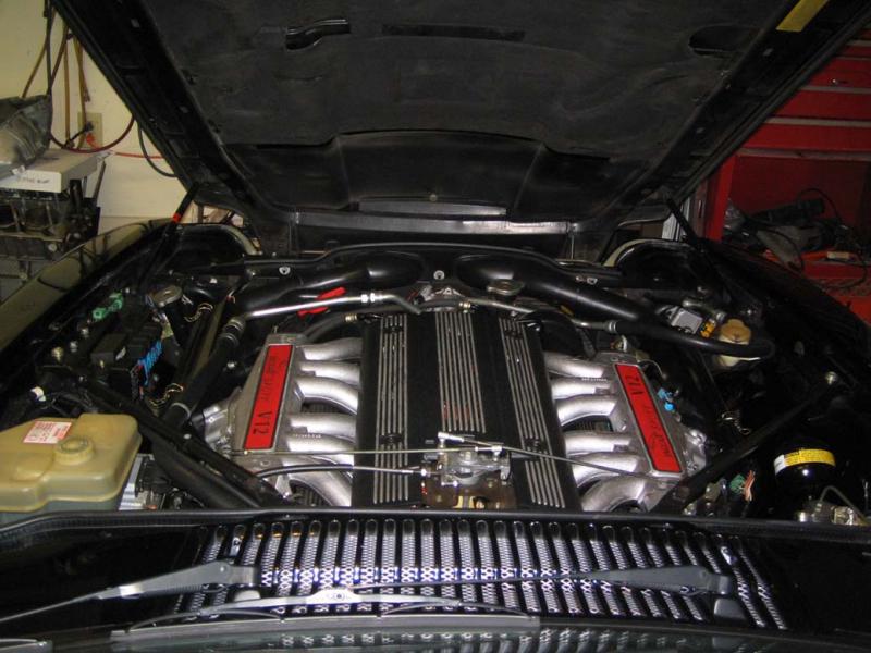

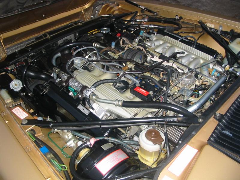

Just weak water hose pressure, and elbow grease...
Attached Thumbnails Washing the motor-eng2sm.jpg   Washing the motor-engsm.jpg

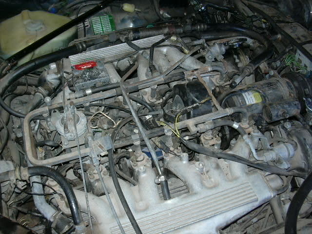

Jeez guys, do you actually drive your cars?
Mine looks like a pigsty.

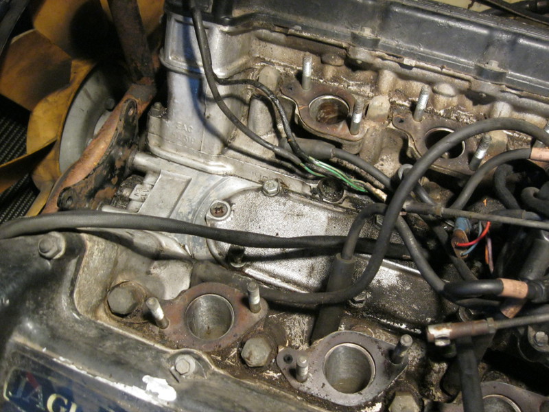

This is the result of about 30 minutes with a toothbrush, some de-greaser and a rag. While it is tedious, the reward is nice and shiny, with no concern about where water may have accumulated from a pressure wash.
It's a cross between dental work (tight spaces) and an archaeological dig. The second photo shows something stamped into the block. This would be at the extreme from of the engine, just below where the a/c compressor was mounted. Anyone know what it signifies?

To be fair I haven't had a chance to attack the engine yet as I'm still trying to sort out the overheating problem (replacement radiator on the way).
I will print off those gleaming shrines to engineering excellence and stick them on the garage wall to provide some inspiration!
The 4.0 litre one is in much finer fettle though.
