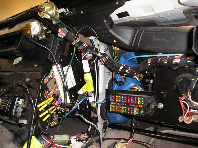

I'm not experienced in this area and was hoping others would jump in. My guess is that you have a vacuum leak or solenoid working intermittently. We'll need to know how far you are willing to go yourself. See the photo--dashboard passenger side and centre dismantled to get at the parts. Ignore the yellow circles--the photo is not mine. I think you need to look at the two gold-coloured solenoids at the top left of the photo, and the vacuum lines attached to them.
