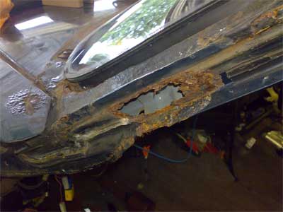

rgp's Avatar
rgp
Posts: 1,592
Likes: 439
From: S.E.LONDON
Worst case under the screen side trim, I have seen mainly on facelifts but its a jag thing
