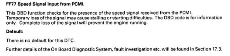

FF77 is lack of a speed (RPM) signal from the ignition computer into the fuel computer. The description below is from the fuel computer codes. PCMI is Powertrain Control Module Ignition.
