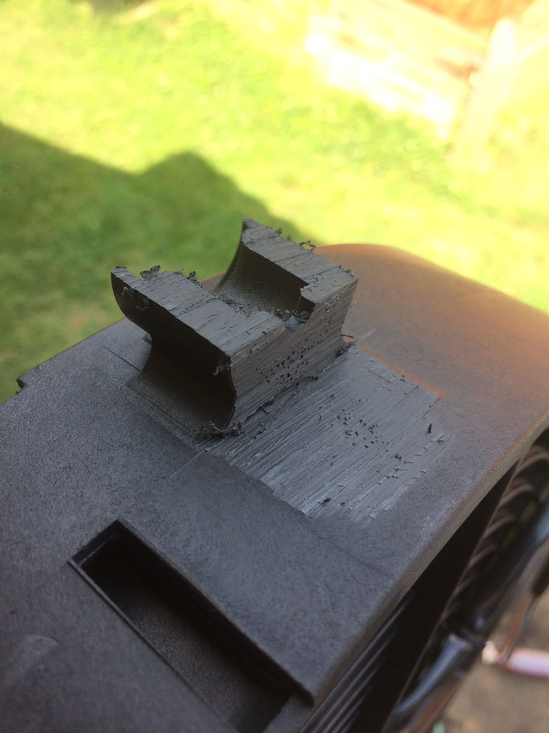

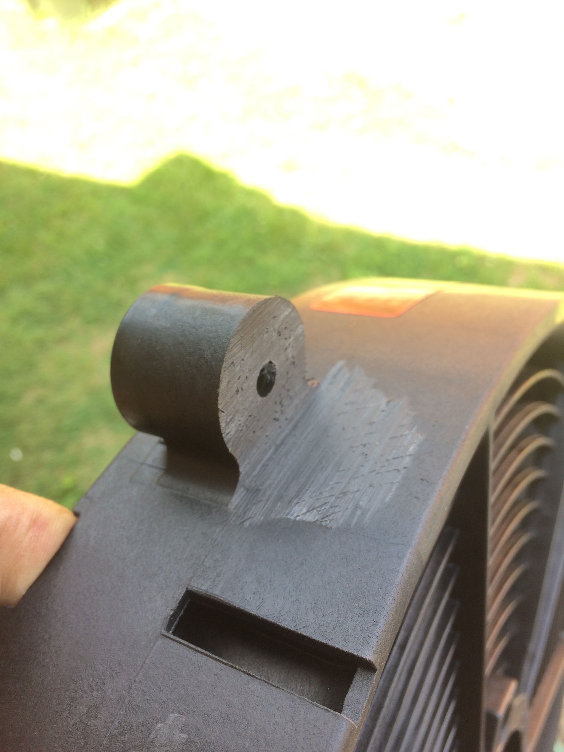

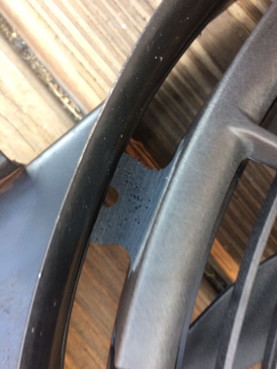

I'm using the Derale 18217. I did have to trim the mounting ears to fit it inside of the OEM shroud. Pretty simple to mount this one, but definitely not out-of-the-box.
Removed the front half of the ears to make room for a rubber eFan-to-Jag-shroud air seal.
Cut it to height to fit snug within the Jag shroud.
It is a press fit into the shroud and 4 #10 x 5/8" Stainless Phillips head screws go through the shroud and into the mounting ears to hold it very firmly in place.

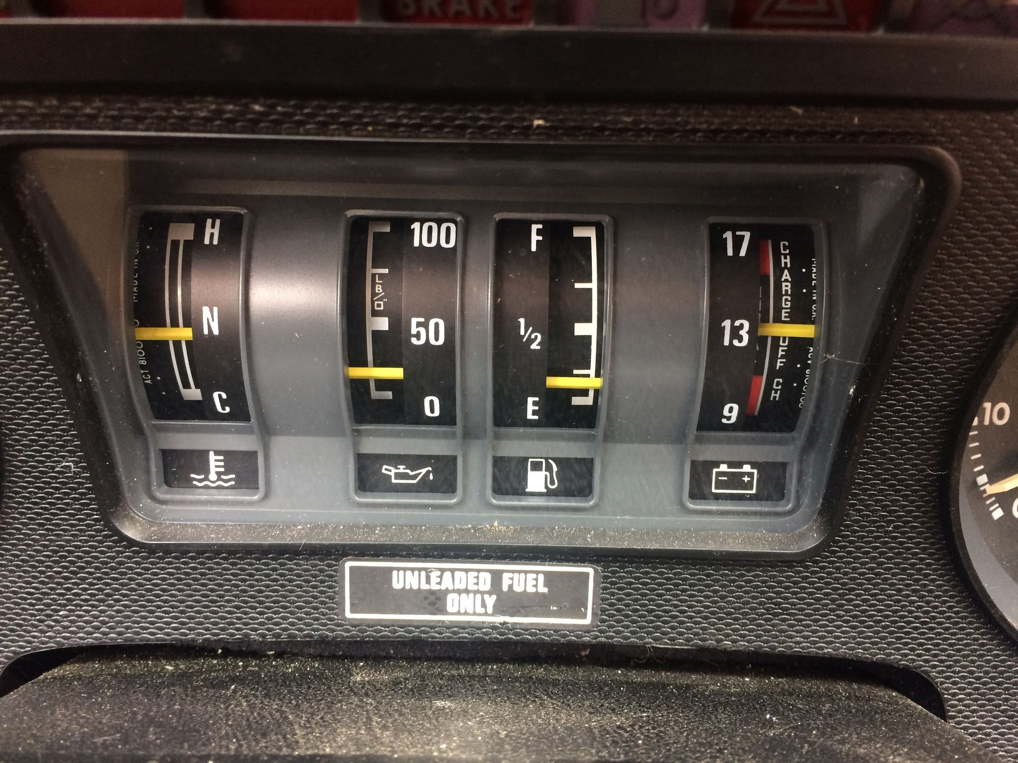

Dead steady at the lower edge of the "N". I run 83C t-stats.
Temp gauge does not move from from this location. Stopped in traffic, cruising along, ******* it pretty hard, steady as a rock.

It stayed at this temp reading.
