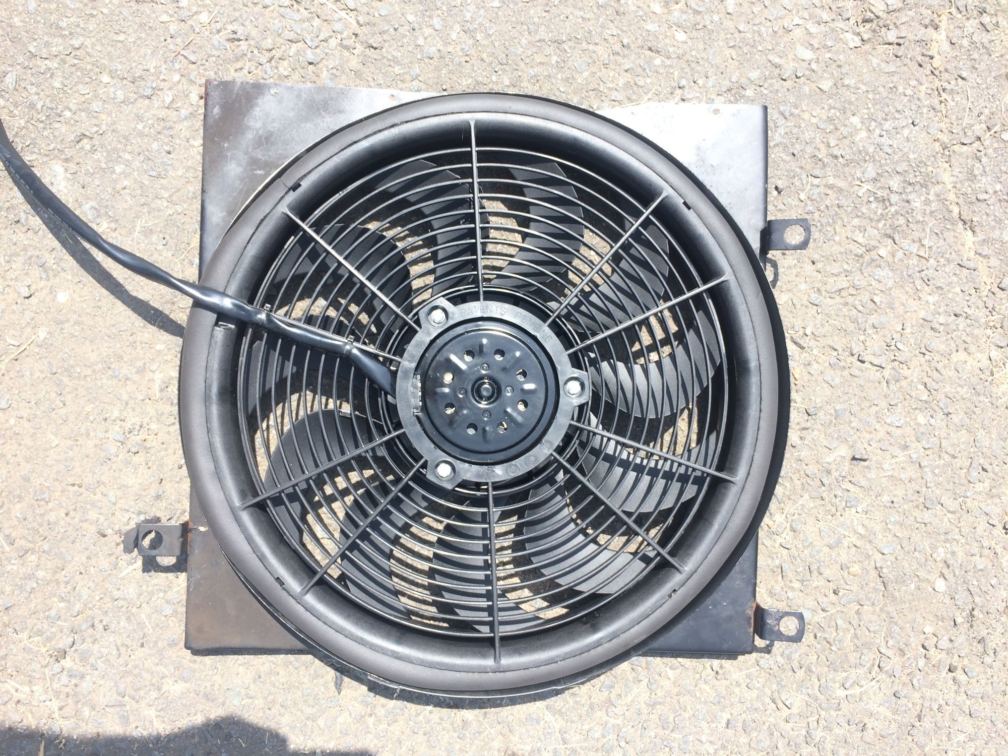

I also got the eFan mounted in the original shroud and installed. Not wired yet.

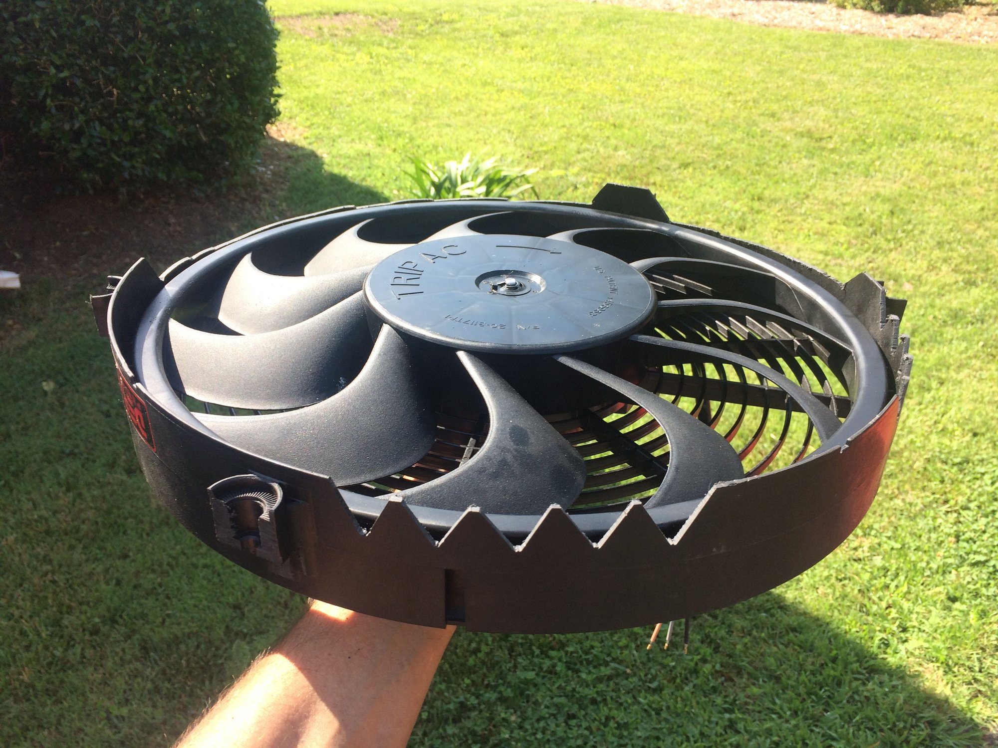

I'm optimistic about the fan.
It's a nice fit, it's also very quiet and you really can't hear it over the motor.
Comparison with original mechanical fan
Built-in shroud modifications to ensure the whole area of the radiator is drawn through. This fan sits very close to the core.
