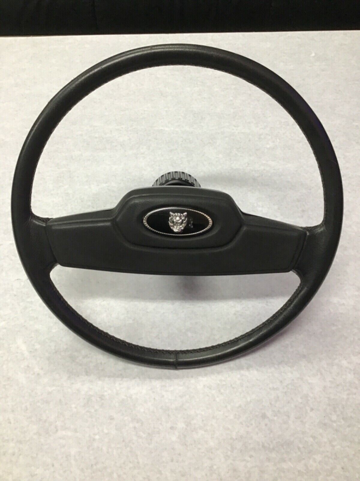

The '89 XJS used this nice wheel, thick rimmed, one year only
1981/82 - 1988 used this
I prefer Nardi wheels, personally
DD
