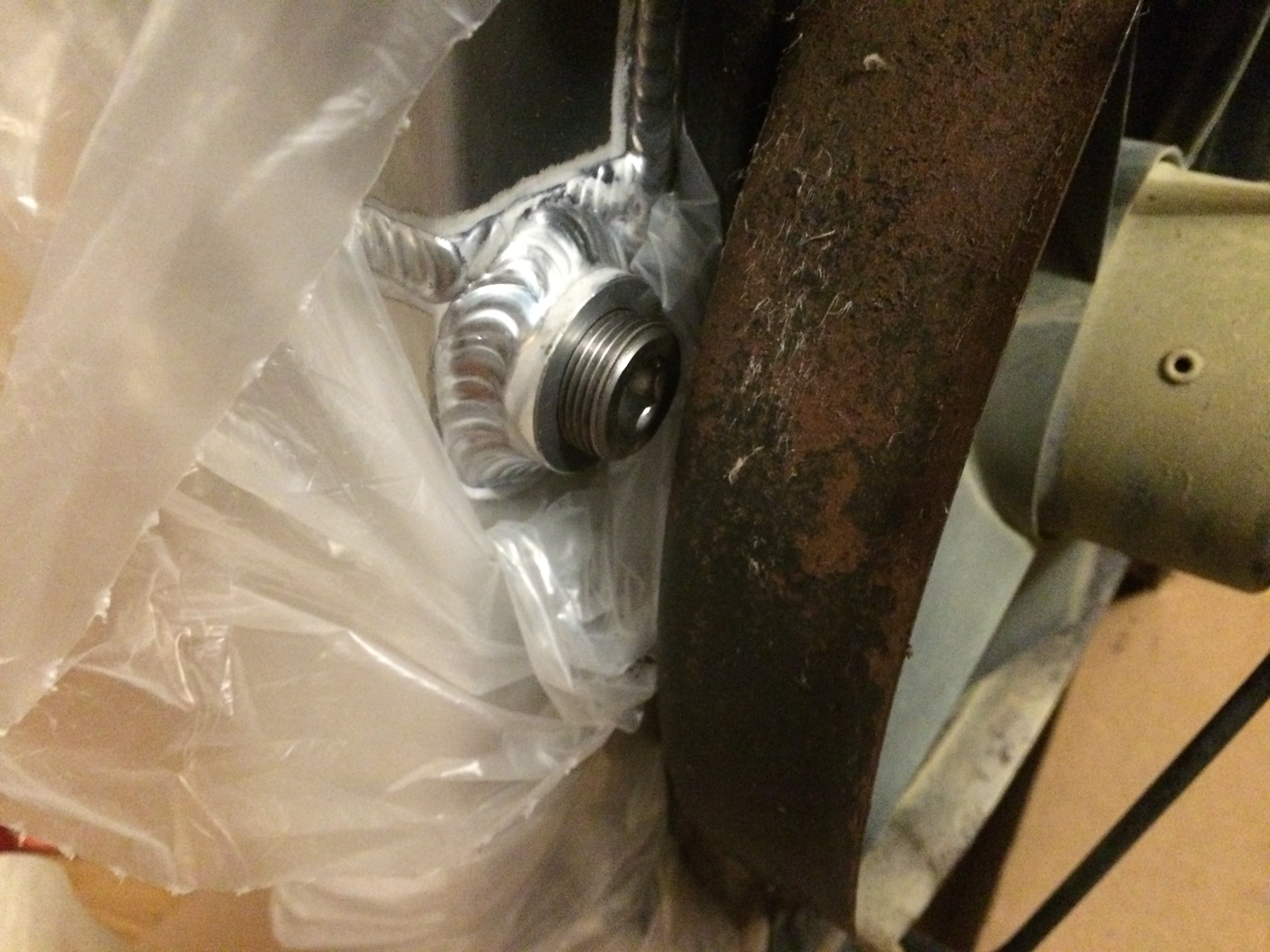

So, update:
The Wizard unit (even though I ordered for the V12 XJS with automatic transmission) apparently arrived with an extra hole in it for a temp sending unit. And, we're having trouble locating a suitable temp sending unit that won't cross-thread the hole (we just want to plug it up). Anyone ever run into this before and/or can suggest a fix?
Jess

Just ask Wizard the thread size and buy a plug and a fibre washer to seal the hole? Some later cars had the electric fan temp sensor in that hole, I believe.
Greg

When I received mine, I had ordered a temp senor for it and the plug...
I could not use the temp sensor as the stock fan shroud did not give enough clearance for it
Jaguar XJS V12 Auxiliary Cooling Fan Switch Upgrade
now a lot of people here do not like this guy so I know that posting this link is going to rain some stuff down upon me... I never had any problem with him, ordering receiving paying or what ever...
I got that switch and the plug from him... the radiator too... that was shipped straight to me from Wizard Cooling... (I paid a little more than if I bought it straight from them but hey Knowledge is power and money)
I think you can get that plug from any hardware store... even Lowes...
I just wrapped mine w Teflon tape and tightened it up... OH I knocked everything (shroud) down to bear shinny metal and painted it all black
Attached Thumbnails What's the best solution for radiator replacement?-img_0846.jpg

Wanted to give a final update ...
We ended up needing to plug two different holes on this radiator, so "drop-in" is a term that I'd say loosely applies. I wish Wizard would ship the plug that goes on the top driver's side of the radiator with the order. It's a cheap little thing but it cost us almost two weeks getting this problem solved. The other one was much simpler to fix (I didn't even know it had been an issue until I picked up the car).
Having said that, the performance looks pretty amazing at this point. My car lived around "N" to just north of "N" for 3 years, except in the dead of winter. Running the A/C and sitting in traffic would easily get it 2/3 of the way up the dial.
So far, I've yet to touch the "N" zone at all. The car is holding steady around the 1/3 mark on the dial even with the A/C on. So while the radiation might not qualify as "drop-in," it definitely appears to do the job.
Jess

I wish you had posted that on Friday. I'm in the same boat in trying to find a BSPT plug. What did you do for the other M22X1.5 plug? I've sourced one meant to be an oil plug, as it needs to be low profile to avoid the fan shroud, but it will not be here for another day or two.

I'm going to claim ignorance knowing the difference between "BSPT" and "M22X1.5" (i.e., which hole is which); for the one positioned on the driver's side at the top, we finally had to get it directly from Wizard. Nothing we ordered locally had the correct thread.
My shop was able to find some generic plug at an AutoZone or Advance Auto to fill the other slot. It may or may not have been from the list of Audi parts someone else suggested to me, they didn't say. Had we struck out on a source for either of these parts, our next step was going to be having a radiator shop weld/solder the holes shut.

BSPT is British Standard Pipe Tapered, which is an imperial thread M22x1.5 is metric 22mm.
Radiators or cooling systems should not use tapered threads as these need PTFE tape to seal them. I said this in a thread yeaterday.
The problem is 2 fold, these plugs are usually supplied with sealing washers, so if the tapered thread is too tight the washer will not seal, so the unsuspecting installer keeps tightening the plug damaging the thread in the process, or the washer seals before the thread is fully engaged. Both of these scenarios have the potential to blow the plug out under pressure.
