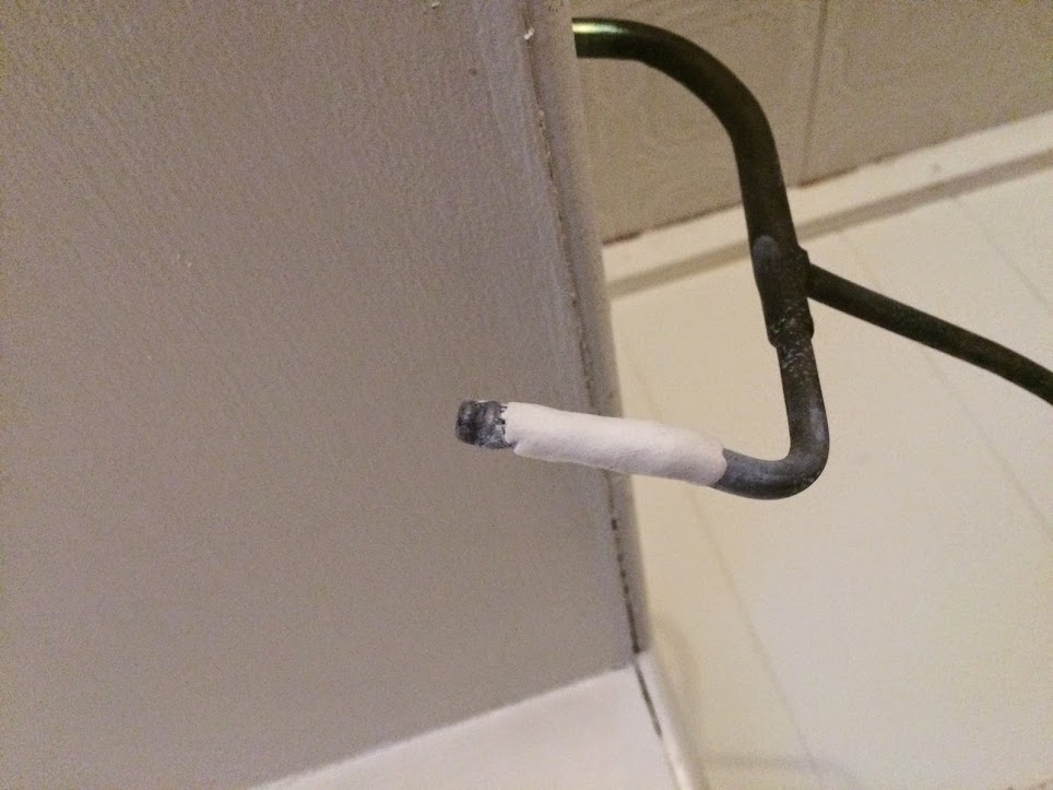

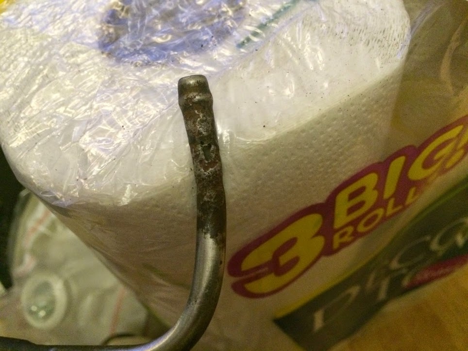

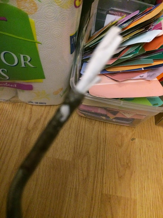

Default vaopr pipe repair
ok hard to se the holes...
so paper rolled up and placed in pipe so I can epoxy pipe with High temp epoxy, also you can see the hole/s better
when done I painted the whole thing in a gold copper colour and it looks great and works great too...
