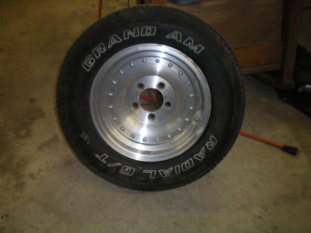

So last weekend I spotted four Chevy rims on Craig's List that I thought would fit the IFS. They are 14 inch, with a 4" set back. They were a GREAT deal, including tires:

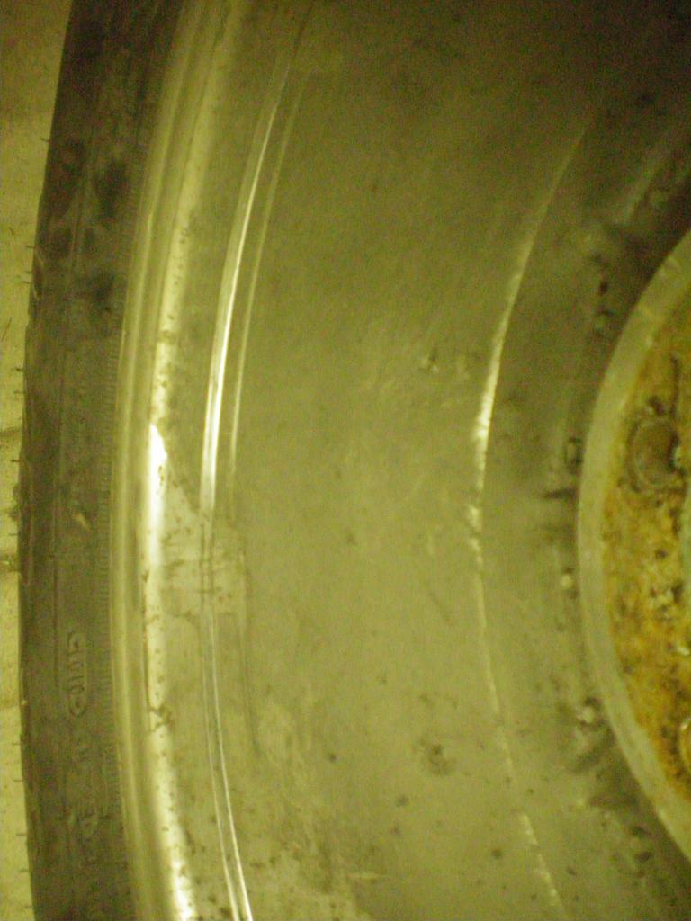

When I mounted the wheel and tried to spin it, I discovered a slight drag. Took the wheel off and this is what the inside of the wheel looked like:

The caliper is just BARELY dragging on the rim right where the casting seam is along the center of the casting:

Would I be playing with FIRE by grinding a 1/16" off the caliper to provide clearance? Would 1/16" be enough? The guy I brought eh wheels from said he'd take them back if they didn't fit. They were a screaming deal at $200 for the set, so I'm more than a little disappointed that they don't fit. Suggestions/opinions?

Originally Posted by DougofMontna
So last weekend I spotted four Chevy rims on Craig's List that I thought would fit the IFS. They are 14 inch, with a 4" set back. They were a GREAT deal, including tires: When I mounted the wheel and tried to spin it, I discovered a slight drag. Took the wheel off and this is what the inside of the wheel looked like: The caliper is just BARELY dragging on the rim right where the casting seam is along the center of the casting: Would I be playing with FIRE by grinding a 1/16" off the caliper to provide clearance? Would 1/16" be enough? The guy I brought eh wheels from said he'd take them back if they didn't fit. They were a screaming deal at $200 for the set, so I'm more than a little disappointed that they don't fit. Suggestions/opinions?
Opinions? Why would anyone want to run a 14" wheel on an XJS? $200 screaming deal? Doesn't seem to be such a good deal if one has to grind on the caliper to get it to " work". Sorry, not to sound harsh but I'd take those back and pocket your $200. Recently a tire store in Ormond listed a set of 94 16" XJS wheels in superb condition with a nice set of 245, 16s on them...no mods required for ....you guessed it, $200.

The OP is running a jag front end under a Ford, not XJS but in any case jags were at least 15 inch wheels so I doubt any 14's will work without some sort of clearance issues.

If it is literally a 1/16 off each of the top corners of the casting in the pic, I would not have thought it would matter. Up to you though...

1/16" ?
I agree with Greg
Sorry, would have helped if I'd read the opening thread, I just assumed ( I know, I know) it was an XJS. If running a modded undercarriage under a early ford I wouldn't consider altering the calipers a big deal. Big thing with these cobbled up rods is you have to make sure all the geometry is correct and any " mods" keep the car road worthy and safe. Good luck with the venture.

I agree. I would trim the calipers.

I would just get the motor tool out...
not being on a jag no one will care that you modded it as the whole car is your work...
Hopefully your work of automotive art that expresses what you want and makes you happy!
