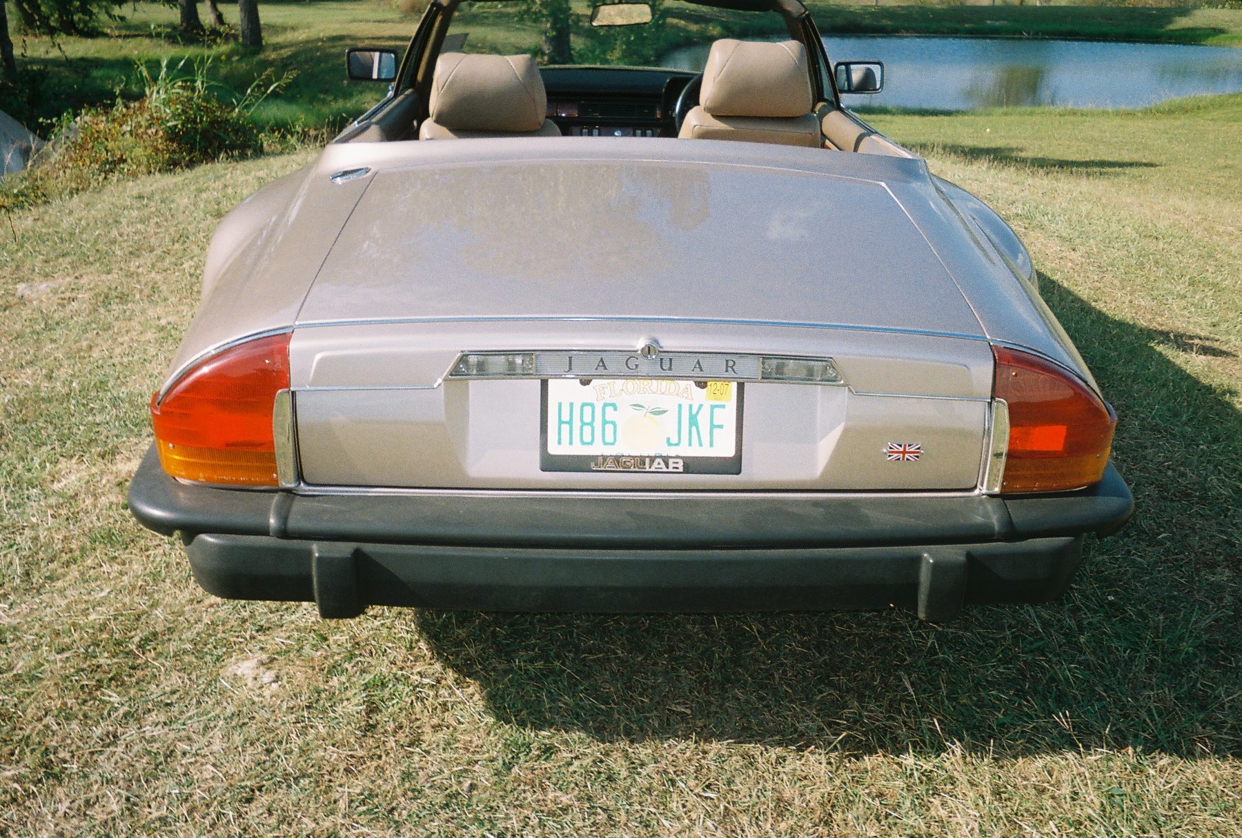

i dont think any thing wider than 245/255 will fit with factory wheel arches!
i have 295/35/18 rear tires and and had to wide body the rear flares about 4" each side(lot of work).
Attached Thumbnails Widest rear tires on XJS-r1-07368-023a.jpg   Widest rear tires on XJS-r1-07368-018a.jpg
