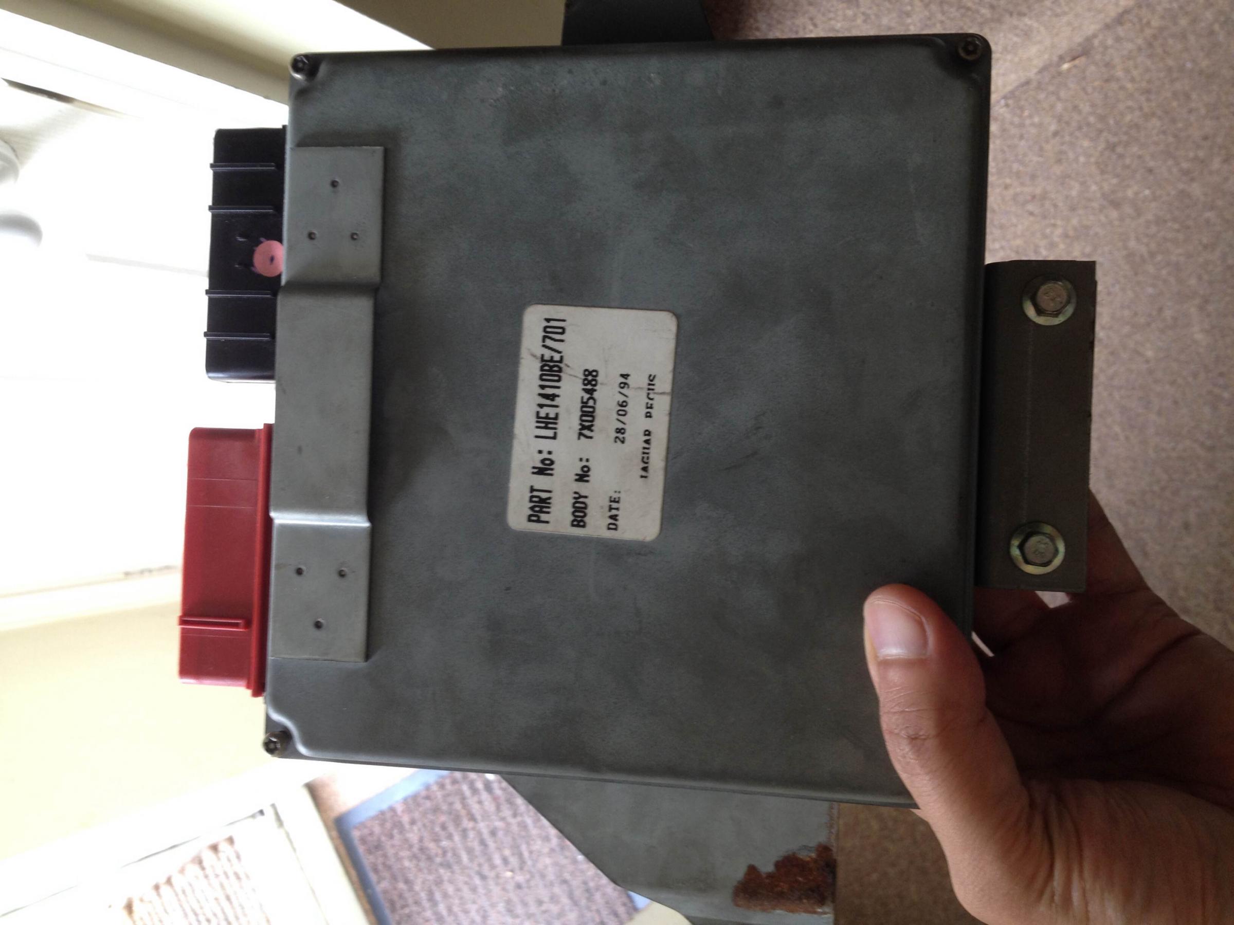

Will X300 ECU work in 94 AJ16 XJS?
My beloved 1994 Facelift XJS (UK model VIN ...19594, AJ16 engine with Auto box) has gone from spluttering to now not starting after little use over a snowy winter. Mechanic has tried everything else for the weak spark and suggests a new engine ECU.
A replacement engine ECU (pic attached model LHE1410BE/701 date of manufacture 28/06/94) seems impossible to find!
Does anyone know if a Lucas 15CU part DAC11505 from an 02/94 XJS or an X300 ECU (which look similar) part LNA1410GF/316 would work?
Any other suggestions? Have changed coils, O2 sensor, crankshaft sensor, cleaned ECU contacts.

If XJ300 have immobiliser and XJS do not then maybe an X300 ECU can go into XJS but not the other way round?
The car has the standard Jaguar security system with remote key fob and alarm but no transponder chip in the key. Not sure if it has an immobiliser.
What about whether the older Lucas 15CU ECU would work?
Anyone out there got an LHE1410 ECU to sell or able to diagnose and repair them?

I've now sourced an ECU part LHE1410AG/601. It's had 2002 and 2003 PROM upgrades and been rebranded LHE1410AL.
How does this differ from my original ECU LHE1410BE/701 ? What's the difference between the 601 and 701? Does it matter that I have a UK RHD car and it's from an LHD US car?
IDK if anyone has really documented the software variances or hardware variances (if there are any) between ECUs. There ARE sensor differences on the emissions side between some cars, and USA cars don't have an immobilizer to interface with unlike UK cars. If you put a USA ECU in a UK car, I have no idea if it would just ignore an immobilizer or not. We know that there has been on and off success swapping ECUs between X300's and XJS AJ16 cars, others have had problems.
Often ECUs are updated in a series, and newer ECU iterations are workable on older cars.

~Paul K.
E.g. from Jaguar Classic Parts for AJ16 cars (not 3.2L versions):
AJ16 ECUS
XJS
S (Spain?)
4.0 Automatic
TO VIN 221299
LHE1410AG601
LHE1410AH601
LHE1410AJ601
LHE1410AK601
LHE1410AL601
FROM VIN 221300, FROM VIN 221300 - TO VIN 222631, TO VIN 222631
LHE1410AH601
LHE1410AJ601
LHE1410AK601
LHE1410AL601
4.0 Manual
LHE1410AH602
J & P (Japan & Portugal?)
4.0 Manual
TO VIN 221299
LHE1410BG702
LHE1410BH702
LHE1410EC702
LHE1410ED702
LHE1410BH702
LHE1410EC702
LHE1410ED702
FROM VIN 222632
LHE1410EC702
LHE1410ED702
4.0 Automatic
LHE1410BH701
LHE1410EC701
LHE1410ED701
FROM VIN 222632
LHE1410EC701
LHE1410ED701
A (Americas?) 4.0 Auto from 221300
LHE1410BH703
LHE1410EC703
LHE1410ED703
C (Canada?) 4.0 Auto
LHE1410BH704
LHE1410EC704
LHE1410ED704
From Vin 222632
LHE1410ED704
N (N. America?) from Vin 221300
LHE1410EC705
LHE1410ED705
Brazil, N
LHE1410ED705
