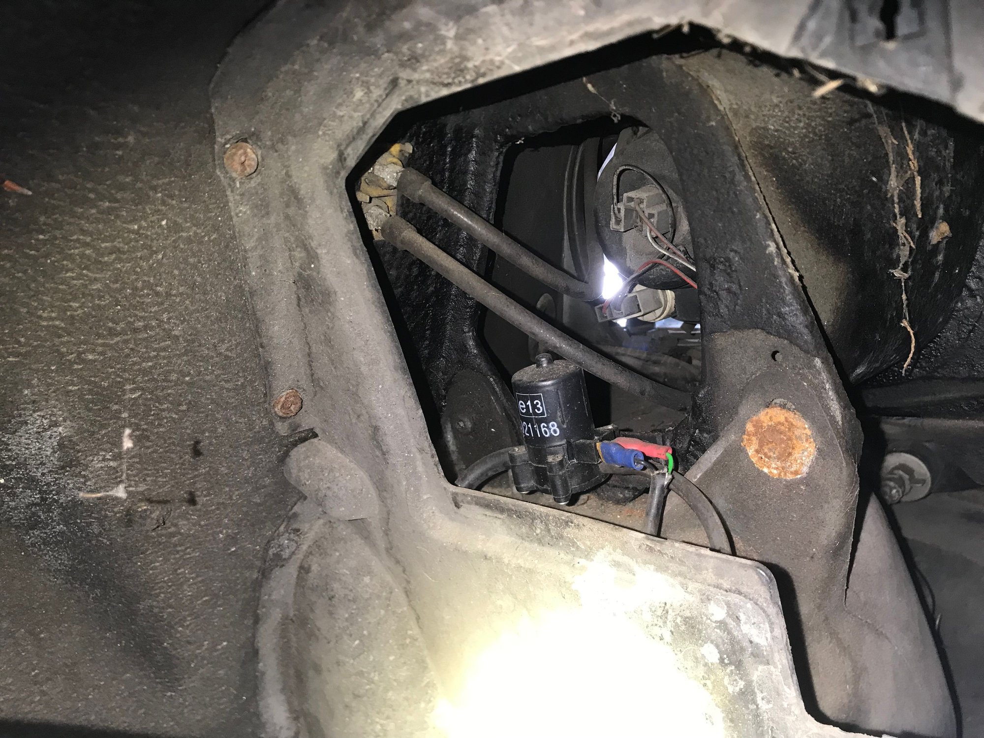

Am I right in saying the pump is pictured below? I’ve taken off the access cover in the RHS wheel well. If so I’ll run a voltage check over the wires.

Most likley the pump, which that looks to be. Check the loom connectors for voltage when the washer switch is pressed to be sure it is the pump that is the problem.

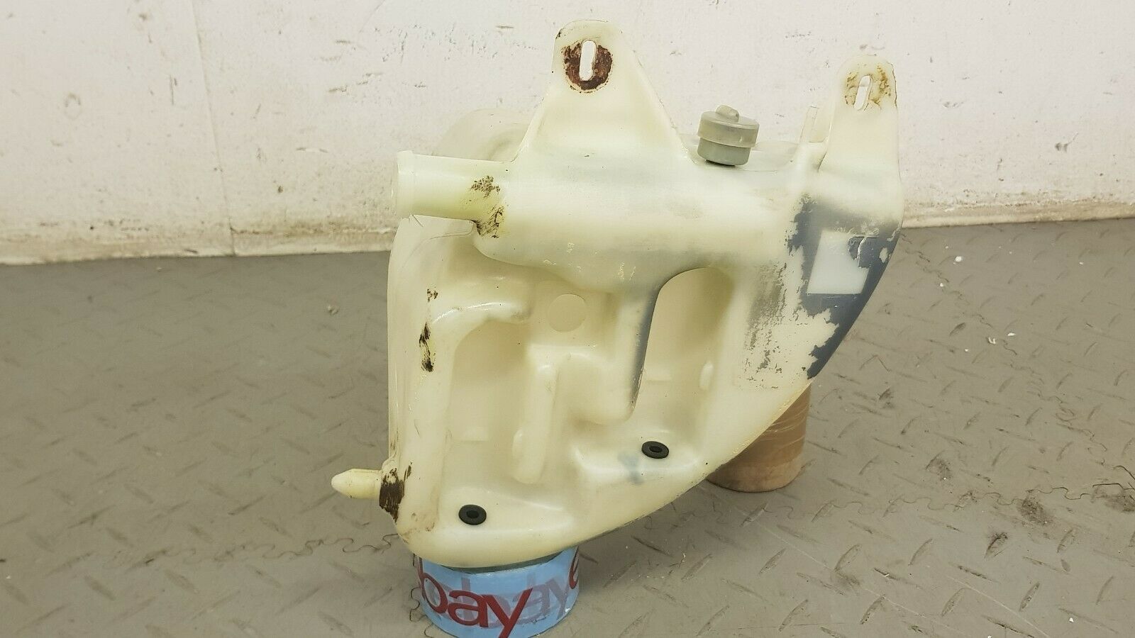

That doesn't look genuine Jaguar to me - both pumps should be housed in the bottle itself - they are not self priming (although they will a few times) so if you don't have a good one way valve in place the water may be running back, running these pumps dry too long is the end of them.
That tank looks the same as one I have on order for a refurb - there should be a vent where that pump seems to be - I found the pic below on a certain auction site - if you look just above the roll of tape you will see two black rings and recesses - this is where the pumps go. I believe you are suffering a botch it and scarper solution by person or persons unknown.

What you see in your image for sure is a pump, I would expect to find a no return valve below it where it draws from, I'm not familiar with the relocation proposition. My information for this is based on upgrading the cooling system on my own vehicle which is an 87 so I had to source this tank from a facelift vehicle, I had to do quite a lot of digging to make sure I got all the correct parts.

Thanks again for this info. I had a play about this morning. My tank is located in the wheel arch too beneath the pump and you are right, the pump pictured looks an aftermarket add on or at least a replacement unit at some point. The tank looks different to the picture you sent but does have one pump in it which I assume is the headlamp pump as the one in my picture certainly runs the windscreen.
I disassembled the pump, have it an oil and checked it over, all seems ok. Plugged back in and it runs ok but didn’t push any water through it. It’s not obviously not gravity fed bring above it nor is it self priming. I’m unsure how to prime it but resorted to syringing water into the inlet pipe and the pump itself. This ran briefly before it started running dry and stopped working again. It seems you are right, it doesn’t like being ran dry, gets hot and stops working.
it’s currently having a bit of a soak in wd40 but I’m unsure how I would fully prime the system correctly so that the same doesn’t occur. I can’t find a one way valve above it all or where the outlet pipe runs through the engine bay.
