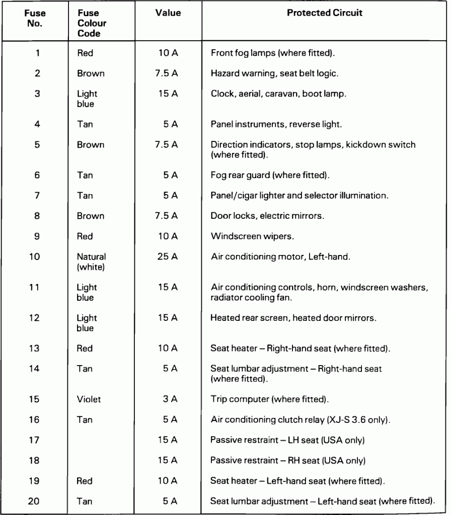

i bought a xjs v12 and it is missing the drivers side fuse cover, would any one have a picture of the fuse ratings and what there fore that they could post on here so that i could see. my car has 2 rows of fuses not the glass fuses the plastic coloured ones. or if anyone knows where i could pick up one second hand in black thanks

you will need to source one from a parts car
this isn't an actual image because the real one has two columns, but you should be able to deduce based on what fuses you do have what number they correspond with.

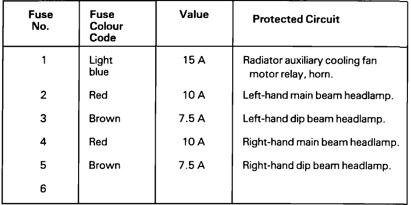

the small one on the drivers side fender?

As you can see number 6 is blank.
Seems weird? Probably the same fuse block used on a different jag that does use it. no reason to make a 5 fuse block for an XJS when the XJ6 uses a 6 block that fits just fine.

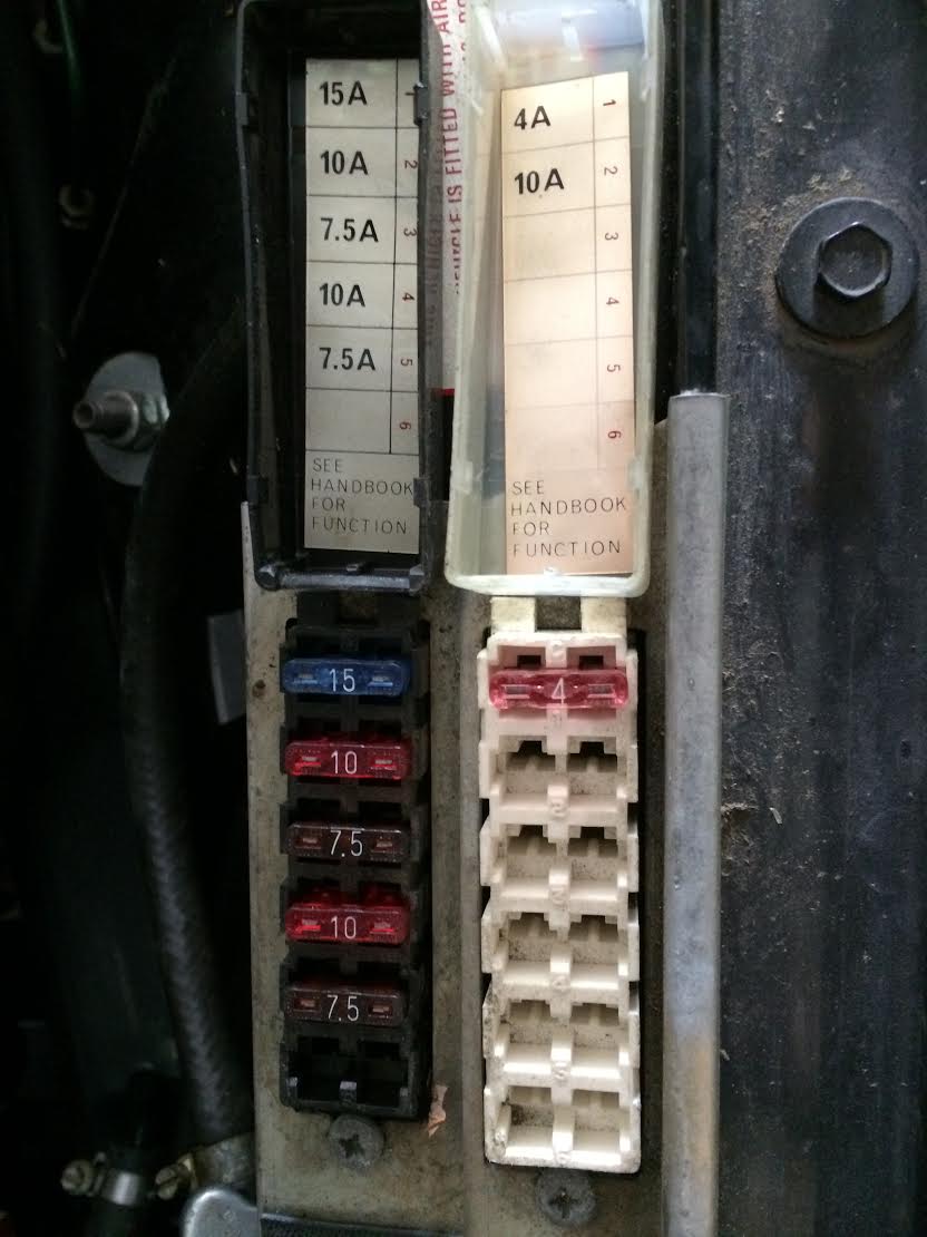

I'm really not trying to hijack this thread but here's what I've got. You can see the number two slot on the white fuse block is empty where it says there should be a 10 amp. Know what that one's for?
i don't have my books on me or my car, so I am just on all-data.
what color wires are running underneath it?
