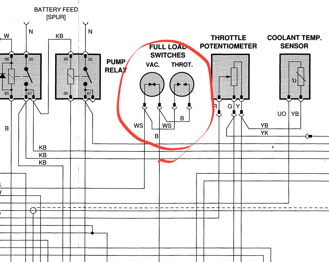

Is the voltage to these switches supposed to be 12 volts? 5 volts? Mine is 3.7v which I'm sure isn't right.

Memory??, 12V.
I dont have a V12 anymore, so cannot check for sure.
Greg will check his car, kindly, for us when he wakes up.

I think this is right because I used to use the 12v as a source when I use a timing light. I also noticed my turn signals don't work which is on the same fuse as the enrichment power, I believe.
The enrichment switches are not fused.
However, the kick down switch, which is on the throttle cable right next to the throttle capstan, is fused with the signals and brake light.
The enrichment switch (mounted on the capstan) and the kick down switch are often confused as they look alike and are mounted near each other

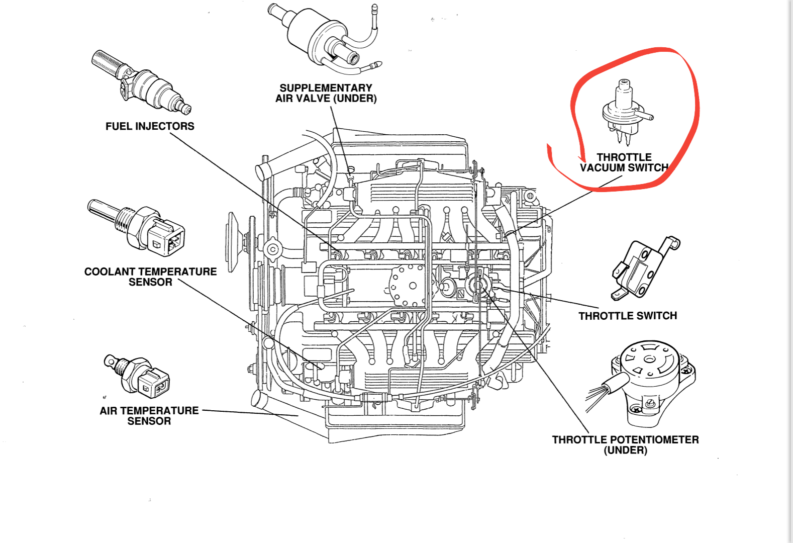

Thanks Jeff... I will take some readings off the leads, take a look at it, and maybe hook it back up... If vacuum driven I guess I will have to figure out accessing another port on the rear of the A side. About the vac. Some ports are a little bigger than others. Does it matter which sized port? Does the rate and amount of vacuum in that instant make such a difference?
And, which area would I find the wiring info in the ED? In which category?

These and this, I guess... 25.1 in the 1990 ED...
Call me an old timer if ya want, but I never hit my throttle so hard, ever. Fear of sumpthin breaking loooose! Haha

The wires for that Blue/White, AND the Capstan Micro Switch are probably tucked down near the heater tap.
The Blue.White will change fuel mixture on light load even, It is Vac reliant to keep the contacts OPEN, and as the vac drops to a predetermined value, the contacts close, and away she goes, without stumbles etc.
The Capstan Switch does EXACTLY the same, but at "about" 2/3 throttle opening.
This all protects the engine from LEAN MIXTURE in any given scenario.
For the purposes of the enrichment switch, no, I wouldn't think so.
The vacuum switch actuates at [something like] 3" of vacuum...which is pretty low. It's not a situation where instantaneous vacuum response is needed
