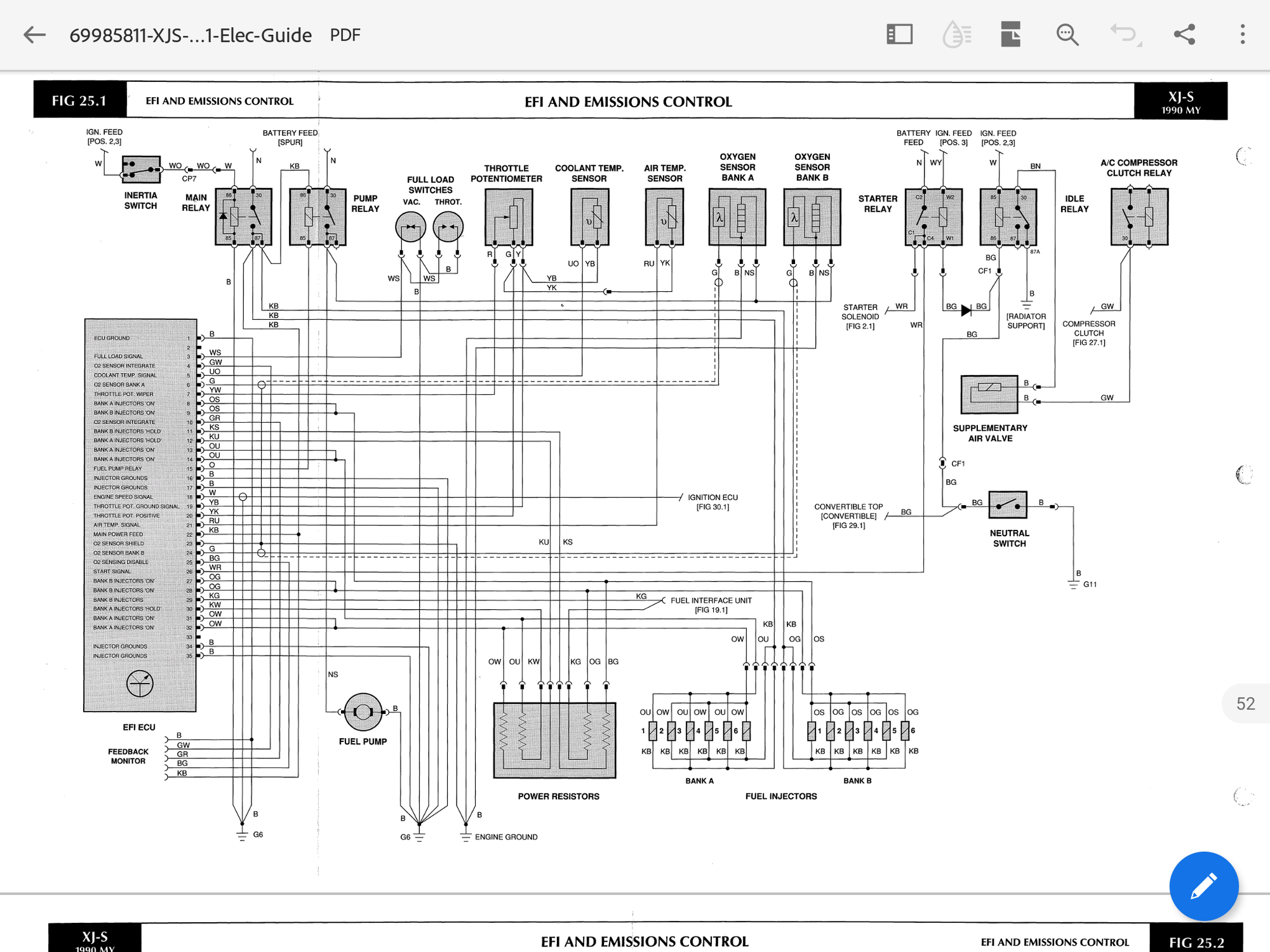

Originally Posted by JayJagJay
These and this, I guess... 25.1 in the 1990 ED...
Call me an old timer if ya want, but I never hit my throttle so hard, ever. Fear of sumpthin breaking loooose! Haha
thanks for the picture. Can you expand it to show the whole wiring harness diagram?
You really need the S57 Wiring Guide.
PM me your email address and I'll send it to you

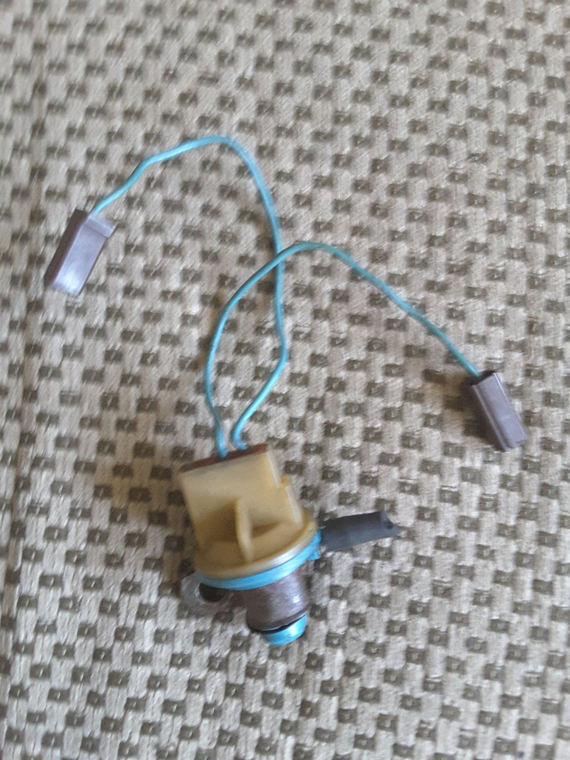

Originally Posted by Grant Francis
Easily done I suppose.
The wires for that Blue/White, AND the Capstan Micro Switch are probably tucked down near the heater tap.
The Blue.White will change fuel mixture on light load even, It is Vac reliant to keep the contacts OPEN, and as the vac drops to a predetermined value, the contacts close, and away she goes, without stumbles etc.
The Capstan Switch does EXACTLY the same, but at "about" 2/3 throttle opening.
This all protects the engine from LEAN MIXTURE in any given scenario.
SIMPLE.
That Blue/White is adjustable, see the PDF attached. I spent HOURS driving around with my 1/2 leg to get MY driving style recorded, as far as vac readings went. Then did teh same with Spouse driving. I then adjusted that Blue/White to where I wanted it for OUR driving. That really did change the whole performance of that engine.
I also did NOT run a trans kickdown switch. I cannot get FULL throttle, same leg issues, and Spouse is way too short to even think of that. Sooooo, a compact adjustable Vac Modulator in the transmission, MUCH driving and adjusting, and whoopee, another SO SIMPLE fix.
Grant, was there a pdf attached somewhere on how to adjust this?
X2... I second that, hands out, lol

Originally Posted by Doug
Grant, was there a seat-of-the-pants before/after difference when you adjusted your switch?
DD
Doug,
Not a seat of the pants result as such.
I had hesitation as I took off from a standing start, or sedate style acceleration in traffic. VERY mild, but I could feel the song was off.
I cannot get full throttle, never going to get that much movement in the leg/ankle as long as I take breathe.
I decided it was too lean.
Drove around for a few days with a vac gauge taped to the column cowl, and noted readings as I drove to and from.
Checked the on/off of that Blue/White switch. Found that my vac drops were rarely getting to the "closed" setting.
Looked at altering the capstan cam etc, too hard.
Dug out that Black stuff, and found the screw, turned the screw, as you do, and settled for what I wanted for MY driving ability.
It smoothed the beast significantly, and I would say a slight, noticeable, increase in "oomph" due to the fueling of course. I thought fuel usage would be horrible, not so, so that switch stayed where it was set.
