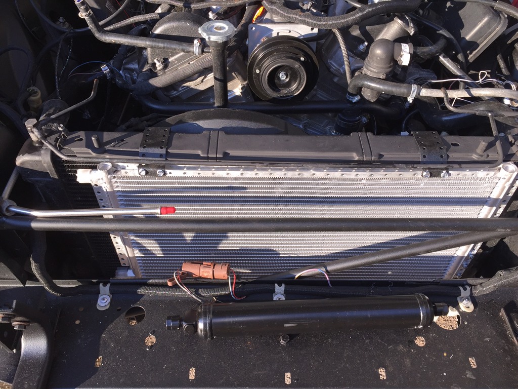

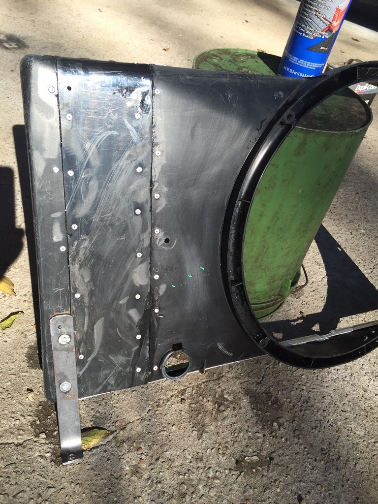

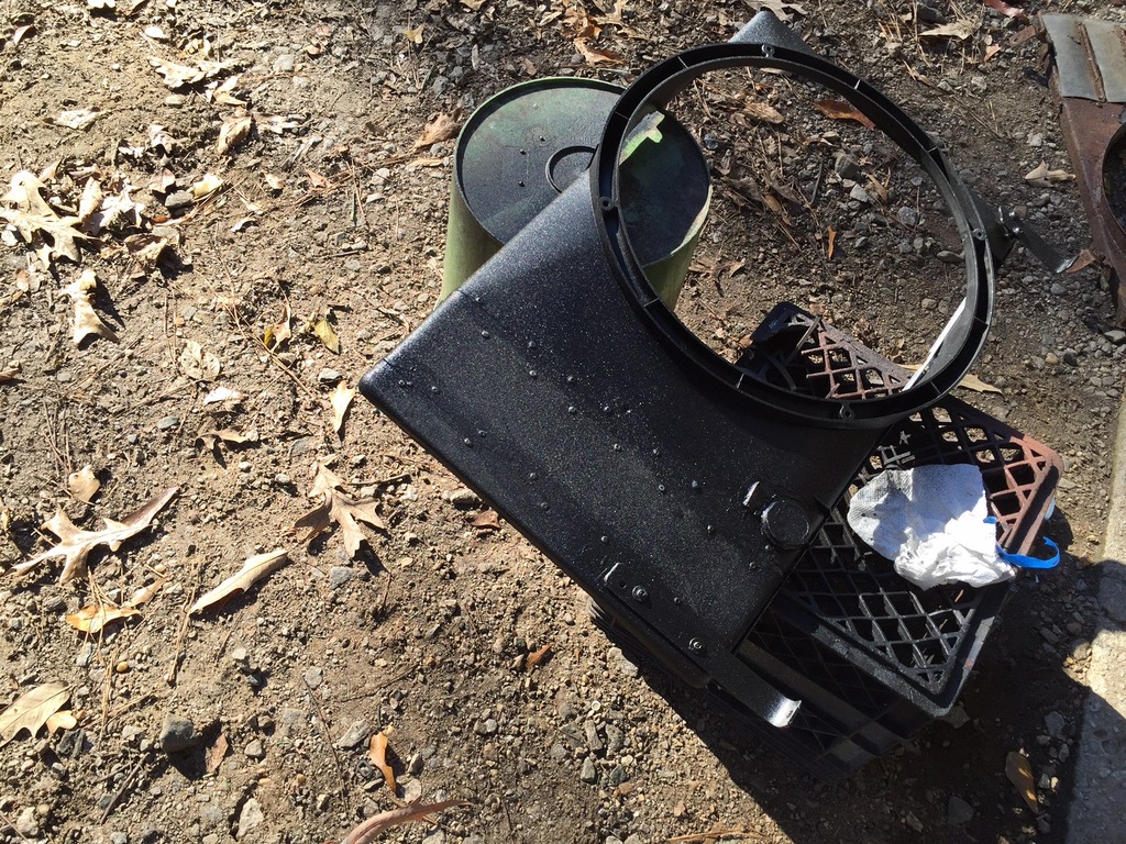

Default Electric fan and parallel flow condenser mods
I picked up an electric fan out of a 90's Volvo at the local junkyard. Various sources rate it from 3000 cfm to 4000 cfm. don't know the exact specs but the guys from various car forums love 'em!
I cut the shroud and added a section of plastic so that the factory Volvo shroud would cover the entire radiator. Used ABS plastic glue and rivets to modify and then sprayed it with Duplicolor truck bed coating.
I also shaved the depth of the shroud to make it fit-just barely clears the pulley on water pump.
Condenser is a universal parallel flow design made for the hot rod crowds.
