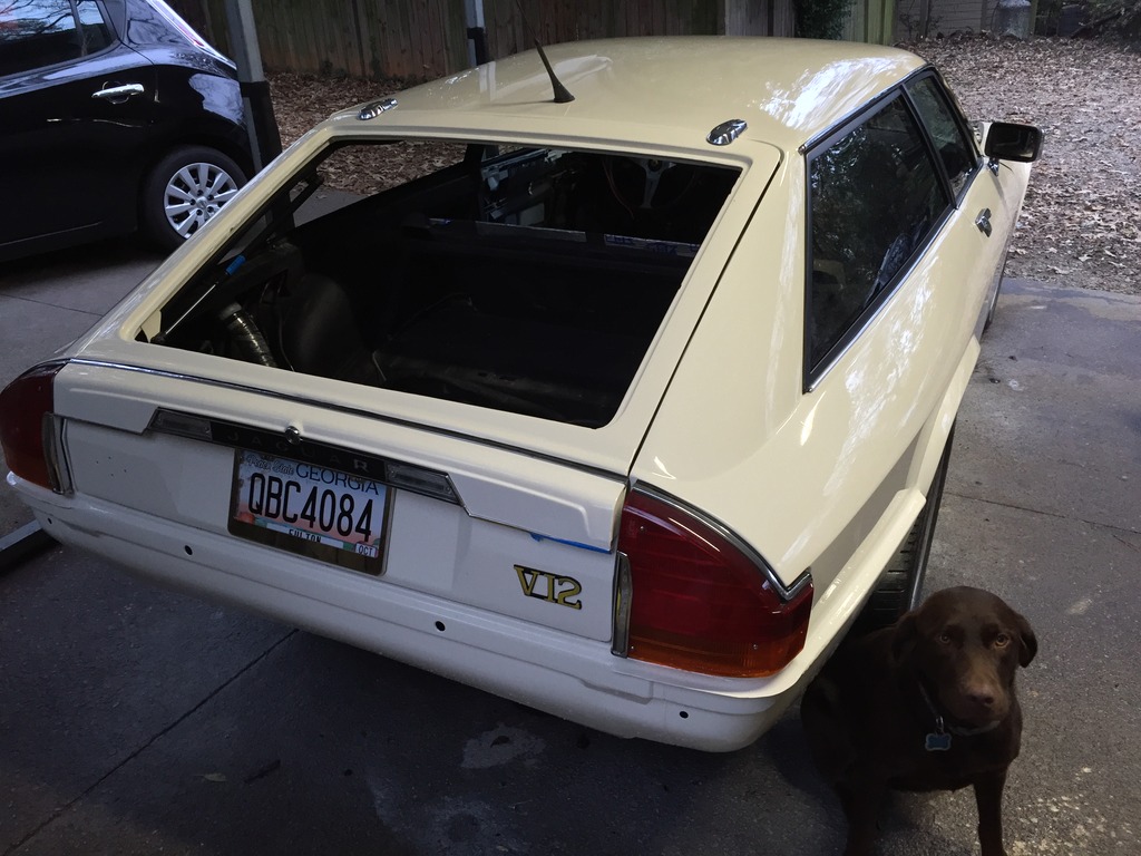

The side windows turned out just fine, they really look great.
Being Lexan, the waviness will settle down a bit more as they go through some heat cycles and settle into their surrounds.

They look great, Andy, and blend well into the frame giving a seamless look to the side of the car. Well done!
Looking forward to the final pics once trimmed and fitted.

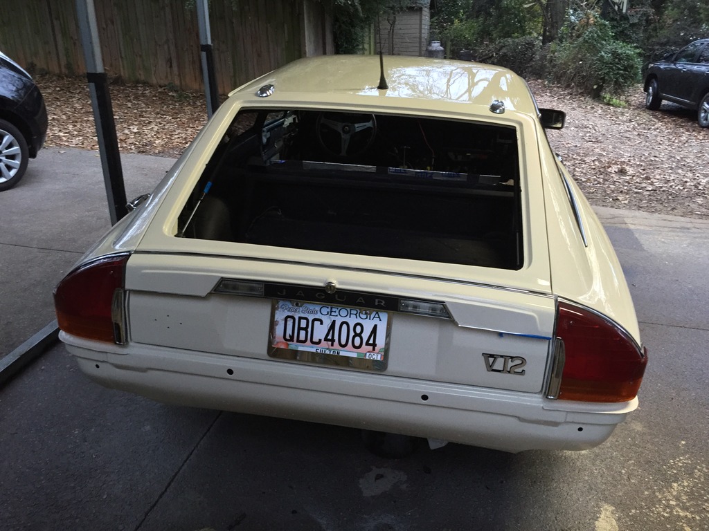

Size:  204.7 KBName:  IMG_2748.jpg

That is truly exceptional work Andy. I always enjoy seeing your progress.

Thanks! Some parts are turning out better than I could have hoped which makes it difficult to know when to stop trying for perfection.
More soon!!
