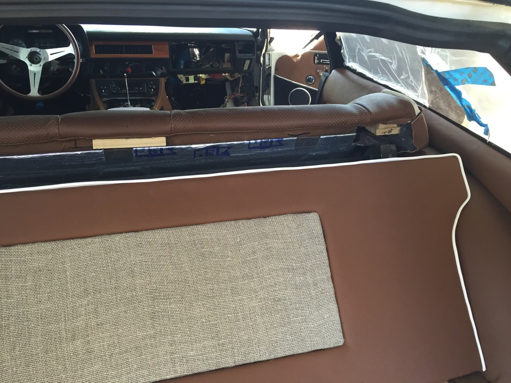

Rear hatch area complete!

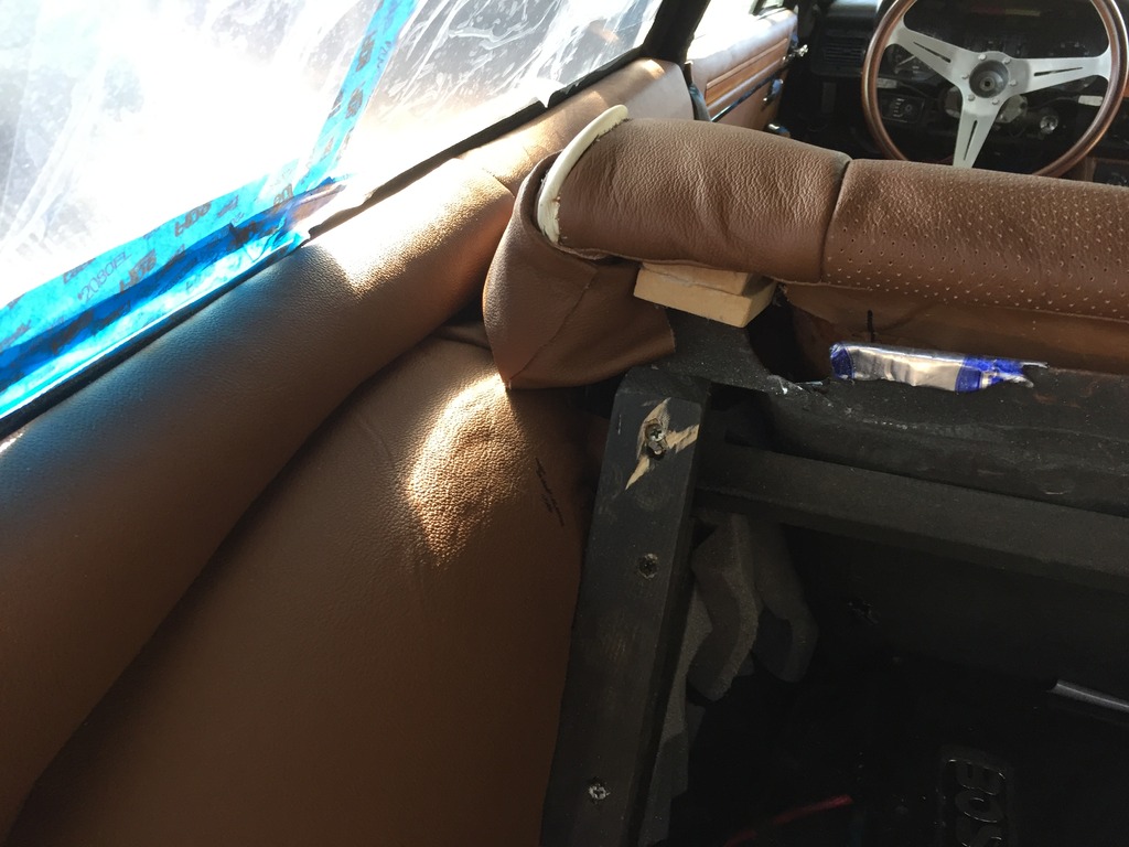

The intersection between the top of the rear seat and the angled panel with fabric center (mimicking a old stereo) was nearly as hard as welding in the 280Z hatch-I'm not joking. AND, dealing with the sides of the top of the back seat was difficult because they are hidden on a stock XJS but are visible through the side windows on the Shooting Brake. I hand sewed in leather pieces that cover pieces of foam-I'm not entirely pleased with result but will live with it. On my next Shooting Brake...
You can see pieces of wood at the top of the rear seat at the ends and in the middle. These are anchors to screw in the back faux speaker panel to anchor the top of the seat to the top of speaker panel. My initial engineering plan was a piece of metal on the speaker panel that "hooked" onto a bracket glued and riveted on the seat back but this didn't align the pieces well and ripped the bracket out of the seat back particle board material when I was adjusting it. Engineering from scratch is hard.
But final product is complete, I'd rate it as 6.5 out of 10. Name:  IMG_3424.jpg

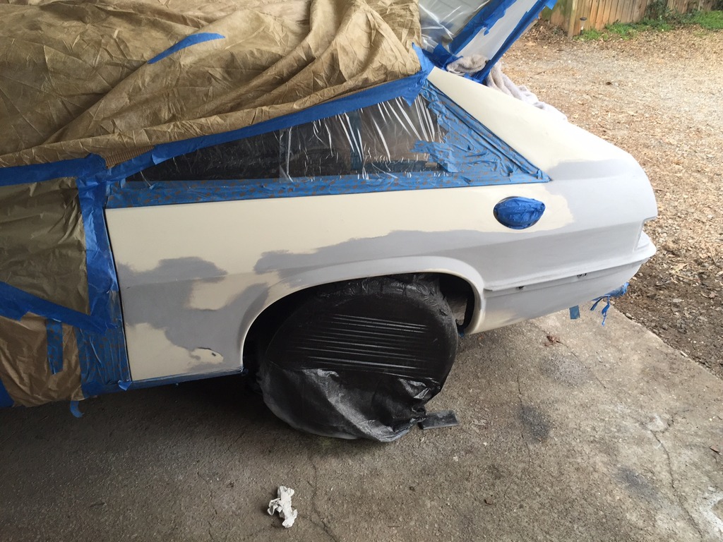

Adjustor came out Thursday and took photos, estimate should be in next week. I'm eager to see what estimate is.(I better make some money!!) in the meantime I became crazed with the idea of having to make the repairs and worked half day Thursday dismantling, and then all day Friday and today repairing. The quarter had some tiny creases in the front near the door and under the gas cap. I pulled the corner roughly into shape, cut out a section of the corner from my parts car, welded that in and then epoxy primer, some filler and hi build primer. Then sprayed it Saturday night. Still have to find bumper ends and a tail light.
