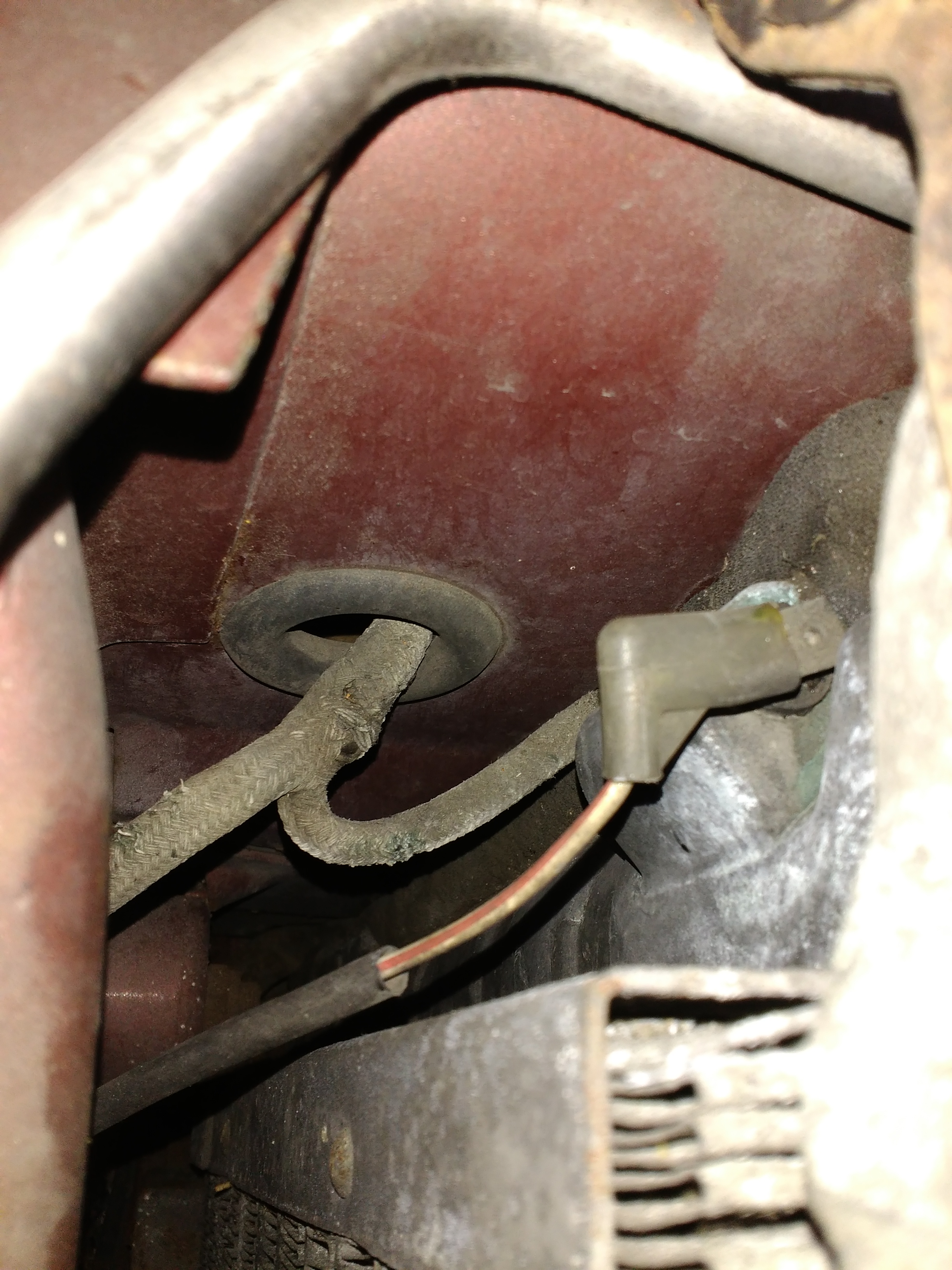

"COOLANT LEVEL SENSOR: On earlycars, it’s at the front right side of the radiator, where it’s very hard tofind unless you have the hood off. Sometime in the early 80’s, it was relocated to the header tank, whereit’s a lot easier to get to. If you havea car with the earlier sensor location, at a convenient opportunity you shouldrelocate the sensor to the header tank. Simply drill a hole in the header tank about 3” above the bottom and insertthe existing sensor with a new grommet, and find some way to seal the hole inthe radiator.

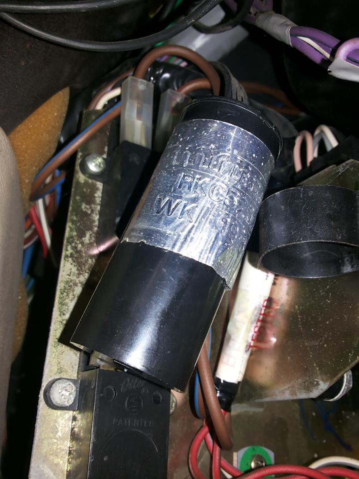

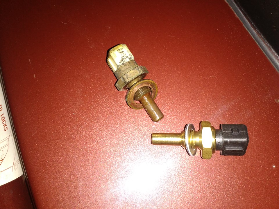

YESSSS, I resolve this problem. I changed temperature sensor and transistor in control unit (in a black cylinder - transistor CD4011).... but nothing. Now I finally found coolant level sensor - On earlycars, it’s at the front right side of the radiator (secret location). Little bit a contact spray and mystery is gone. Thanks to all for helping.
