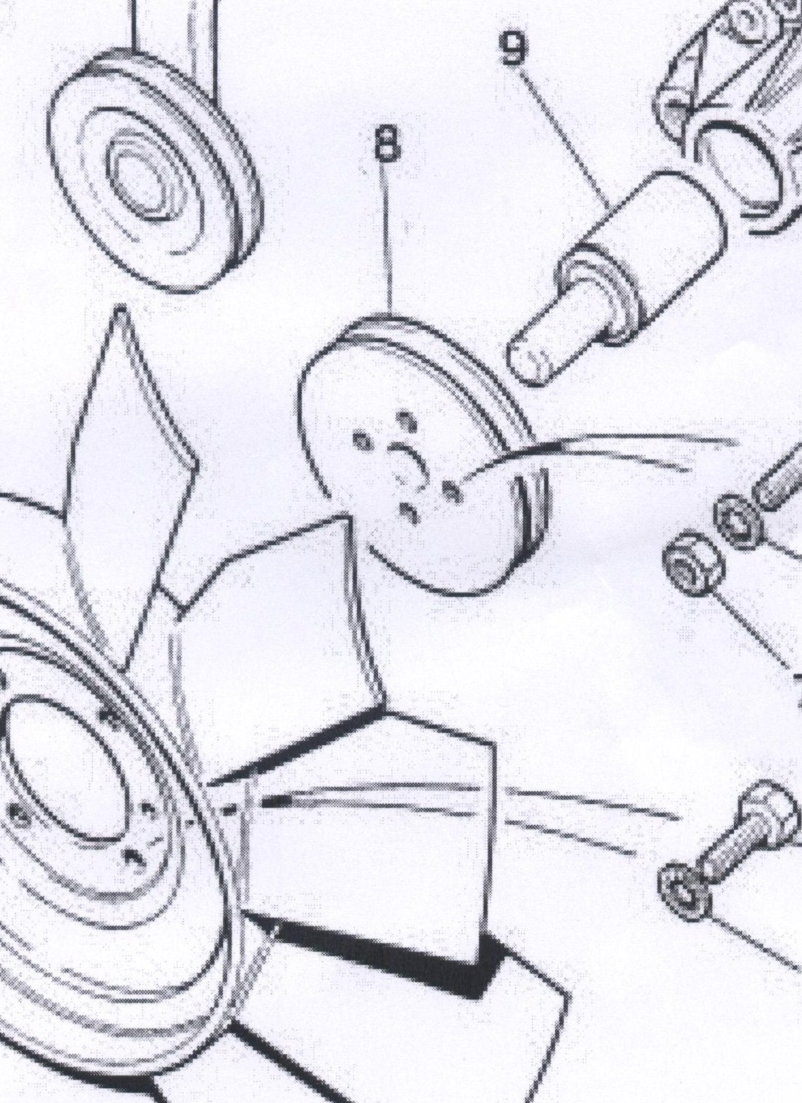

Default Bad Diagnosis of V12 Engine Noise
I,m ashamed to post this message. My previous posts miistakenly blamed the water pump for my engine whining noise. What a dummy! Found an old Jag mechanic who straightened me out....the noise is from the radiator fan/clutch shaft bearing. (See key # 9 in the attachment). Jag dealer said shaft and bearing no longer available. Does anybody know if the bearing can be pressed off of the shaft because I may be able to match it up at a large bearing house here in the city. If the bearing can't be pressed off, does anybody know where I can find a new shaft/bearing assembly?
Again thanks for your help.
Red Faced Bob (Spillwaybob)

Old Apr 3, 2014 | 09:40 PM
AllanG's Avatar
Posts: 1,147
Likes: 372
From: Hickory, NC
Bob,
Your post reminded me of one I'd seen a while back and I managed to dig it up. Hope it helps.
http://https://www.jaguarforum.co.uk...437-55248.html
Old Apr 4, 2014 | 09:13 AM
Scoupe89's Avatar
Joined: Oct 2010
Posts: 157
Likes: 20
From: Phoenix, AZ
Good save! Beats a WP by a mile. Fan /clutch is a huge power consumer. Now may be a good time for dual electric fans on full time.
Old Apr 4, 2014 | 04:47 PM
Spillwaybob's Avatar
Joined: Mar 2010
Posts: 112
Likes: 9
From: Metairie, LA
AllanG,
Very helpful post from the UK but now I have A few questions:
Does Jaguar part # EAC 3437 include the shaft or is the shaft a separate part pressed on to the bearing? The Canadian bearing he eventually found apparently came with the shaft which he had to shorten (with a hacksaw???)
I found a used one in England for $95. "Used" may be noisier than mine!
I will check with one of our large bearing houses here Monday and probably get a goiod laugh!. Will let you know. Thanks again, AllanG.
Bob (Spillwaybob)
