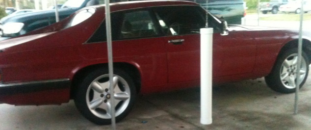

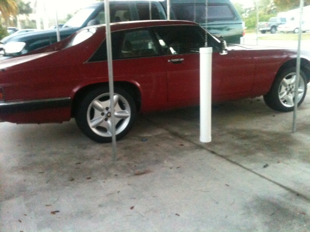

Here is my 1988 with XK8 wheels. Replacing radiator and tucking bumper so it looks like too much gap in front wheel. The wheels fit perfectly with only a 4mm spacer up front so the center can be used.
